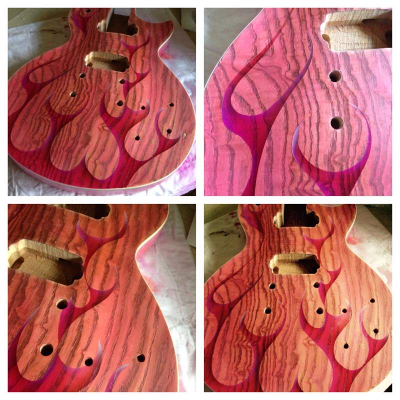

    Ah I see! I've just checked out your Facebook page, looks good how you've taped up the flames. Also the pink dye on front looks great (I know you initially had some trouble sourcing something for this)

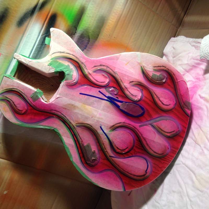

    Anyway, here are some pictures of today's progress. Flames came out pretty kick-ass if you ask me (but I am biased of course). Just a bit darker than I had in mind. That's a waterbase magenta candy from AutoAir I used here. Underneath that some rootbeer and amber (also candies) and some transparent white in a transparent base to lighten it, then over reduced.

    What's going on with the flames there? Am I blind or did you scoop a bit of wood out to make them look 3D?
    Looks great.
    Looks great.
    Thanks! No wood was harmed in the making of these flames. The 3D look (much more subtle after the tape is removed) is the result of using shading inside the flames. Fairly easy trick, really.
