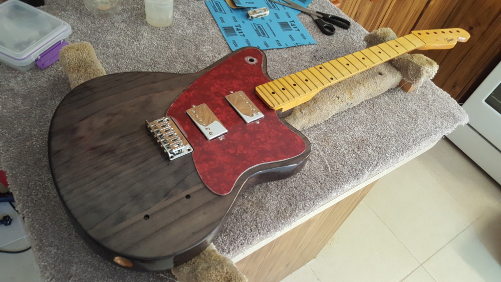

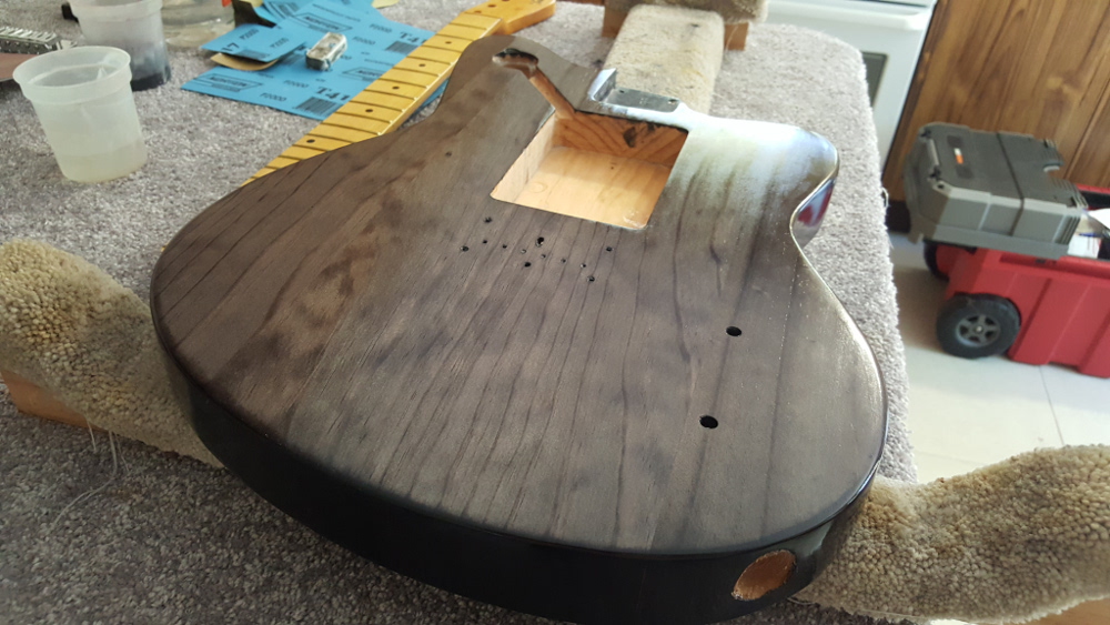

    Hey guys,
    As I noted above, I have finally got around to resurrecting this build after a classic Turner clear coat fail. I couldn't rightly abandon my first (and only!) scratch body build, now could I?
    I sanded back the body completely, added a new coat of black dye and got the Tru-Oil going. This is now going to be a Tru-Oil-only build and I think that's the way most of my builds are going to stay from now on (unless I get Pollocking again ). Things are looking good already. I didnt apply the dye as darkly this time around, opting for more of a trans-black look. The pine is looking a little blotchy with less dye in it, but that's to be expected for this wood type - I'm not that fussy. Any variation in the finish is good AFAIC. I'm not even sure whether I'll bother getting the body to a full gloss of not. I'll just keep applying layers of TO until I'm happy.
    I gotta say, I forgot how much I love this body shape. I think after this one is done I'll get on to another, although I'll have to start from scratch again as my template is ruined.

    Thanks Tony and Andrew! Yeah Andrew I keep coming back to the TO. It's easy, it's forgiving, and the finish looks good. What more do you want?
