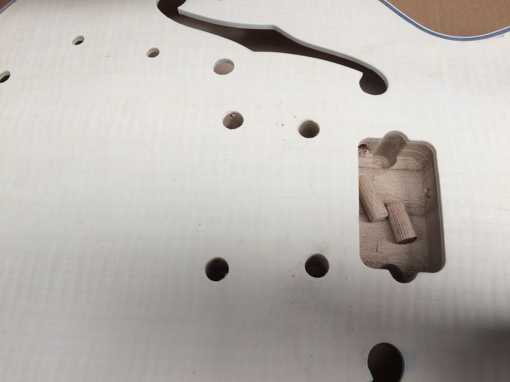

    I have devised a way of repairing and re drilling the bridge holes that are misplaced. The down side is that the finish will now have to be a solid colour to hide the repair. Gibson seem to get away with painting theirs, so (whilst there is no comparison in skills)I will paint mine.

    Well kids, necro update time, this build is back on...
    Other projects and the thought of re drilling bridge holes shelved this one.
    I have done and learnt a lot since then, and I m back into it.

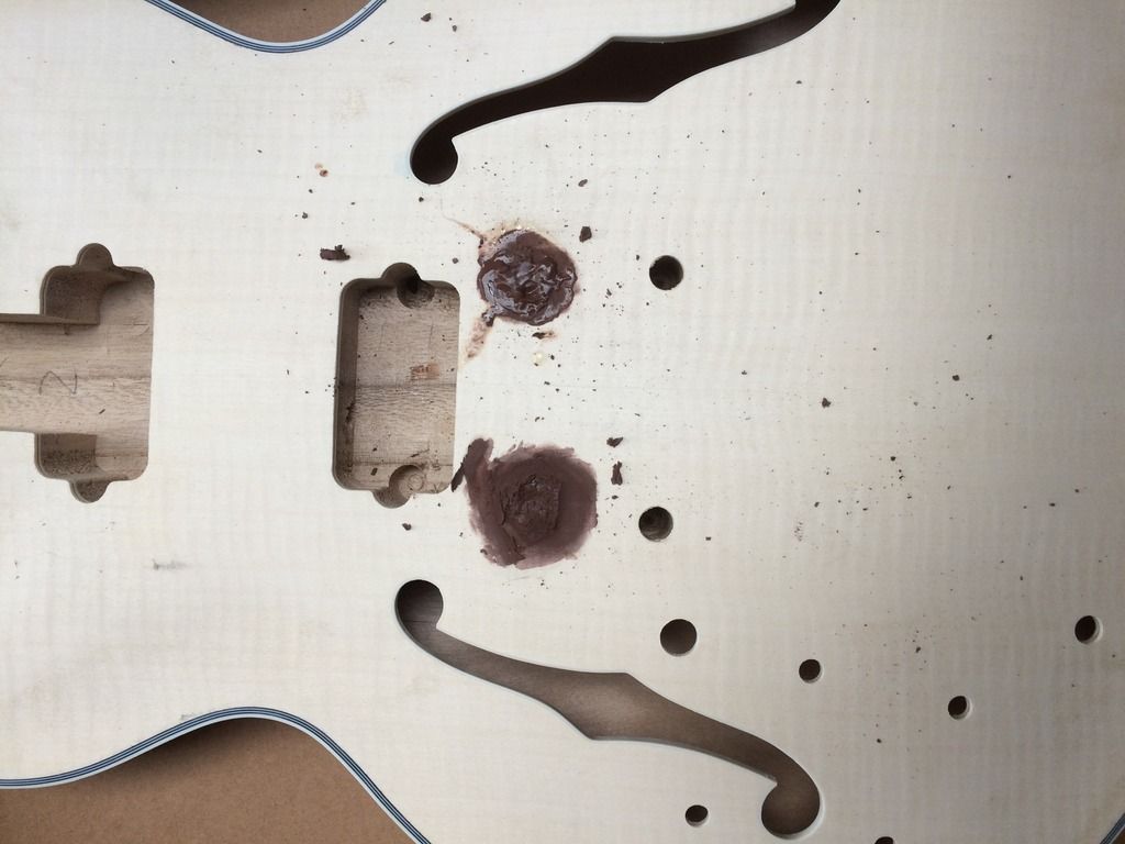

    Holes dowel plugged and timber mate filler

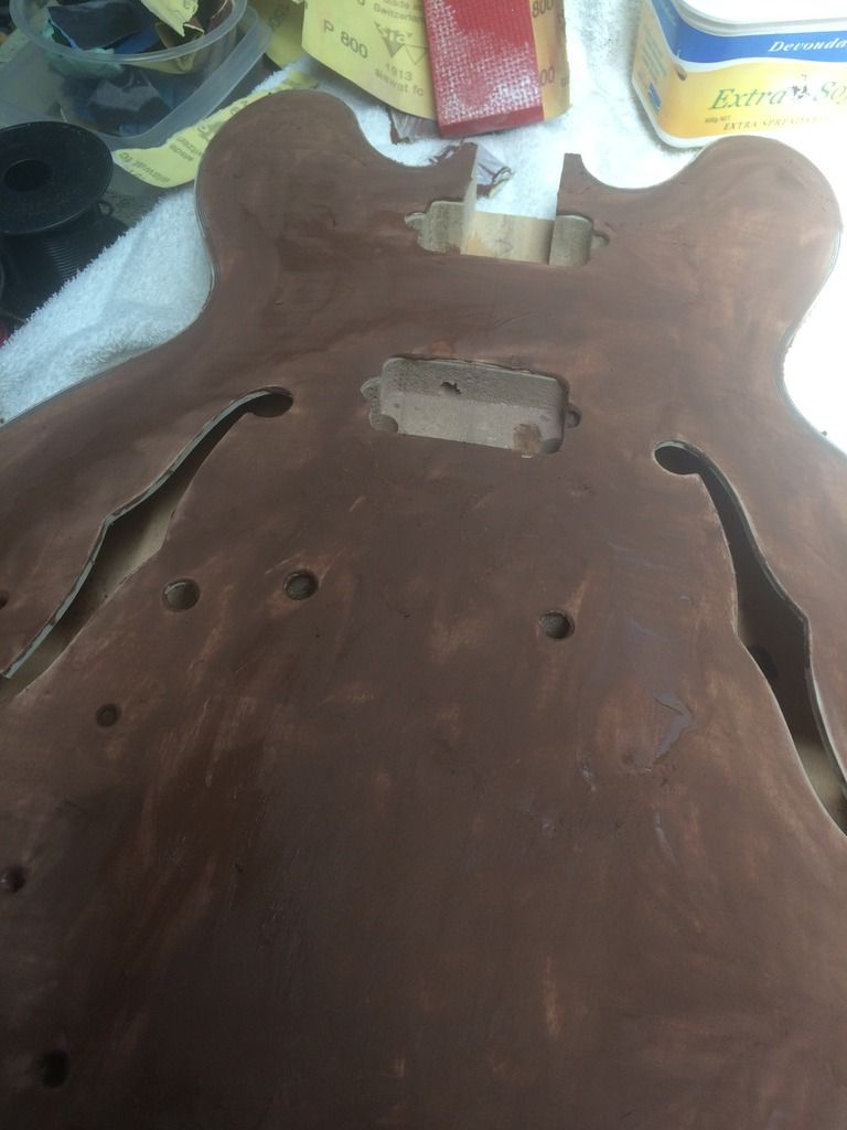

    Walnut Timbermate slurry, a bit thick but it fills grain....
  5. #35

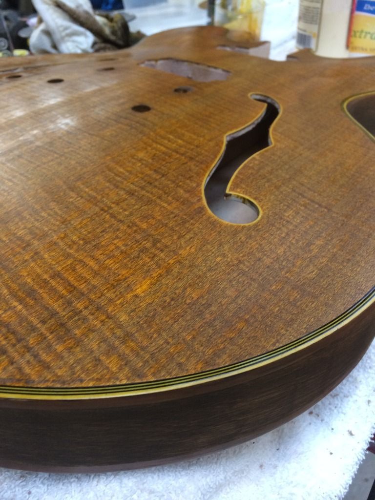

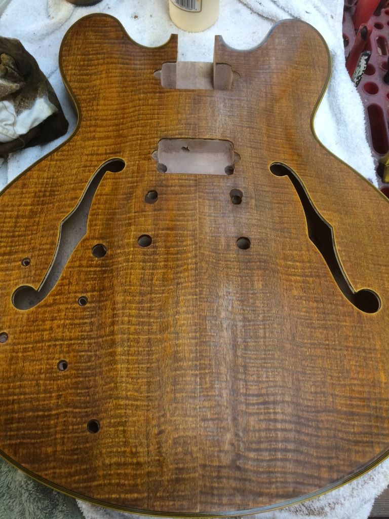

    Sanded to 400 grit all over, Feast Watson stain, Teak for back and sides and a Golden Teak and Teak mix for the top:

    nice antique look happnin there Stan, will look killer with gold fittings

    Nice colour Stan, nice repair as well

    Nice work Stan this will look unreal. Must be good to get this project back on track

    Hell yeah, Stan! This looks great. What's the plan for clear?
  11. #40
    Thanks guys happy to have this going again . This time it's getting nitro for clear, no more acrylic for me
