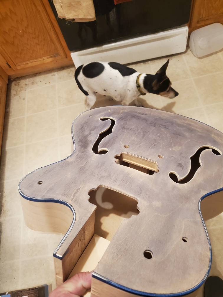

  7. #37
    Jul 2020
    Twin Lakes, WI USA
    149
    Darkened the grain with some very mildly mixed black keda dye. Makes basswood look a bit nicer IMO. Sanding it back a bit in the morning. Still deciding on a color for this one. Maybe a nice transparent blue. Don't forget the pooch! Click image for larger version.

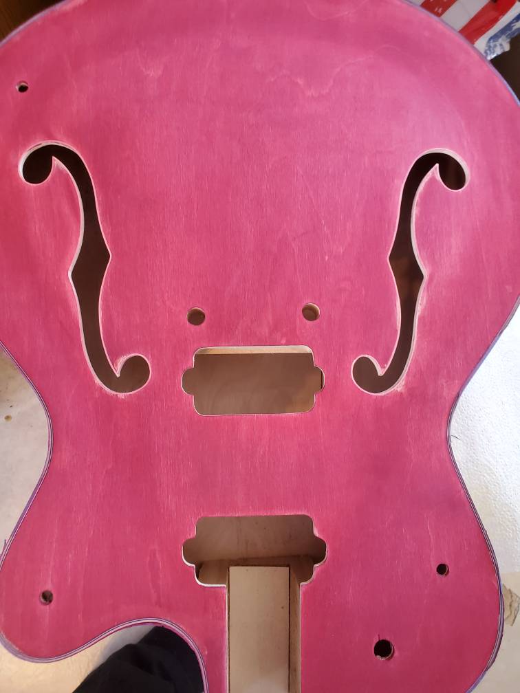

  9. #39
    Jul 2020
    Twin Lakes, WI USA
    149
    The pic looks a bit brown. It is very red, with a slight bit of blue in it to tint it towards crimson. Almost a blood red. To bad the camera doesn't pick up the true color.

  10. #40
    Jul 2020
    Twin Lakes, WI USA
    149
    Uh-oh! It dried to pink! Not regular pink, but HOT pink! Click image for larger version.
