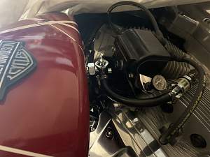

    Quote Originally Posted by m0j0 View Post
    Is one of those bits a 1971 quarter to use as a thumb rest for your accelerator hand?
    No, but I do have a 71 quarter on the choke knob on my VH cafe racer 😁

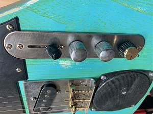

    Mentor Andyxlh's Avatar
    1,206
    If I decided to relic the hardware like I did on the Tele with the built in amp, cutting the finish wouldn’t matter. I do like this earthy look, almost a zinc plate finish with the copper peeking through

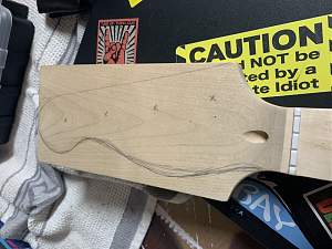

    Scribbling on a lefty headstock shape. This is kinda the sort of thing I have in mind
