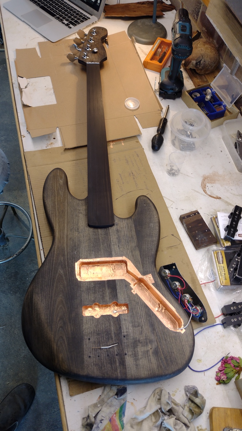

    Had a good session this afternoon.
    I've recorded some audio with PBG stock pickups.
    Took the entire bass apart, removed the old plastic dots in the fretted position, filled with timber filler.
    Did a small test of Tru Oil under the pickguard and under one of the machine heads.
    Added copper tape near the control plate screws.
    Desoldered the stock pickups and started to install Tonerider pickups, and discovered that they don't fit!!! They are slightly larger than the stock pickups provided by PBG.
    After an interesting moment, and quite few words out loud in ancient Italian, I realized that it wasn't too bad.
    Took some measurements, used a pencil to mark the excess, and used a Dremel to gently sand the bridge pickup slot, and the pickguard, they both came out very well!!!

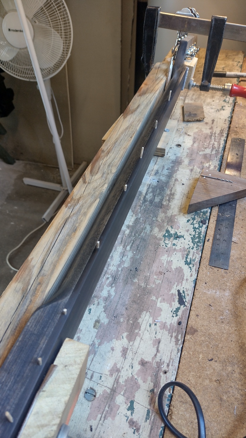

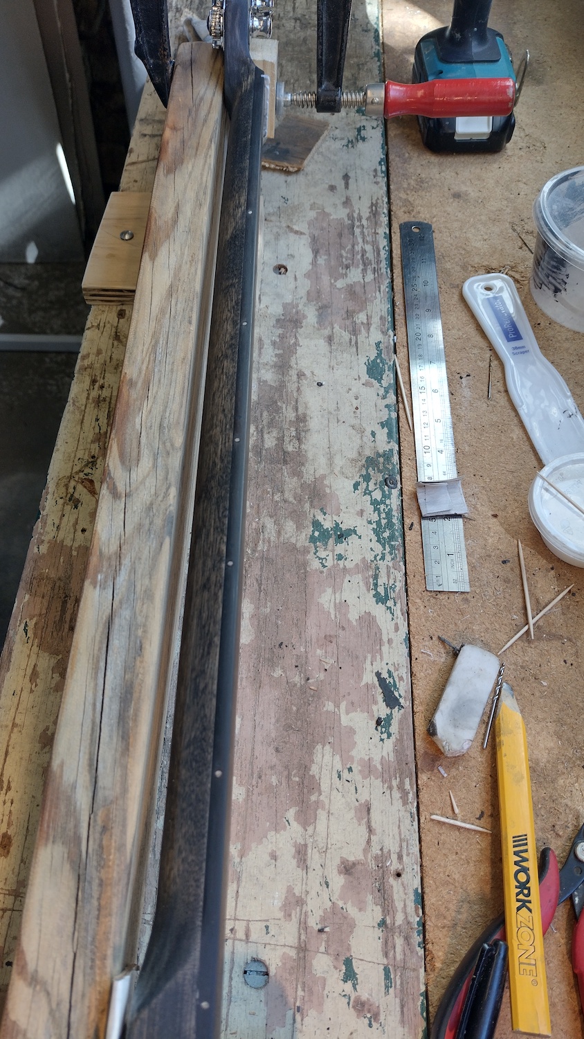

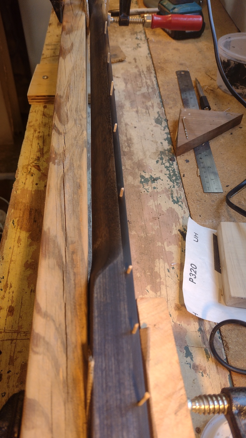

    Here some photos from yesterday's session.
    These are the old side plastic dots drilled out and filled with timber filler, new holes drilled (with toothpicks to keep dirt and whatnot away).
Name:	01_2021-09-16 10.32.32.jpg

Name:	02_2021-09-16 10.30.04.jpg

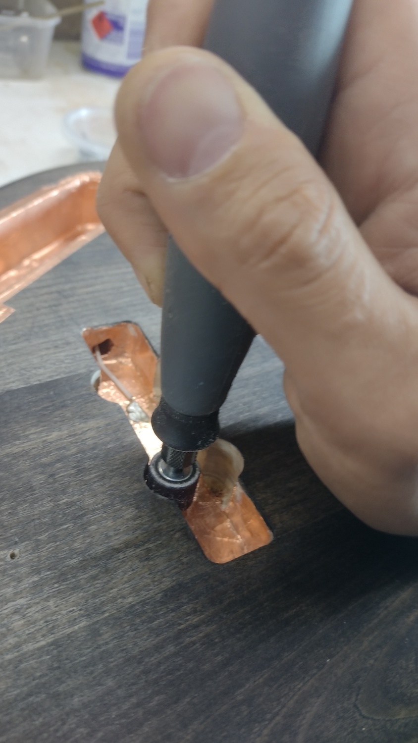

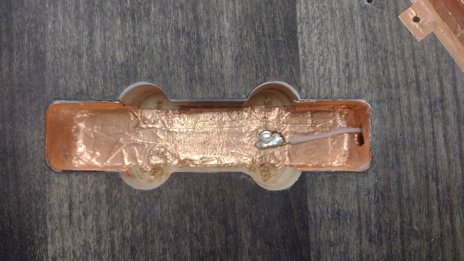

    This is the Dremel sanding the neck pickup slot to make room for the Tonerider upgrade. In fact the stock PBG pick up and the Tonerider are almost identical in width, I didn't have to make the slot larger, but the curved section of the plastic cover sits slightly wider in the Tonerider.
Name:	03_2021-09-16 10.31.03.jpg
    New slot after Dremel. Notice that I had to cut the copper tape neatly with a knife on the curved section before using the Dremel, and I had to fill the screws holes in the timber where the stock pickups used to be because the Tonerider are sitting slightly wider.

    I did the same at the pickguard for the neck pickup, using a much lower Dremel speed. No photos but you get the idea.

    Good session today.

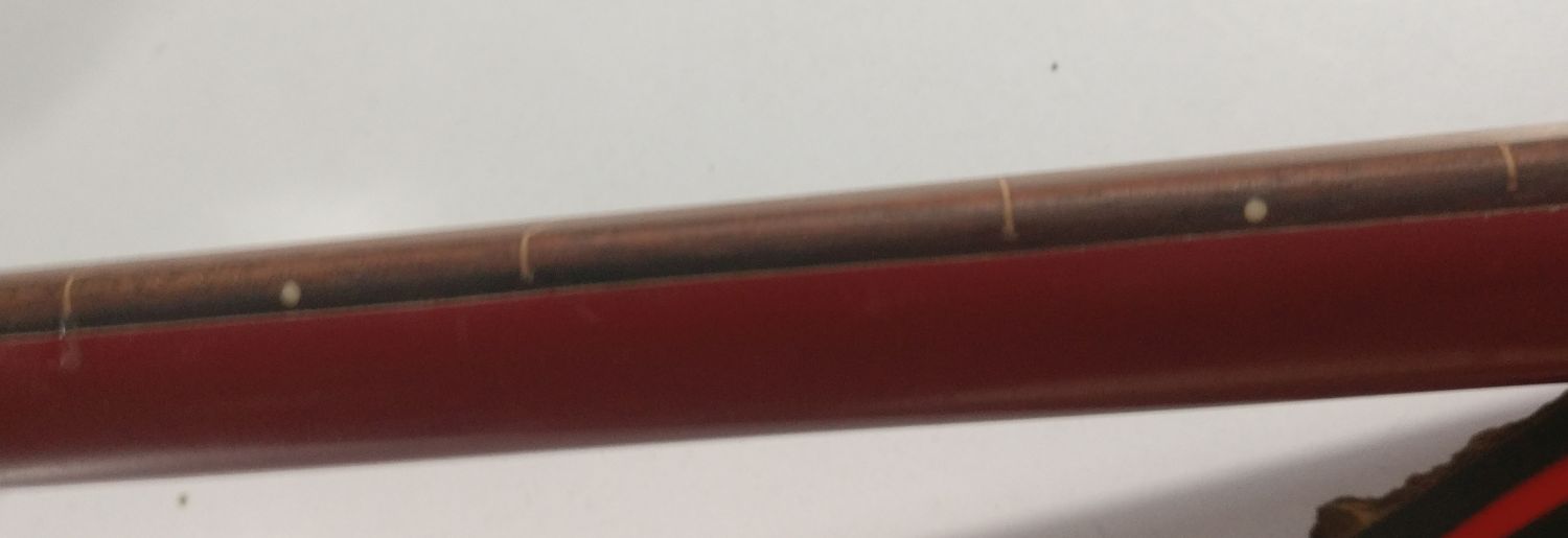

    Bamboo side dots are in place, I am happy with the mild contrast and it felt good to add timber to timber.... will swap the plastic nut at some stage for sure.
Name:	01_2021-09-17 13.40.57.jpg
    This is a detail of one of the bamboo dots
Name:	02_bamboo dots detail.png
    Neck refitted, pick ups aligned, drilled and soldered... tomorrow tune test!

    Hah! You went with the bamboo! Glad it worked out for you.
    That was just spontaneous thought that popped into my head when I was typing that post. Cool!
    Aug 2021
    Blue Mountains NSW
    142
    Thank you Simon, as you can see in the photos I have implemented a lot of the suggestions you made. Among other things I've added the copper tape where the control plate screws are, and the lemon oil on the fretboard is incredible, I didn't realised how much difference it made even after applying it once.
    And yes McCreed, I took your bamboo suggestion seriously! I have used normal tooth picks for the side dots. They look great!!
    Time will tell how they'll last, if they discolour etc... in which case it will be easy to drill out and replace with something else. For now they look great!!

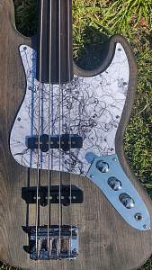

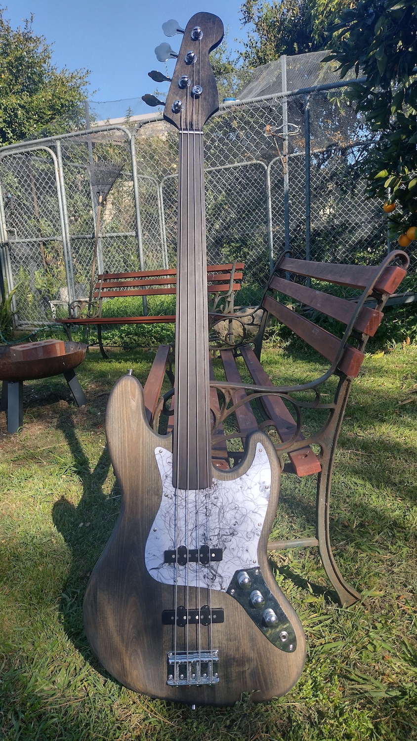

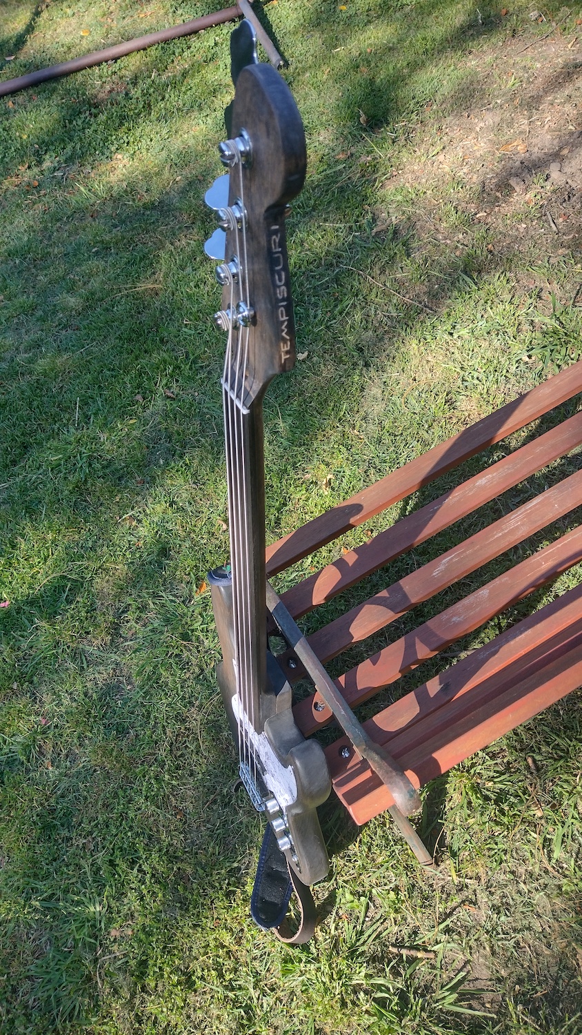

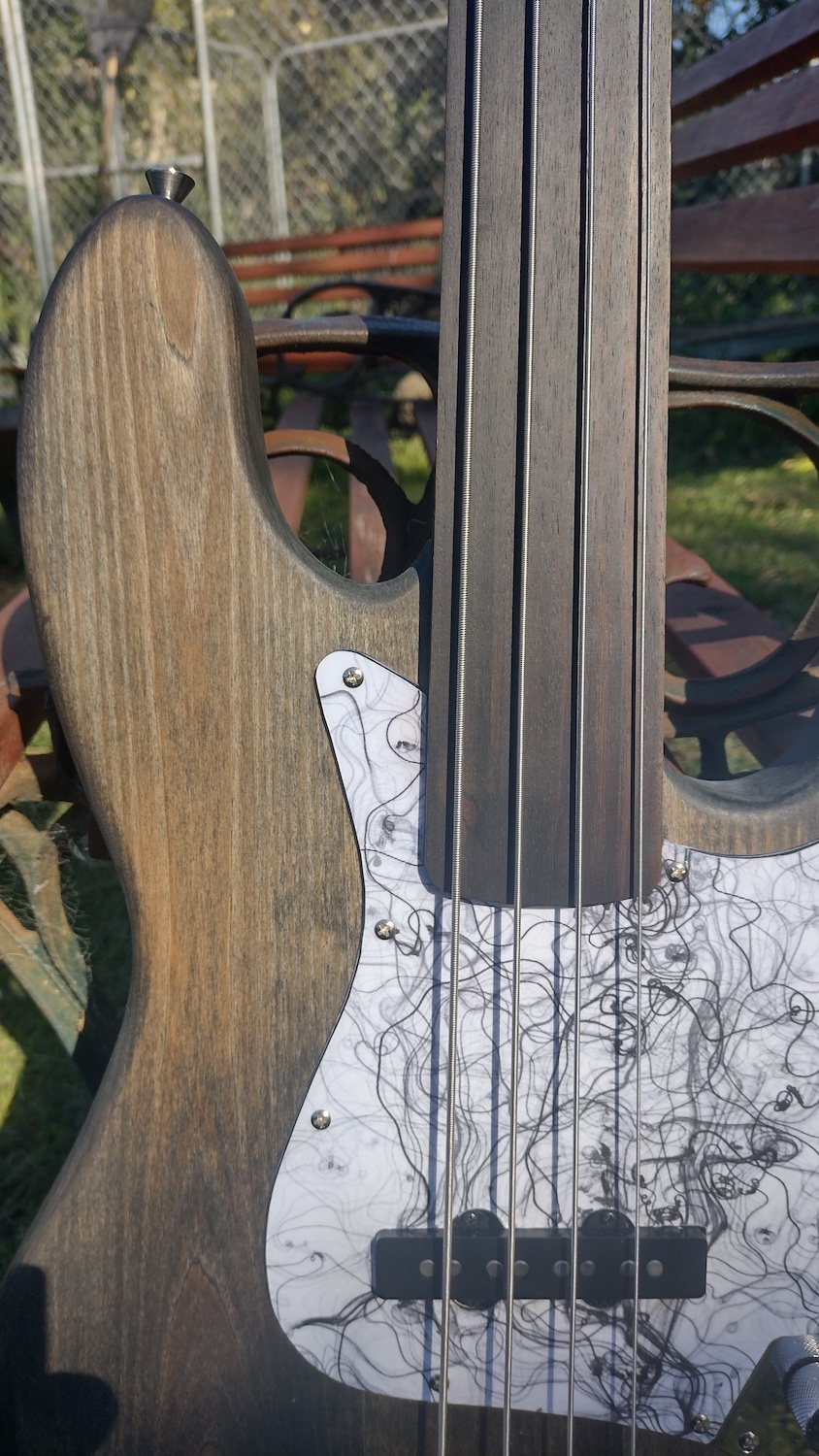

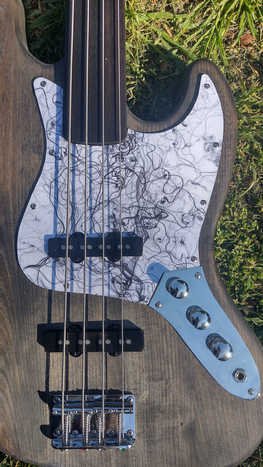

    There are few more little details here and there to look after but otherwise the bass is finished and ready to be played.
    Tuned and set up #1 today, will do another one in a week or two.
    It plays wonderfully!! I am very happy with how the back of the neck feels.
    The Tonerider pickups certainly add a lot of depth.
    Anyway, here it is!
Name:	FINISHED 1 2021-09-19 11.58.11.jpg
Name:	01_2021-09-19 14.52.14.jpg
Name:	02_2021-09-19 14.49.18.jpg
Name:	03_2021-09-19 14.57.23.jpg
Name:	04_2021-09-19 14.48.43.jpg
    and here I have recorded few clips. https://youtu.be/o5DEjiH07os
    I'd suggest to listen with headphones.
    The recording came out a little quiet, I was keen to play and didn't want to spend too much time on the mic placements etc... Maybe I'll try to record few more clips later on in the week.
    For whoever might be interested, both pickups set at full, tone almost all the way fully counterclockwise (brand new strings I guess), no EQ or post, just a little bit of reverb, otherwise straight recording from DI, and a XY mic in front of the bass speakers (15" and tweeter).
    At the moment everything stock from PBG kit, except custom printed pick guard, Daddario XL round strings, and Tonerider pickups.
    This thing is a lot of fun to play!
