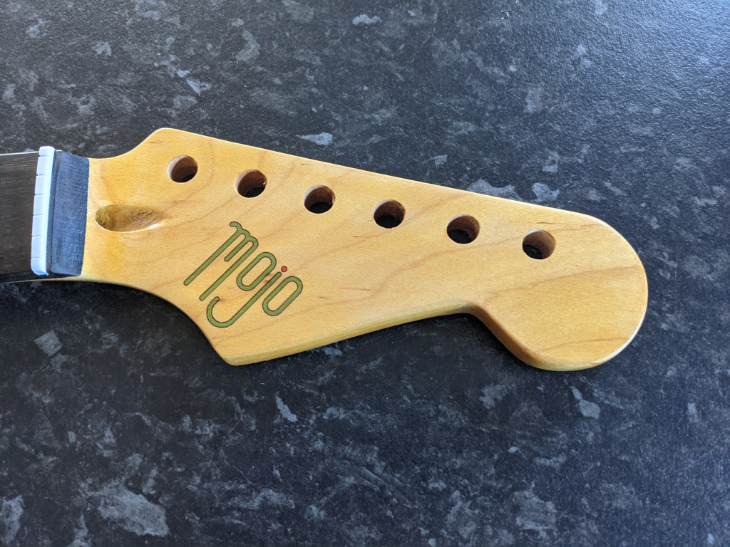

    Finally got around to designing a headstock logo and printing my own waterslide. Not sure if I'm happy with it so I'm going to just let it sit like that and keep looking at it to decide if it grows on me or if I want to remove it and try again.

    It’s a yes from me!!!
    I really like the logo but you may want to move it as your B/E string tree will sit right in the middle of the M. Unless you have staggered height string posts and the nut to headstock face distance is sufficient to get a good break angle on the nut. On my GST-1, even with staggered posts, the break angle wasn’t great and the two upper open strings sounded weak without a string tree.
    Yep, I thought of the string tree a couple of hours after I "permanently" applied the decal. That said, I'm going to see what options I can find to get away with it. Worse case, the tree will partially obscure the logo - worse things have happened.
    Mentor Andyxlh's Avatar
    1,206
    If you get the string tree low enough it looks like it will work. It looks good.

    I would also consider the position. Maybe just a tad smaller and run parallel to long bottom edge.
