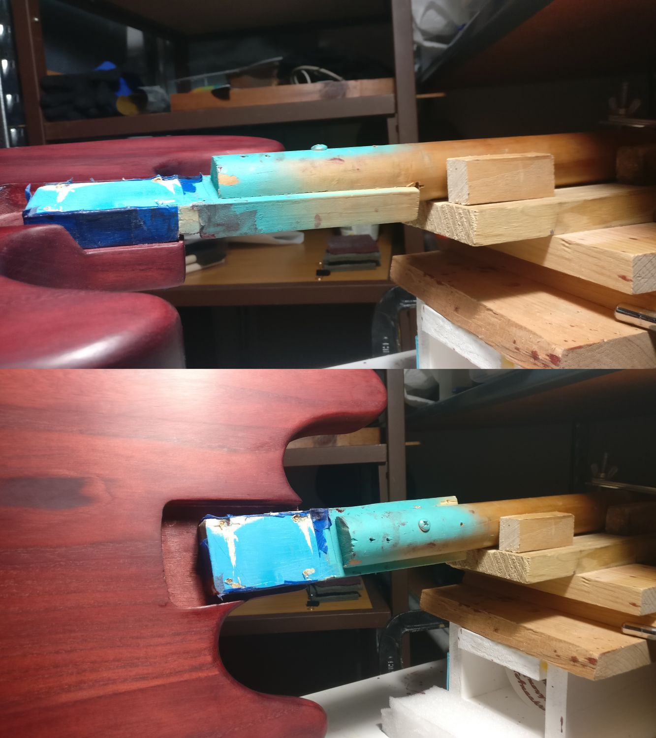

    I used some old closet pole rather than metal for mine. It had the advantage of being easy cut a flat side.

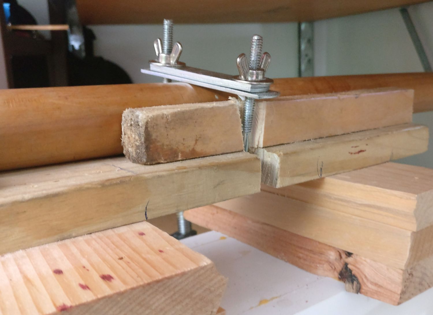

    The pole is held in its channel by a U-bolt. The wingnuts make it easy to tighten or loosen in order to hold it in place or allow it to turn.

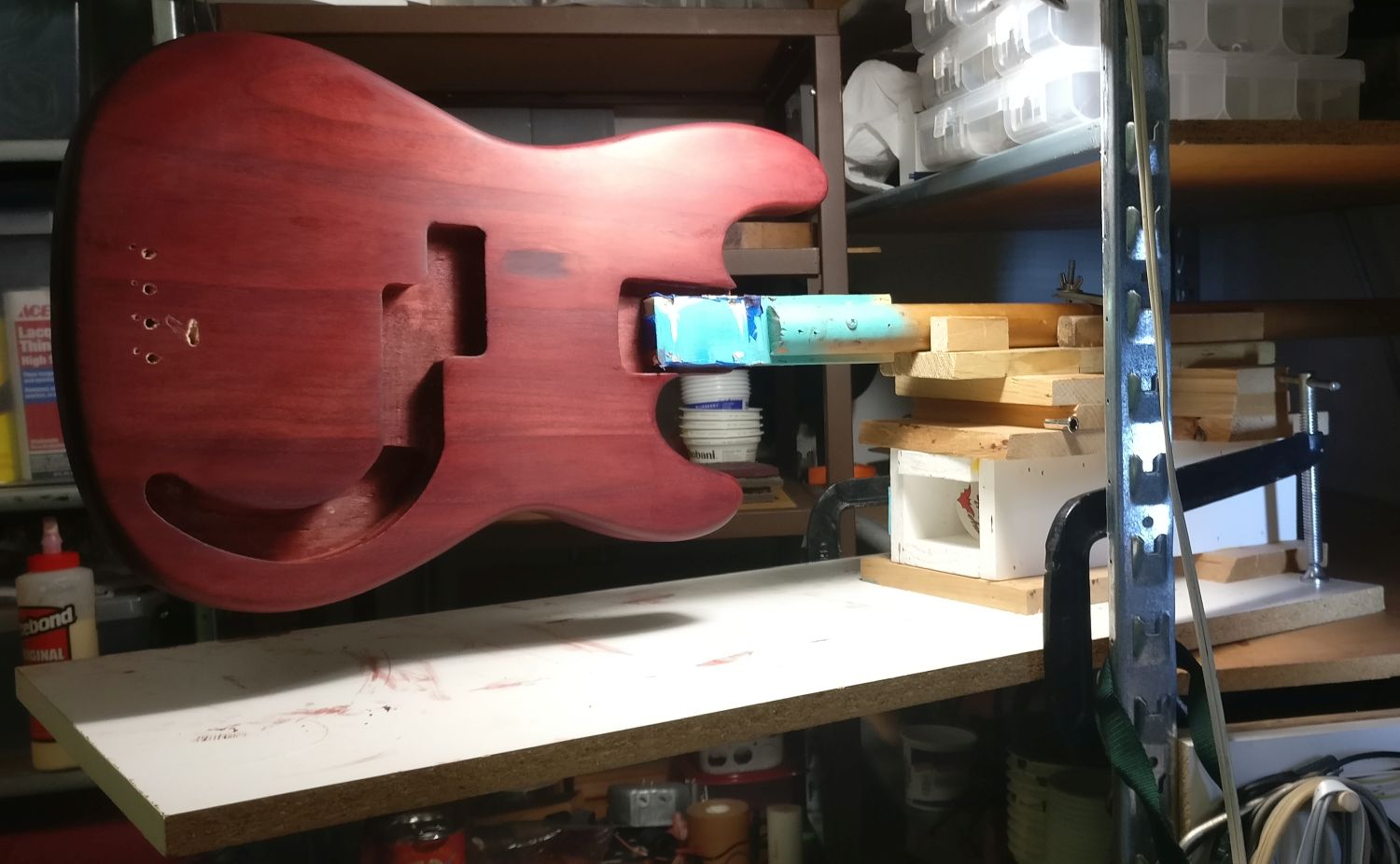

    I attached the base to a piece of old shelving to make it free standing and easy to move without removing the body from the jig. This way I can clamp it to a table (or a shelf, as in the pic) to work on, and then store it on a shelf in my garage for drying, curing, or just staying out of the way while I do something else.
    It's not nearly as pretty as a McCreed or a Barden jig, but it occurred to me that it was easy to make and might fit in your tent ;-)
