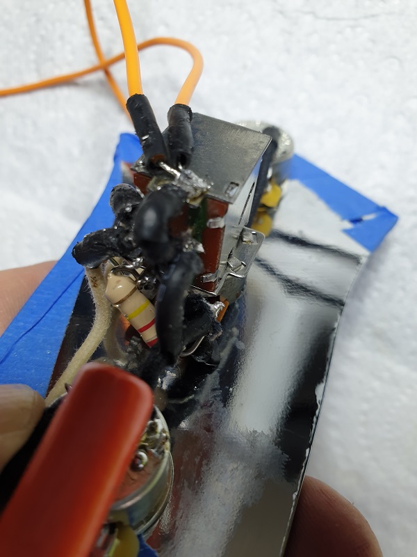

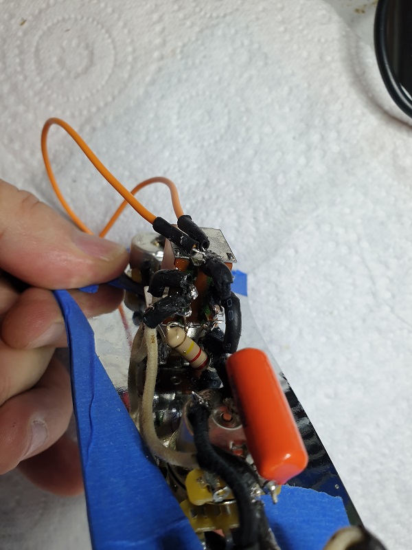

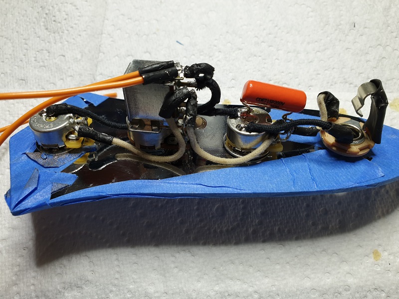

    Wiring is done....well less the pickups.
    Inset mad laugh.....ha ha ha .......I think it is alive.
    This was tricky...thanks weirdy...I enjoyed the challenge.
    We have two orange plastic covered earth wires hanging loose on top. One for the pickup cavity and one for the bridge.
    The resistor was easy...but wow you popped in some multi wire joints in that push pull pot. I did cheat a little and use some capacitor leads to make a little jumper style connection.
    Let us see if I got all the connections when I plug it in....no no no...no looking...no multi-meter.
    EDIT:- Note to all....anybody fitting push pull pots, or as in my Tele with a Bigsby build, a non box style three position lever switch....the depth of the control cavity is not enough. I am going to have to dremel a little out of the bottom to allow both to fit.
