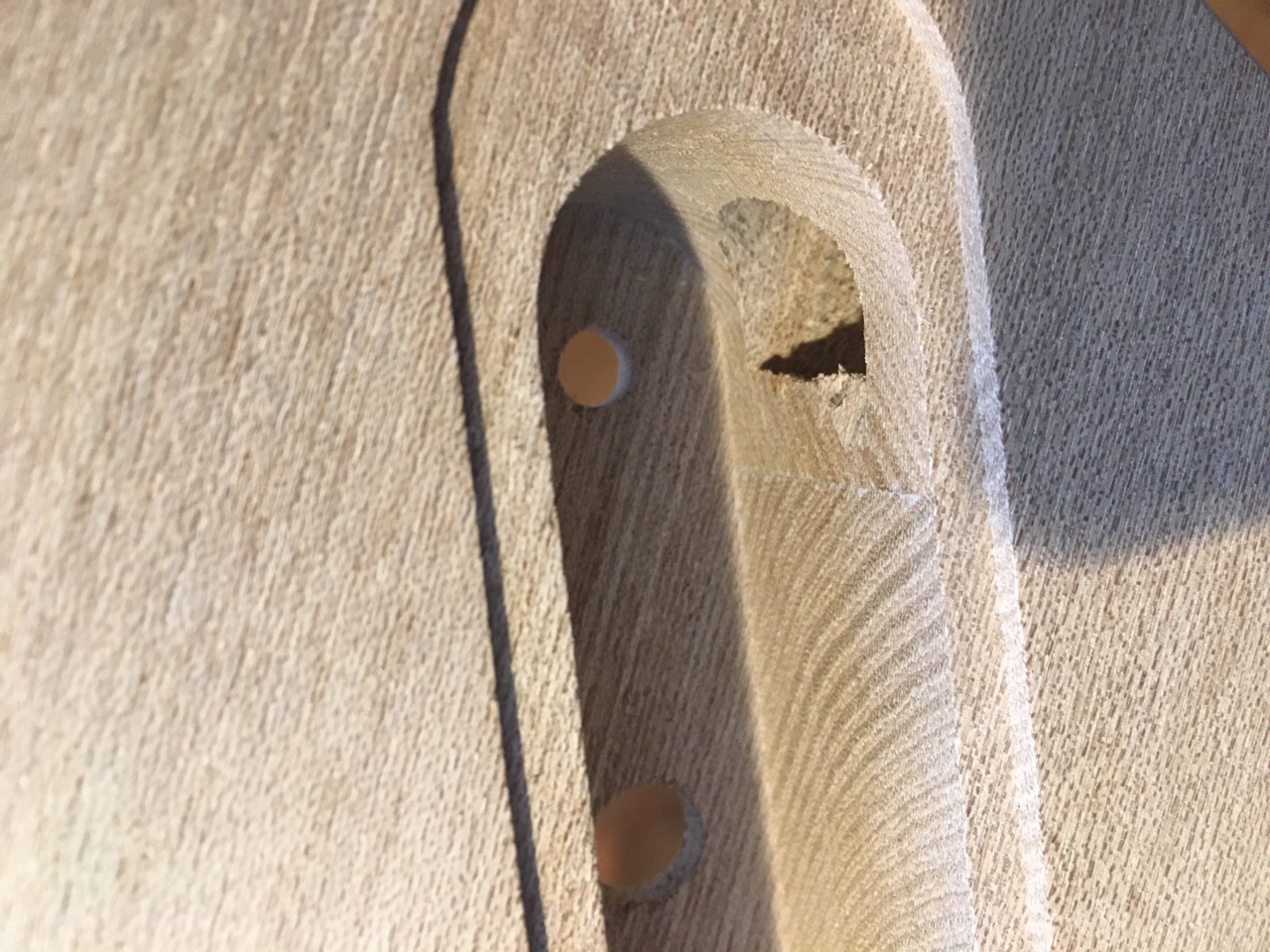

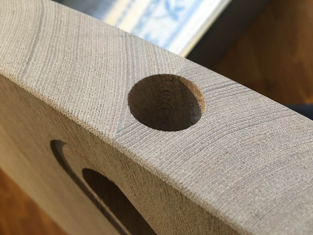

    Jack hole detailed today, here are before and after pictures.
    Before:
    After:
