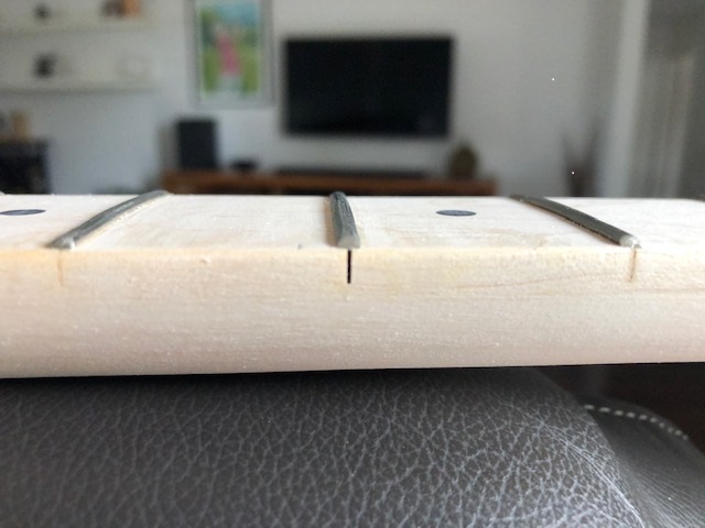

    Once I've sanded the neck and fretboard, I have discovered that a slot where the fret was inserted is open.
    Should I use wood filler here?
    It is obviously a very small opening
    There is also an even smaller slit where the fretboard joins the neck further down
  6. #36
    I use Timbermate for fret slot ends. (the "natural" colour for maple)

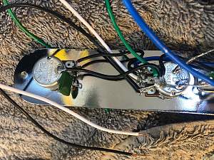

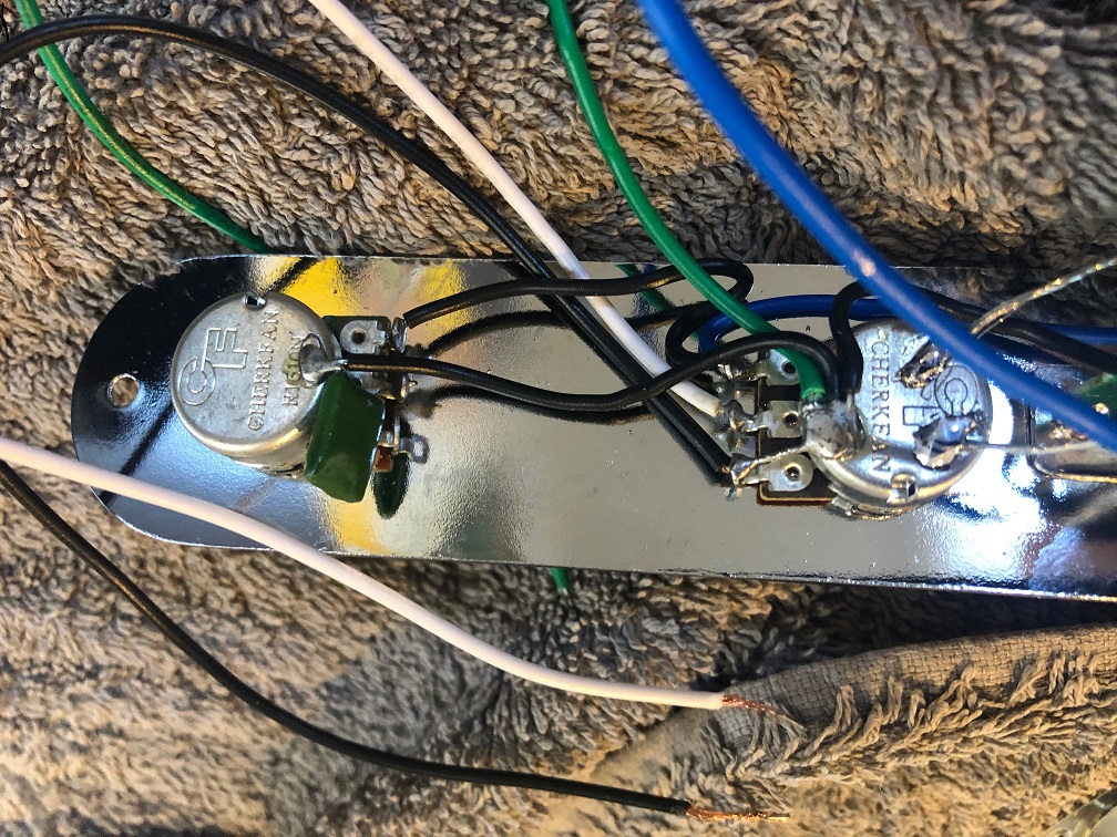

    TL wiring issue HELP
    It's been months since I worked on the kit but I finally got back to it today
    Watched the PB wiring video, but it is still not clear when wiring the jack
    I've got two wires, a black one coming from the first post &back of pot and a white wire coming from the centre post.
    According to the PB video there should be a wire with a split and this goes to jack (hot and ground) the second wire is suppose to be a ground to the back of the bridge.
    My eyes are crap but I can't identify either wire as having a split (ground and hot)
    I suspect the black wire is the jack wire??
    Help please

  10. #40
    White = hot (jack +)
    Black = ground (jack -)
    Green = ground to bridge plate (from what I can see)
