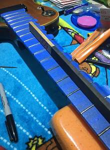

    While I have nothing else to do, I decided to file and polish the frets. I was hesitant and had been putting it off for a while, but once I started, I realised it was easier than I had thought and really enjoyed it. The night was productive and here are the results:
    1. Taped up the fretboard and used Sharpie to mark the frets. Am loving the blue tape!

    2. Used 600 grit sandpaper to find high points. Mostly good, with a few spots easily sanded down.

    3. Used my needle file (triangle) in a twisting motion to crown the flat tops. Got the knack of it quickly. Didn't push too hard, and could tell which parts needed work as the file tended to bite into them.

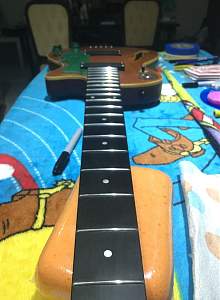

    4. Polished with 800, 1000, 1200, 2500 sandpaper, then brought out the polishing papers which go up to 8000 grit. Removed tape and gave the timber fretboard a good once over with a beeswax polish. Ooohh so shiny! Come on strings, please hurry up and arrive!!

    Loving this build. So much good stuff going on here. Great job!
    Thanks Franken, Im enjoying the build! Just waiting for those pesky strings to arrive ...

    Neck and frets look really nice - looking forward to see this in action

    Thanks @JohnH! Yes they are nice and shiny. Just waiting for strings to arrive and hopefully they will fit!!
