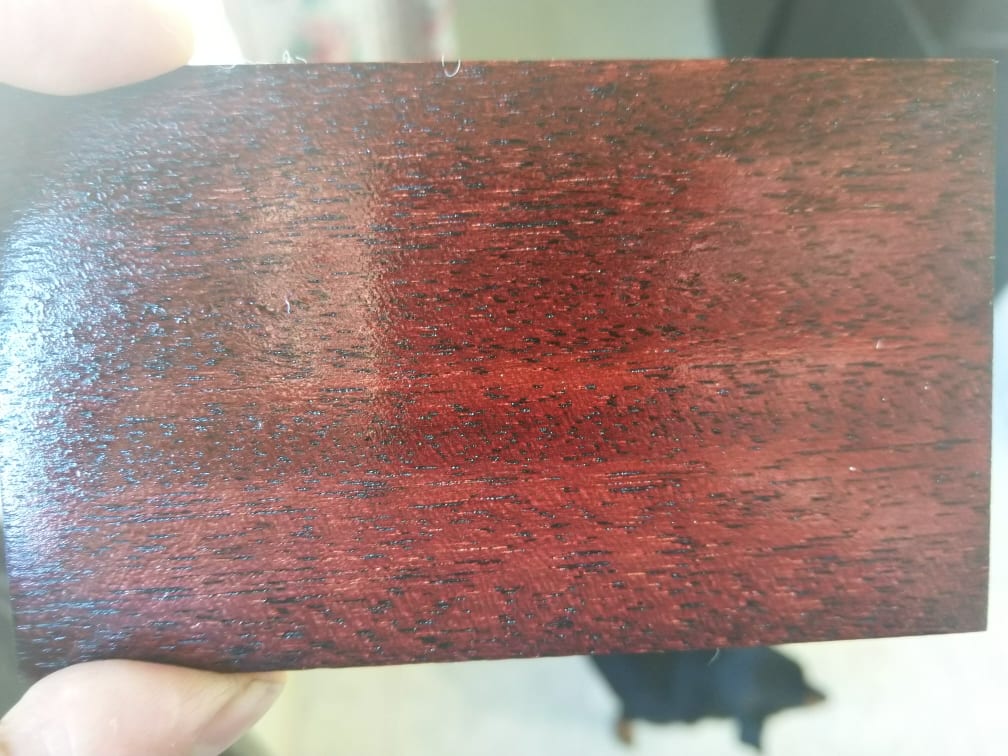

    I've been playing around with the stains during the weekend trying to achieve a different color that my friend likes with some wood samples
    Steps:
    - Sanded from 80 grit up to 120 grit
    - Applied 2 coats of grain filler and sanded
    - Stained the color
    - Applied two coats of Crimson Guitars Penetrating Oil...
    I think the color is too faded, and should be more darker....
ID:	34218 Click image for larger version.
    Also, I think that I'm not appliyng the grain filler the right way. The grain filler I'm using is https://tinyurl.com/tfl8yso. In another test piece, I've followed the same steps, but the grain was filled with white material in some spots, and I suppose it is the grain filler. The first one that I show you doesn't have it. So, my conclusion is that I'm also applying the grain filler incorrectly....
    I think that I'm doing something wrong... What do you guys think?

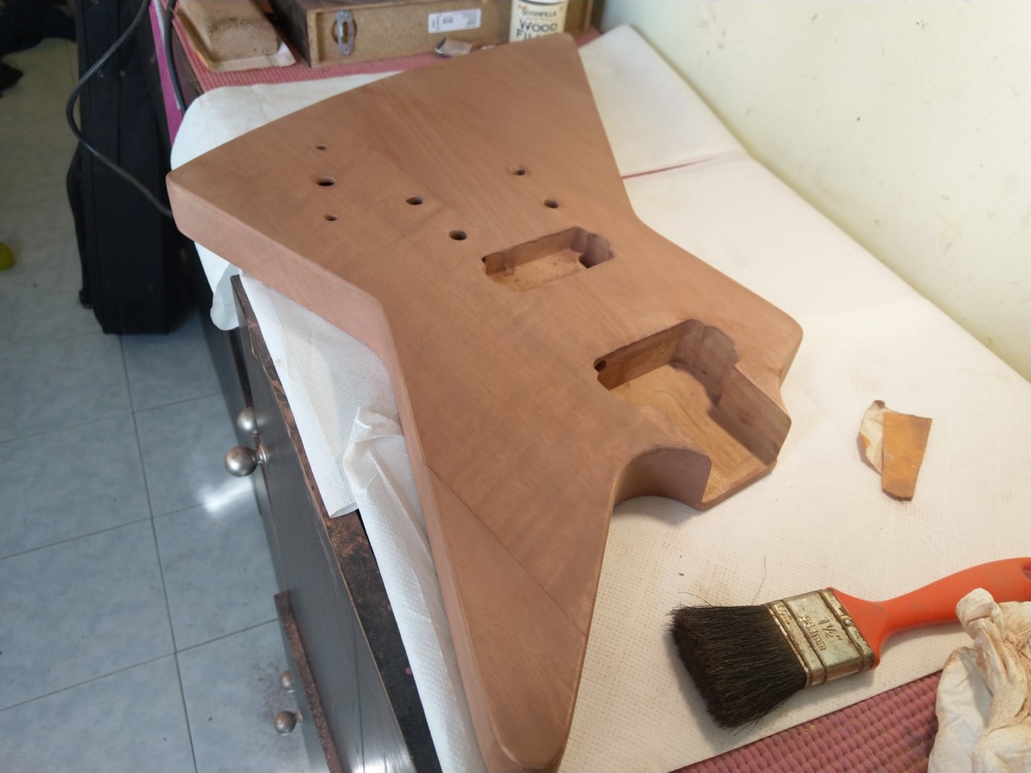

    Good to see you have moved on from mission impossible.....Korina finish as that requires a light coloured timber where mahogany has too much pink and brown hues to contend with. Cherry should work a lot easier.
    The filler looks like it could be similar to Timbermate that we find in hardware stores over here. The one in that picture is natural which would come out looking almost white, which is.....natural afterall as you want it to soak up the colour of stain being applied.
    Suggest re-applying the grain filler and leave it to dry and harden up for 48 hours and then lightly sand off with 180 or 240 grit. You could maybe add some stain to the filler to colour it which assists in blending in when stain coats are added.
    To get better depth of colour you may need to add a few stain coats until it arrives at desired colour.

    So far.. Sanded, and two light coats of grain filler...
ID:	35589 Click image for larger version.

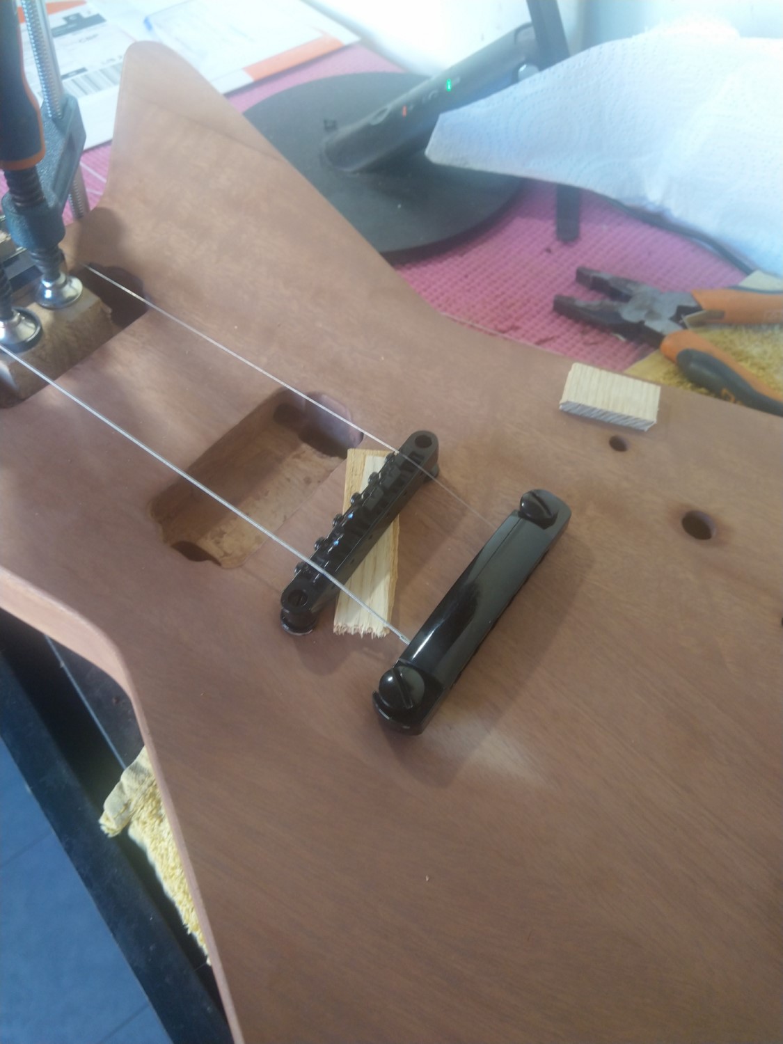

    The kit has been sitting around for a few weeks. And today, the point of no return. Glued the neck. It is harder than it looks...
    But first, checked string spacing this time with real strings...
    And the neck was glued....
