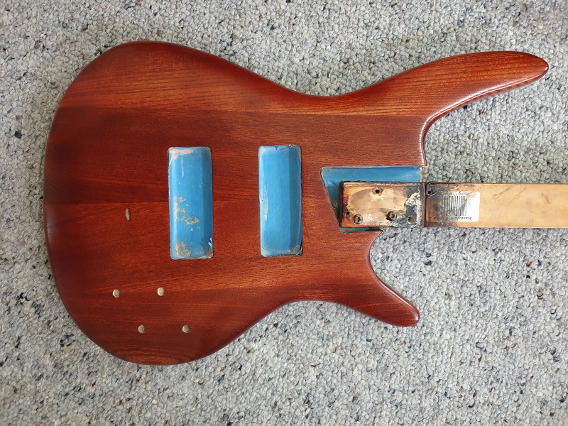

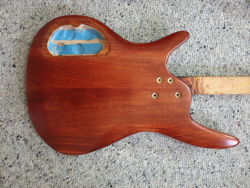

  2. #32
    Mentor ozzbike's Avatar
    Sunshine Coast, Queensland
    1,109
    Back to work again.
    I have done the body with sanding, filling, stain, and Fine Buffing Oil. I think six coats of FBO...first two with steel wool, and the rest wiped on with a cloth.
    The logos on the headstock and it has a couple of Tru Oil coats over the decals. When I get back...the neck with get the FBO treatment.
    Then it will be time to redo the wiring harness.

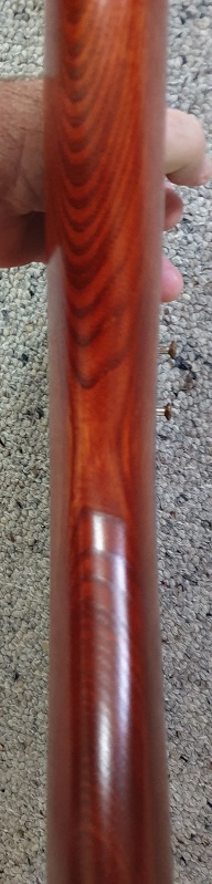

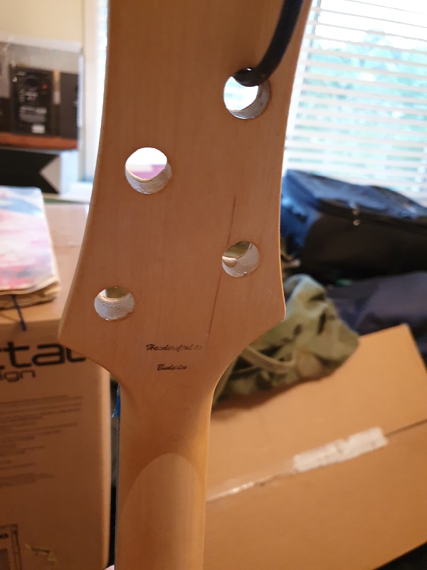

  3. #33
    1,109

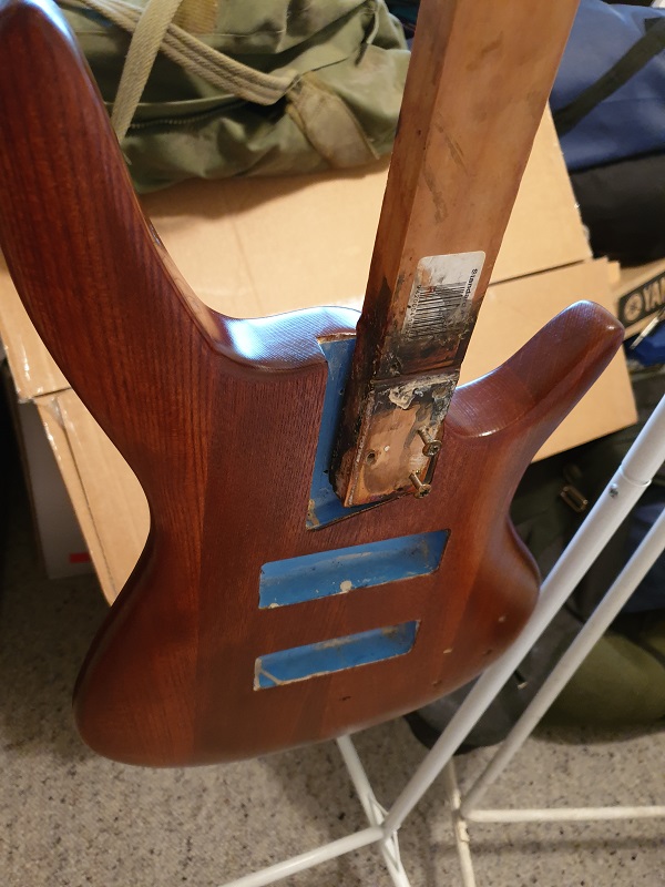

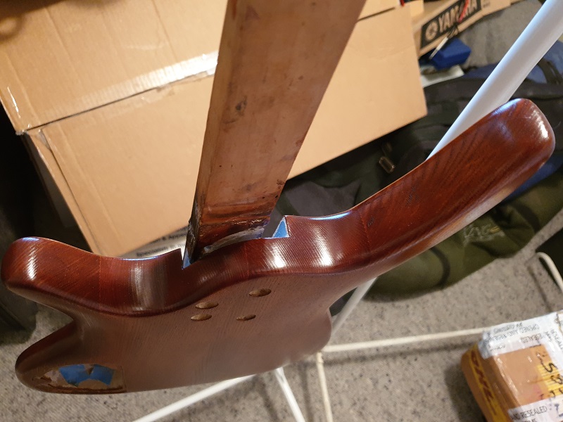

    Body is done and headstock decals are on.
    The body has had many fine buffing oil coats....four wax coats...and two carnauba polish coats...all applied by hand and buffed off by hand.

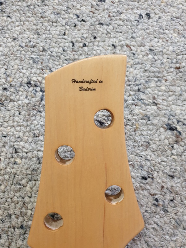

    The headstock has had four coats of Tru Oil, including the last one as a tru oil wet sand at 600 grit. Logos on this morning, they appear to have something to grip on to now.
    The body will get the control cavity taped with copper. Then it shall wait until the neck and the modified wiring is done.
    Headstock will get at least another six coats of Tru Oil to try and cover the decals and produce at least a semi gloss.
    Then the neck will get a number of steel wool Fine Buffing Oil coats, then wax and then polish.....hmmm polish.

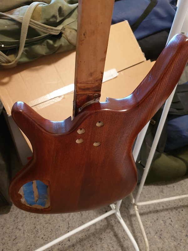

  4. #34
    1,109
    Pots in the control cavity issue.
    Back at work again. Just before I left I put the updated wiring harness....thanks weirdy for the drawing...into the body.
    I plugged it in and man the noise out of it was amazing.
    I am not certain whether it is the barrel shapped jack socket.....or that the pots are really tiny and they may be bottoming out onto my carefully applied copper tape.
    I had put one nylon washer on each pot...and the thread made it through the guitar top and the nut and washer locked the pots in place.
    Maybe I will pull the wiring out and try it on the bench and see if it is much quieter.
    I also noted that the pickups really don't go down that far into the pickup routing holes. Maybe I will have to get the green shed version of the a dremel out and ream out a track down the side of both pickup routing holes and see if I can encourage the wiring to stay in there.
    I did try to fit the supplied capacitors into the new wiring diagram but I had trimmed them to suit the basic wiring diagram and the leads were too small. So I have broken the mould.....I have used two orange drop caps across the volume to tone pots.
    Maybe I may have to grind out the control cavity to ensure that none of the connection lugs on the pots are anywhere near the copper tape......really just the two sections between each volume and tone pot recess.

    Neck is keeping me calm. It is looking really nice. Ripped the logos off....they were terrible. Got some new ones on....and three coats of Fine Buffing Oil on the back of the neck now....so smooth and minimal gloss. The headstock has about ten coats of Tru-Oil in total and only one wet sand at 600 grit. It will get no more and will get wax and carnauba polish with the rest of the neck.
