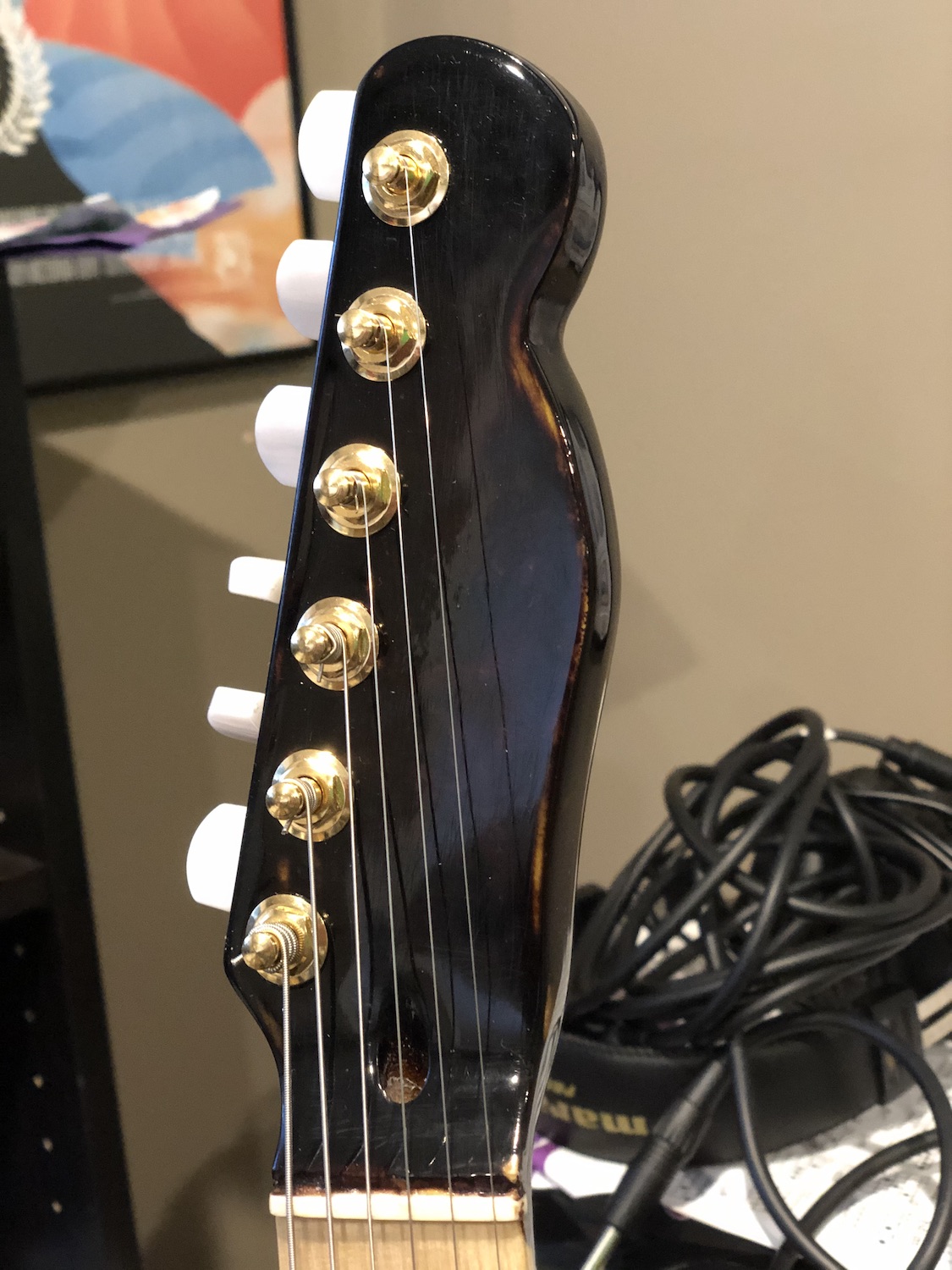

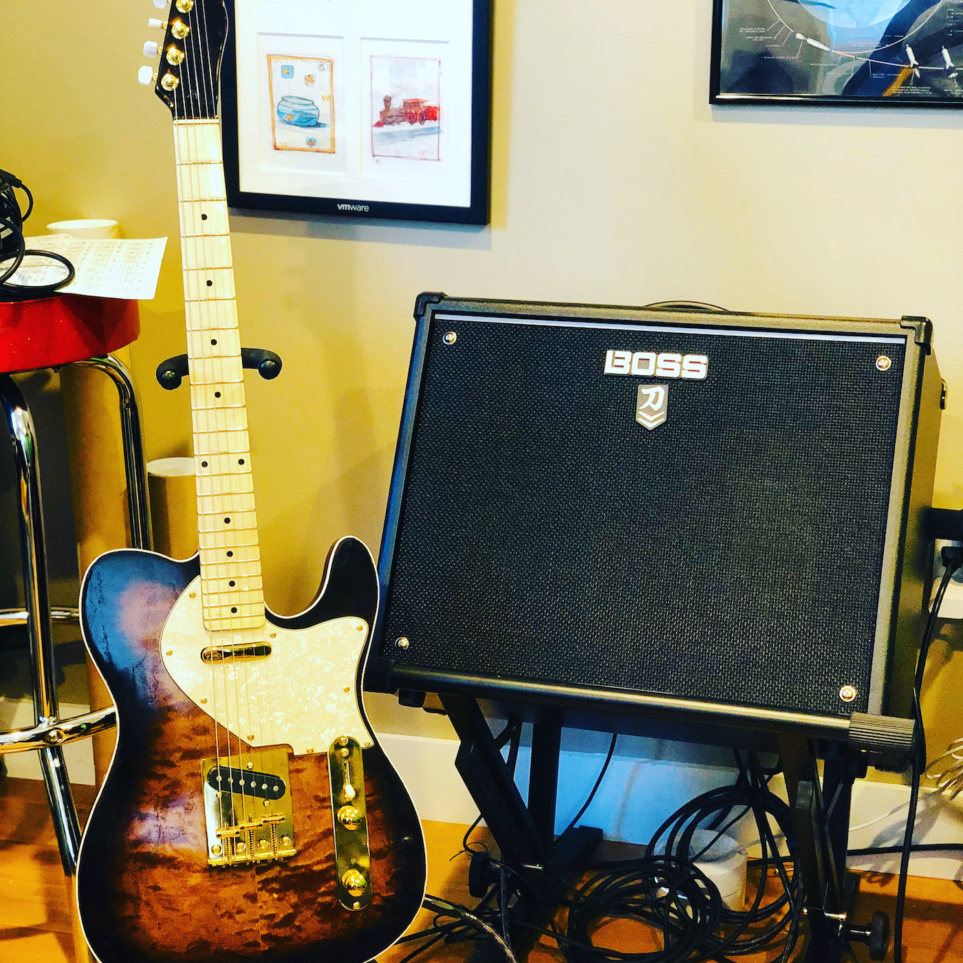

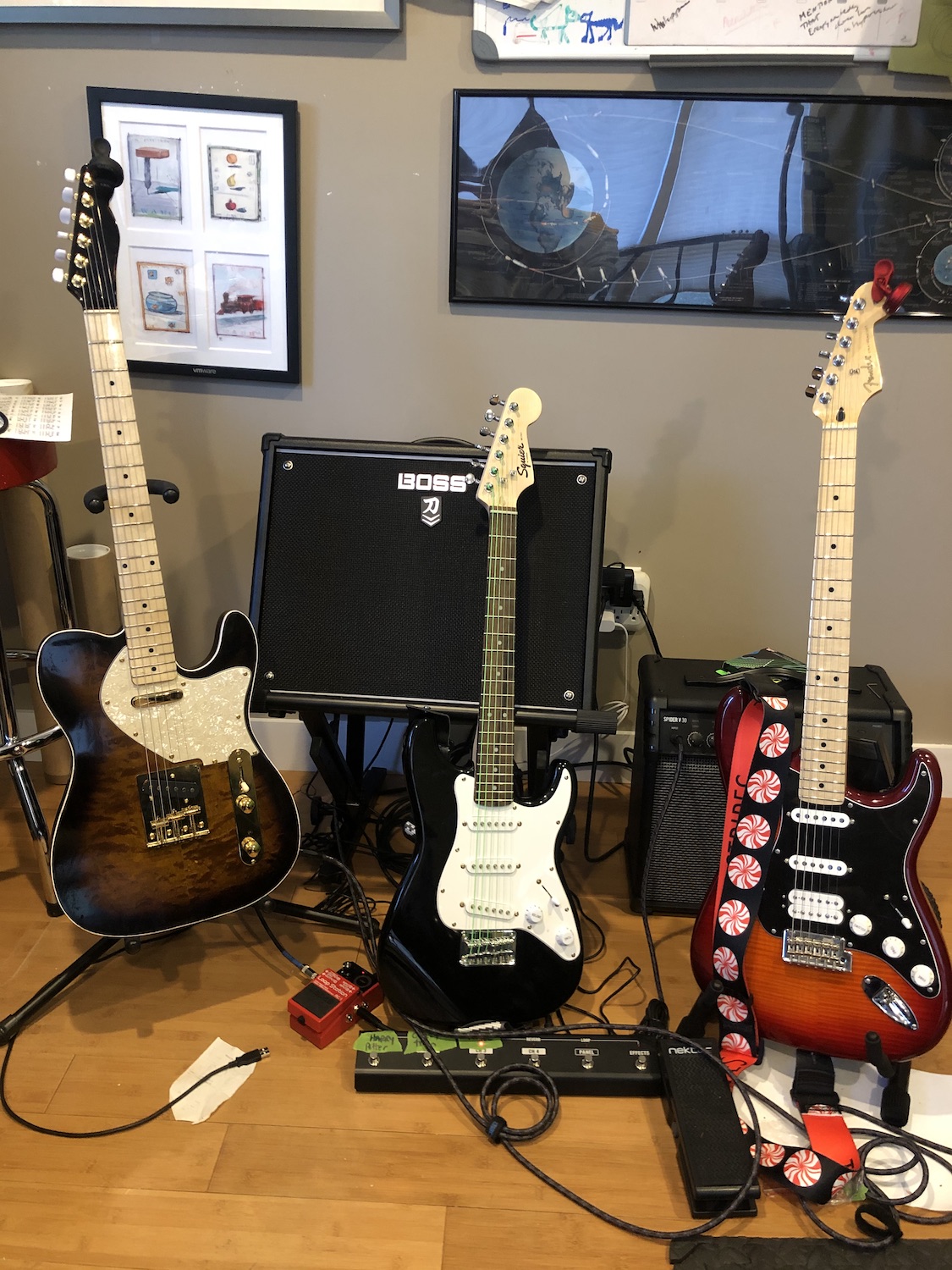

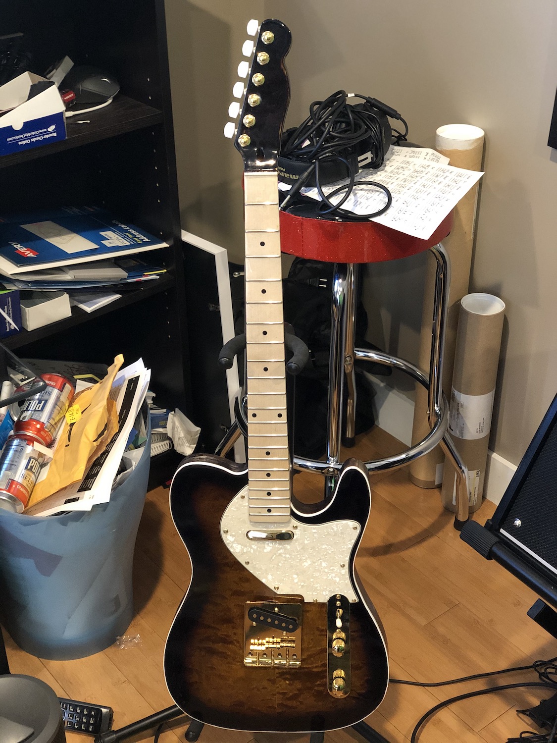

    I finished!! Here are some pics. I originally dyed the headstock yellow and had custom tuff dog decals. The color was not great and the decals were rippled, so I repainted with encore brown lacquer and then more clear. I wet sanded, and polished the enter neck then put everything together and strung it up. I love the way it looks and sounds. Thank you all for your tremendous help.
    Not bad for a first build! See pics below
