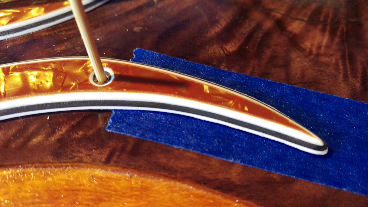

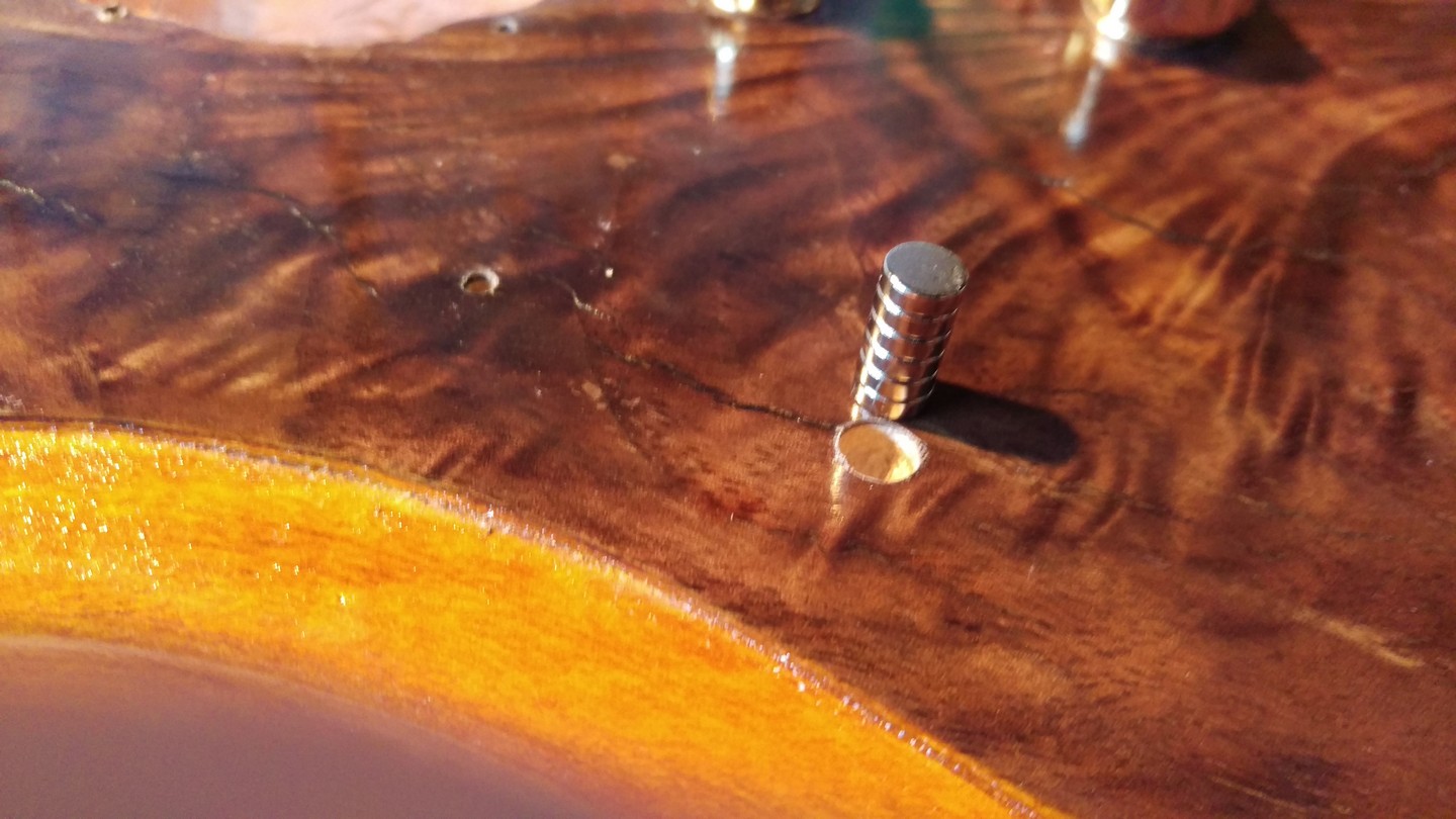

    Its 2 weeks after the op and im finally able to sit down and do some more on the guitar.

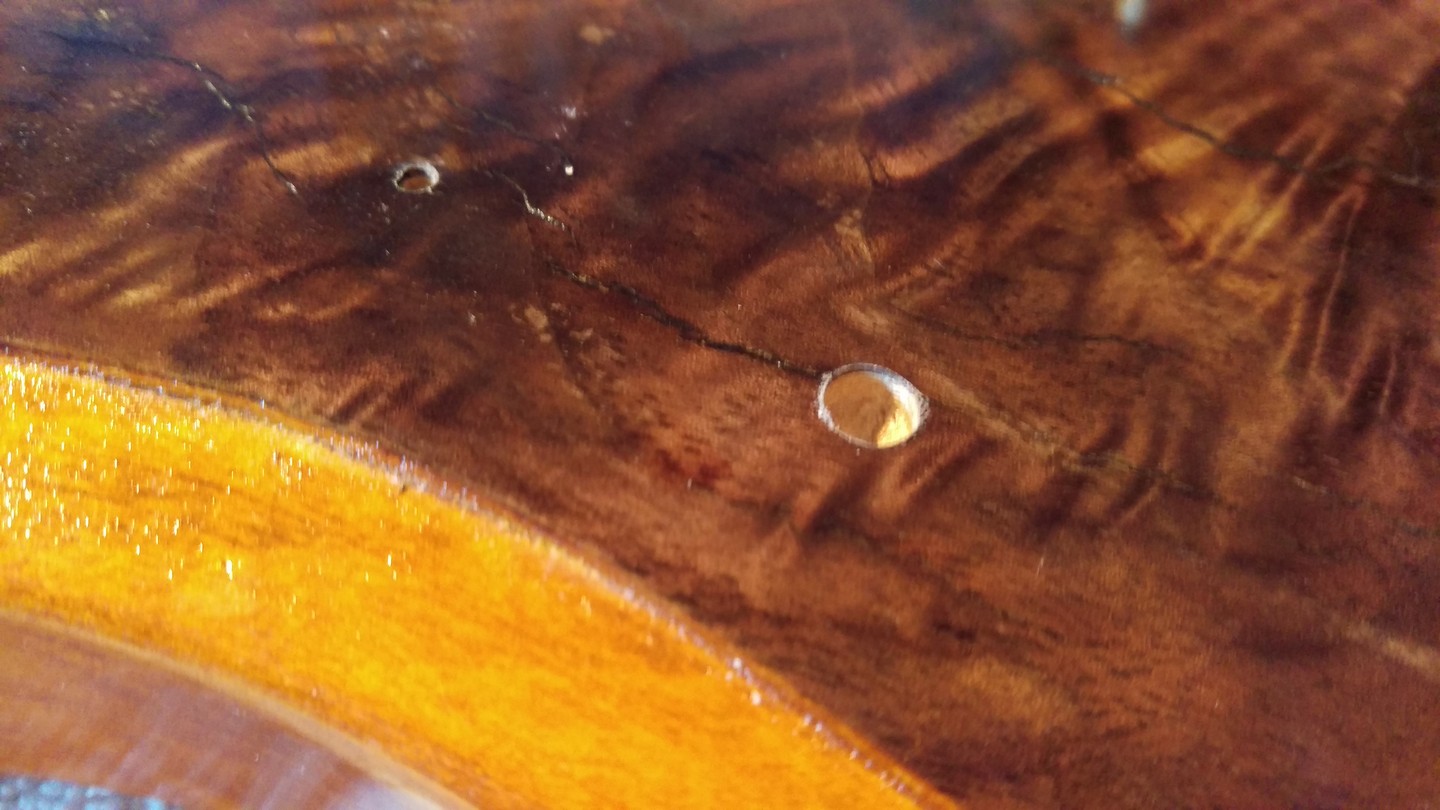

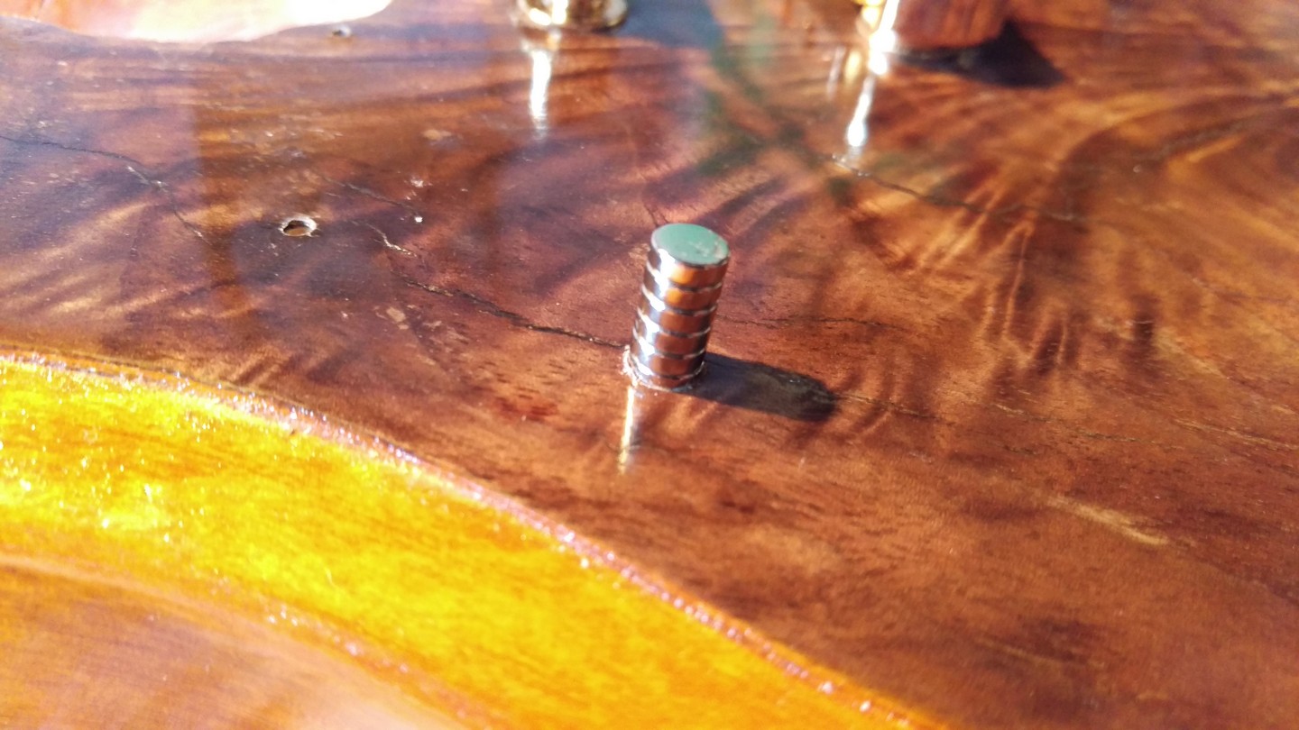

    When the pickguard was screwed down the 2 thin ends sat a bit away from the guitar face so ive set in 2 tiny magnets to help hold it down.
    I used toothpicks in the screw holes to set it in place before i traced an outline on the tape and drilled the holes for the magnets. Now just need to glue one each to the back of the pickguard..

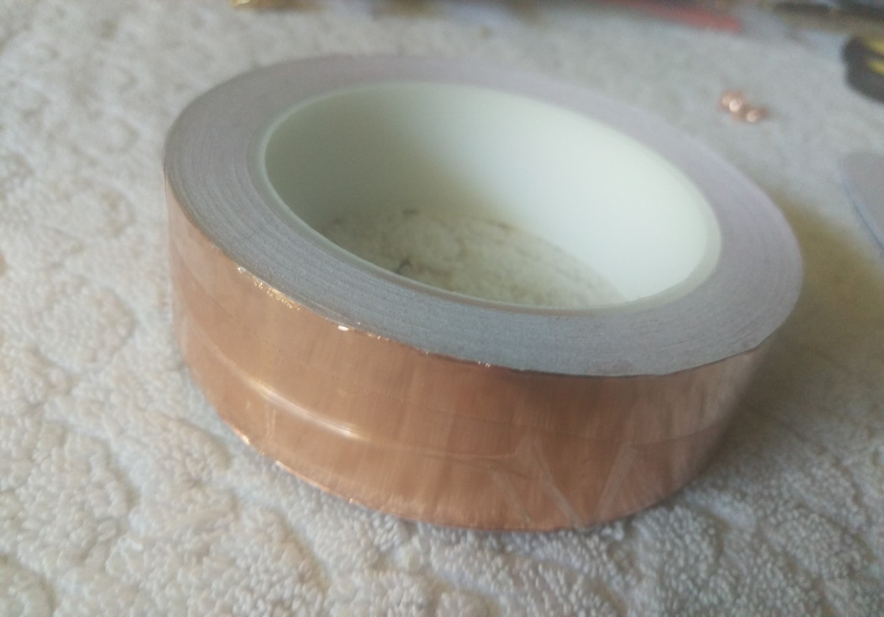

    Ive been waiting on some copper foil from china the local store wanted to much money for it. They wanted $24:95 for 50ml x1mtr, i got it from china for $9 and free postage for 50ml x 30 mtrs! No wonder we shop online....

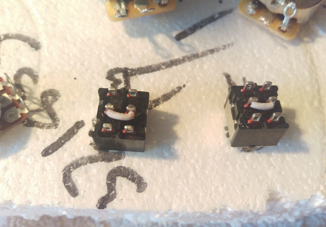

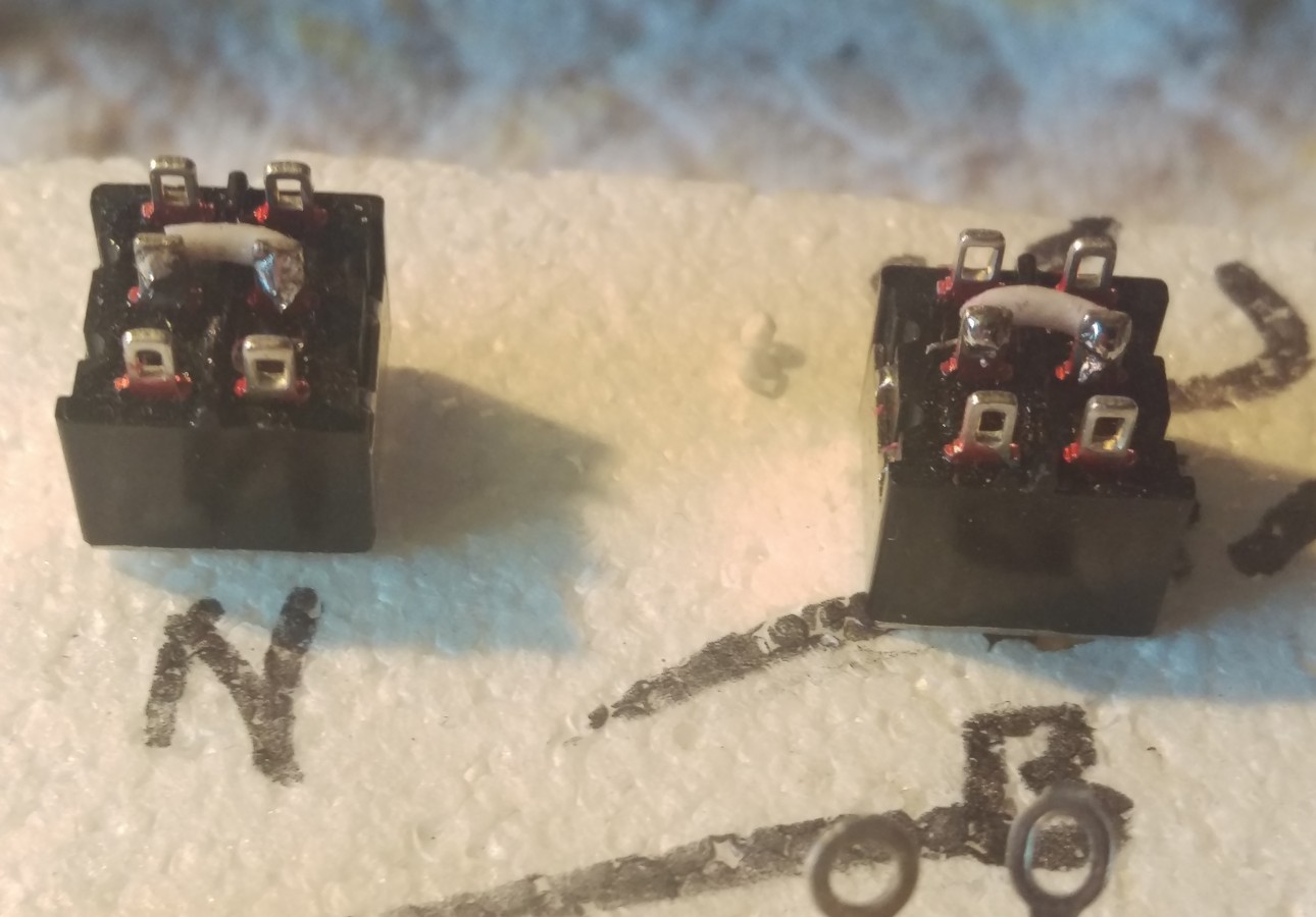

    Next comes out my dodgy magnifier for all my close up wiring (another sign of old age) and DAMN are those switches fiddley!

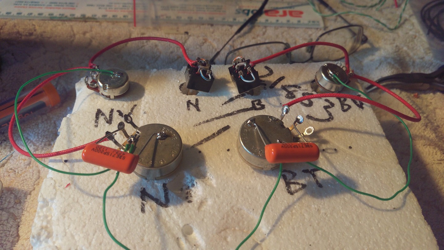

    ive set all the switches in polystyrene for easier workability but realised they are a mirror reverse and have to work out the wiring diagram accordingly.

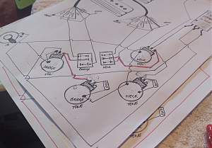

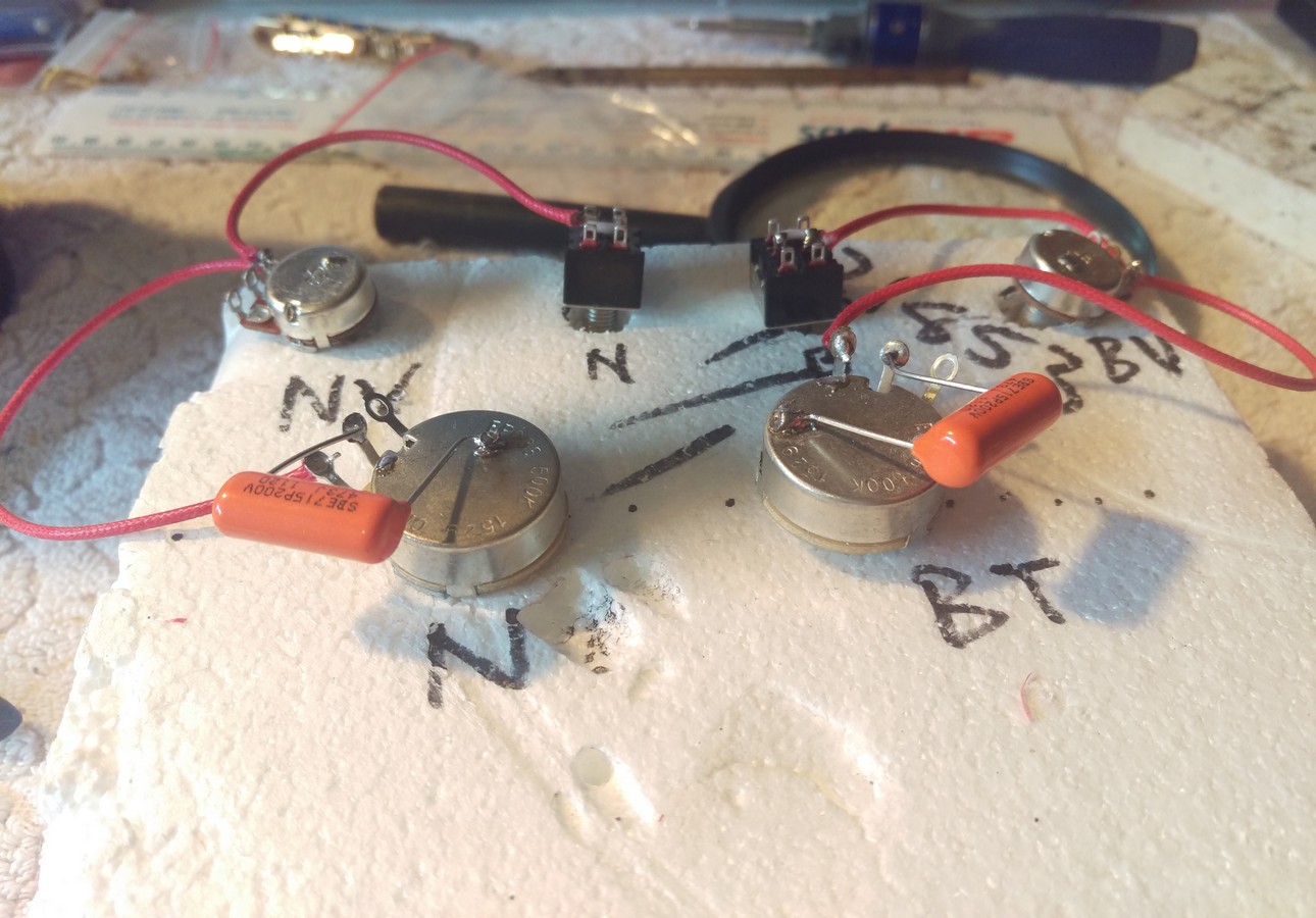

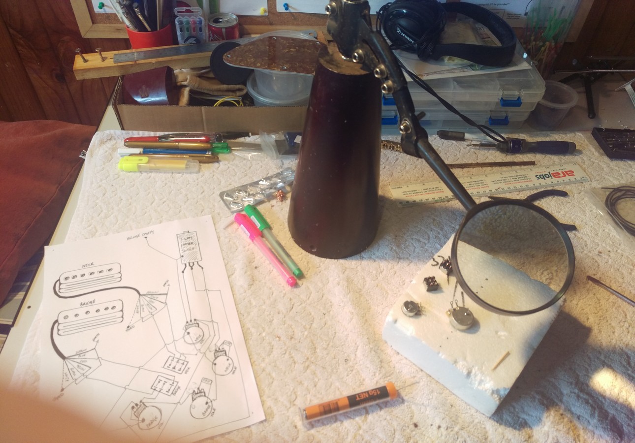

    Still on the wiring, ive printed a black and white copy of my coloured wiring diagram and colour in the wiring as i do it so i dont make any mistakes, and also written on the poly the pot positions.

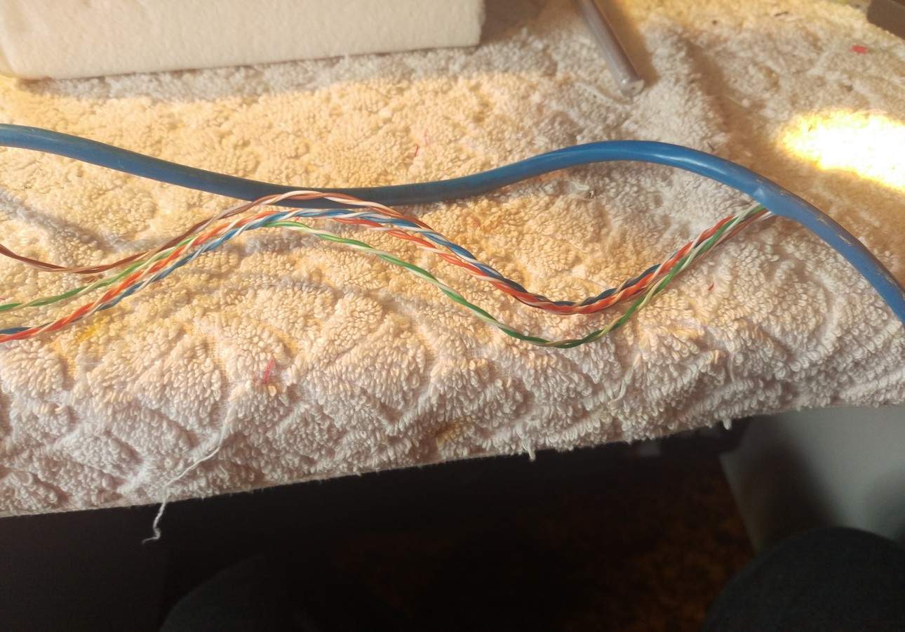

    I got an old piece of lan wire, stripped it and used the thin coloured core wire for the earth as it was green and doesnt need to be very thick.
