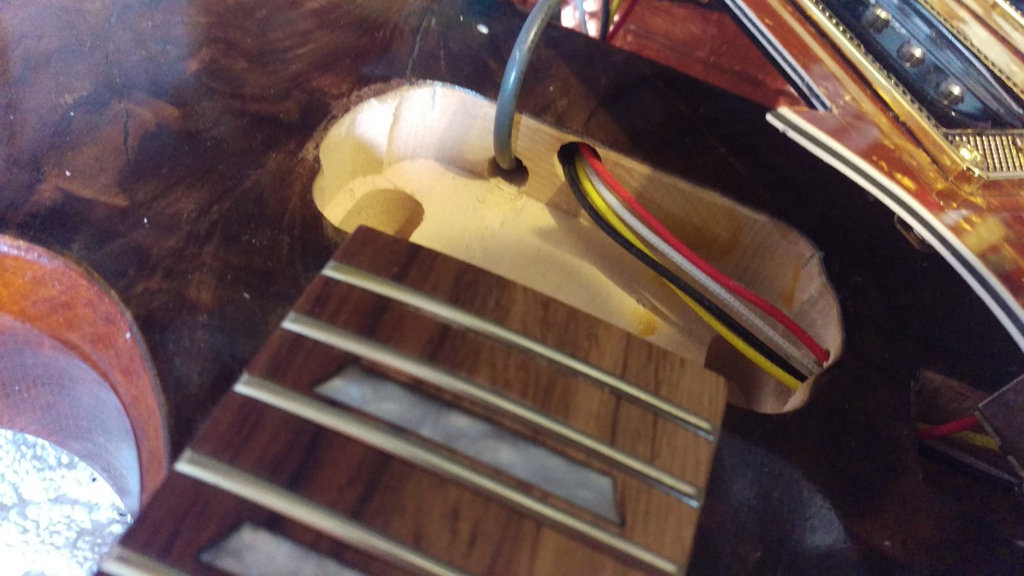

    If you haven't already done so, just try all your cavity connecting holes for size before you go too much further. Especially your bridge pup hole to the control cavity has to pass two six-core + ground pickup leads plus three or four (four for a switch ground wire if you aren't using shielded connection wires) wires too/from the selector switch, plus maybe one or two ground wire for the cavity foil grounding connections. Make sure both pup cavities have enough room to run the cables through them without getting in the way of the pickups and causing them to tilt or sit up high.
    If you need to get a drill or a Dremel out to create some extra or wider channels, I'd do it now.
    Hopefully you won't need to - but better safe than sorry.
    Already there and done mate, read page 33 i didnt just enlarge the holes i drilled extra ones, look at the pics

    A few small updates....

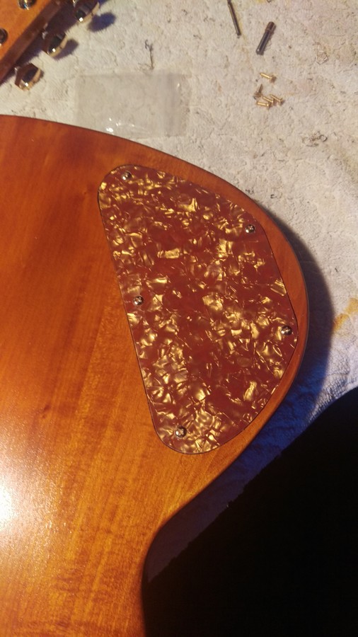

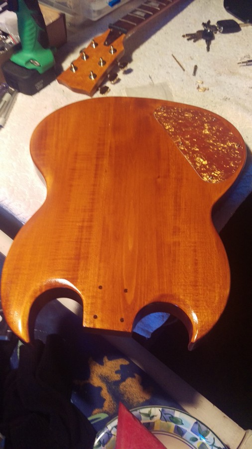

    Completed the electrics rear cover plate.

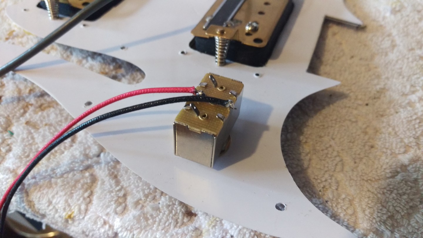

    Started the wiring of the 3 way selector switch and fed through the wires to see if the holes i drilled were sufficient.. Bingo...all ok.

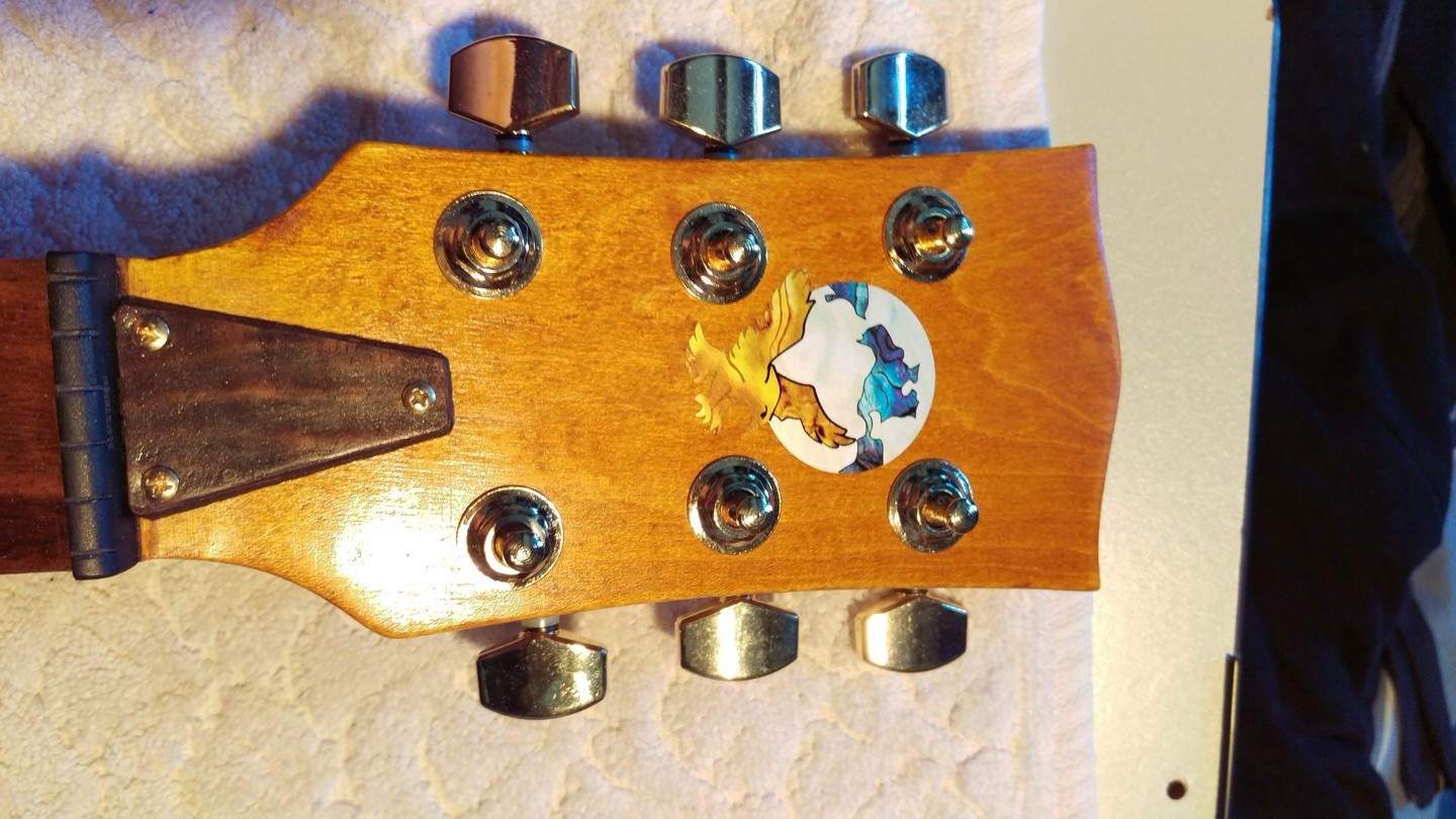

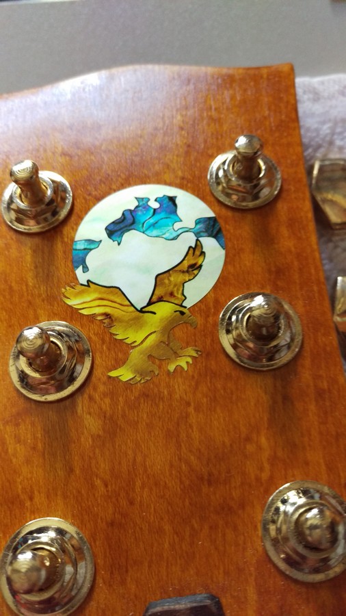

    Been waiting for a headstock logo transfer and it arrived today in the post.
    Still have to clear coat it. just wanted something simple, might put a small personalized name on it yet, ill see. Its white and gold m.o.p.

  10. #360
    Nice logo.

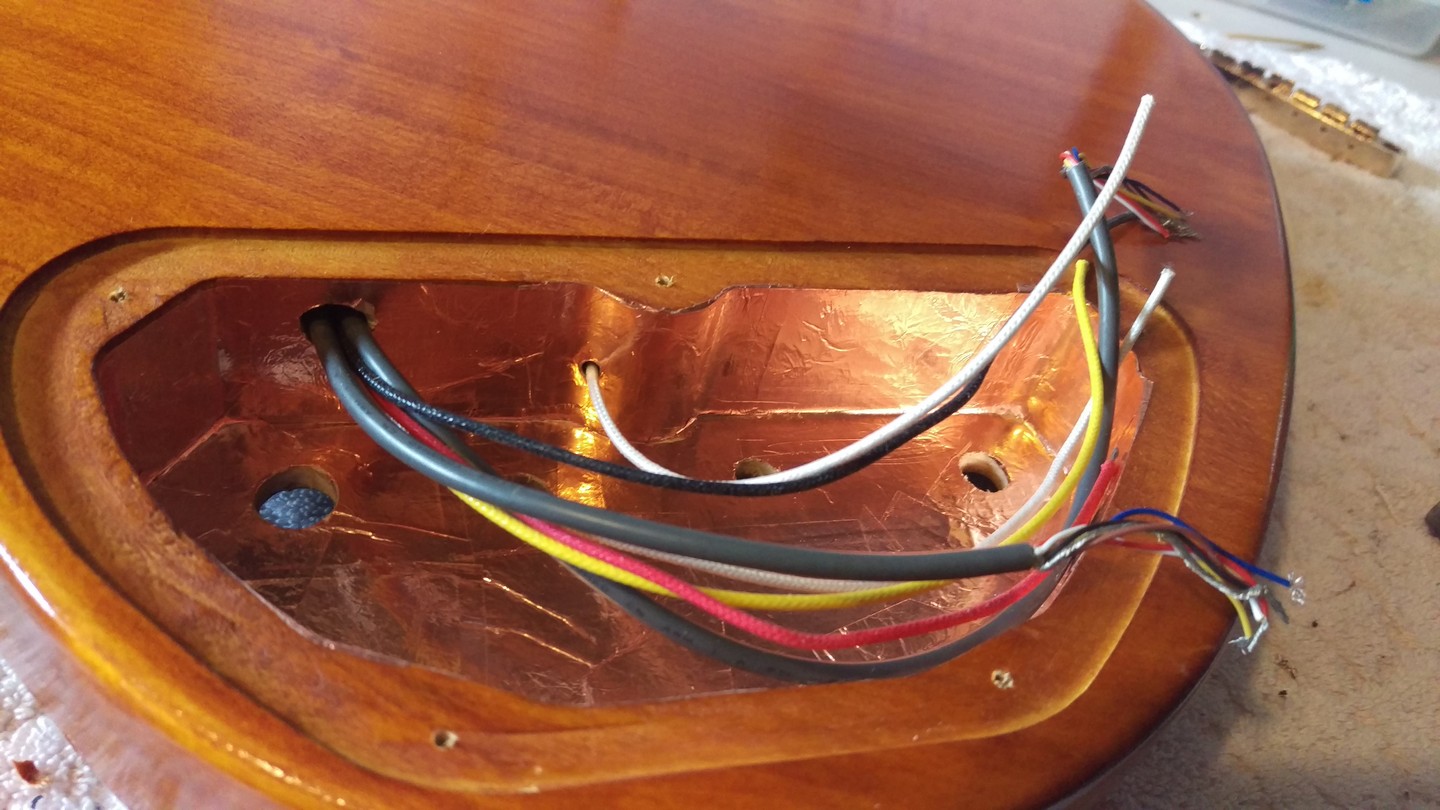

    Looking at the neck pup wiring picture, I think you may have some issues with the wires interfering with the pickup leg and height adjustment screw, as they are currently coming out of the selector switch hole right where the leg and screw goes. Have you tried fitting the pickup in with the wiring there?
