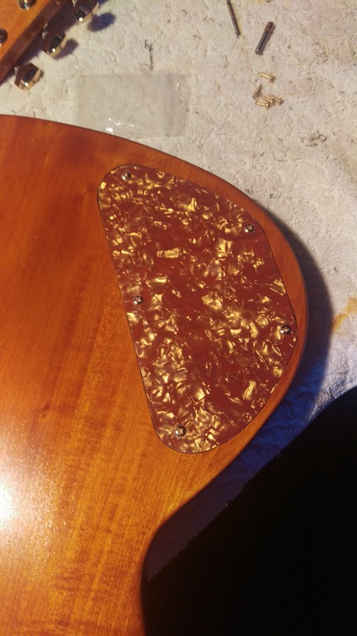

    I also had time to replace the crappy black plastic control cover with a piece of the pickguard material.

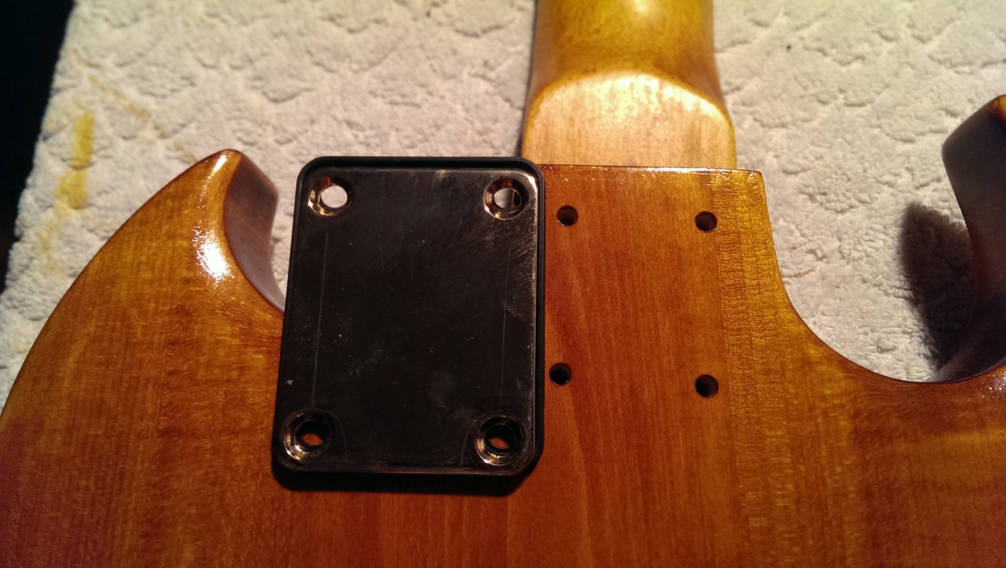

    So when i first bought my SG-2 it arrived with no neck cover plate, so Adam kindly sent me one, BUT this morning i decided it was time to fit the neck and i have a problem, i think the plate i was sent is for a Fender not a SG, its way too big. Can anyone tell me how to get in contact with Adam? It needs to be a gold SG neck cover plate assembly, cheers.

    Hi Adam, when you sent me the cover plate assembly silly me didnt check the size, now im ready to fit the neck i find its too big, looks like a fender size. Heres the the pic. Cheers.

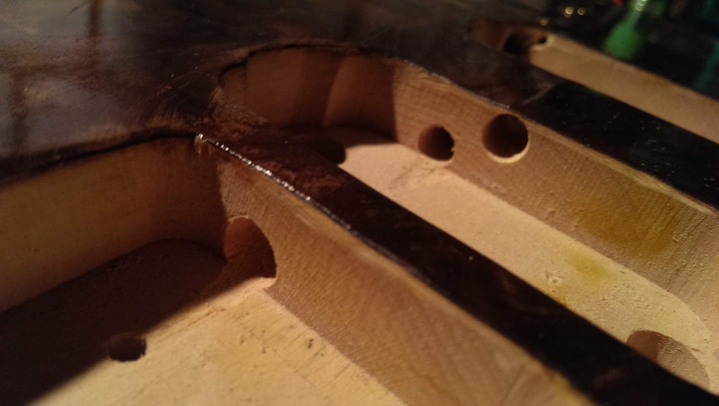

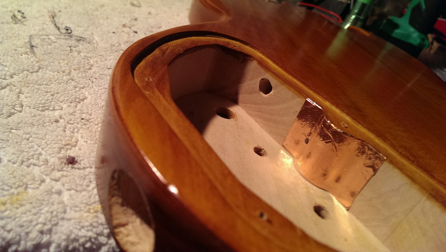

    Until i have the neck thing sorted i thought id get on with something else. I enlarged the holes for the rails 6 core wiring and then started on the copper foil insulating.

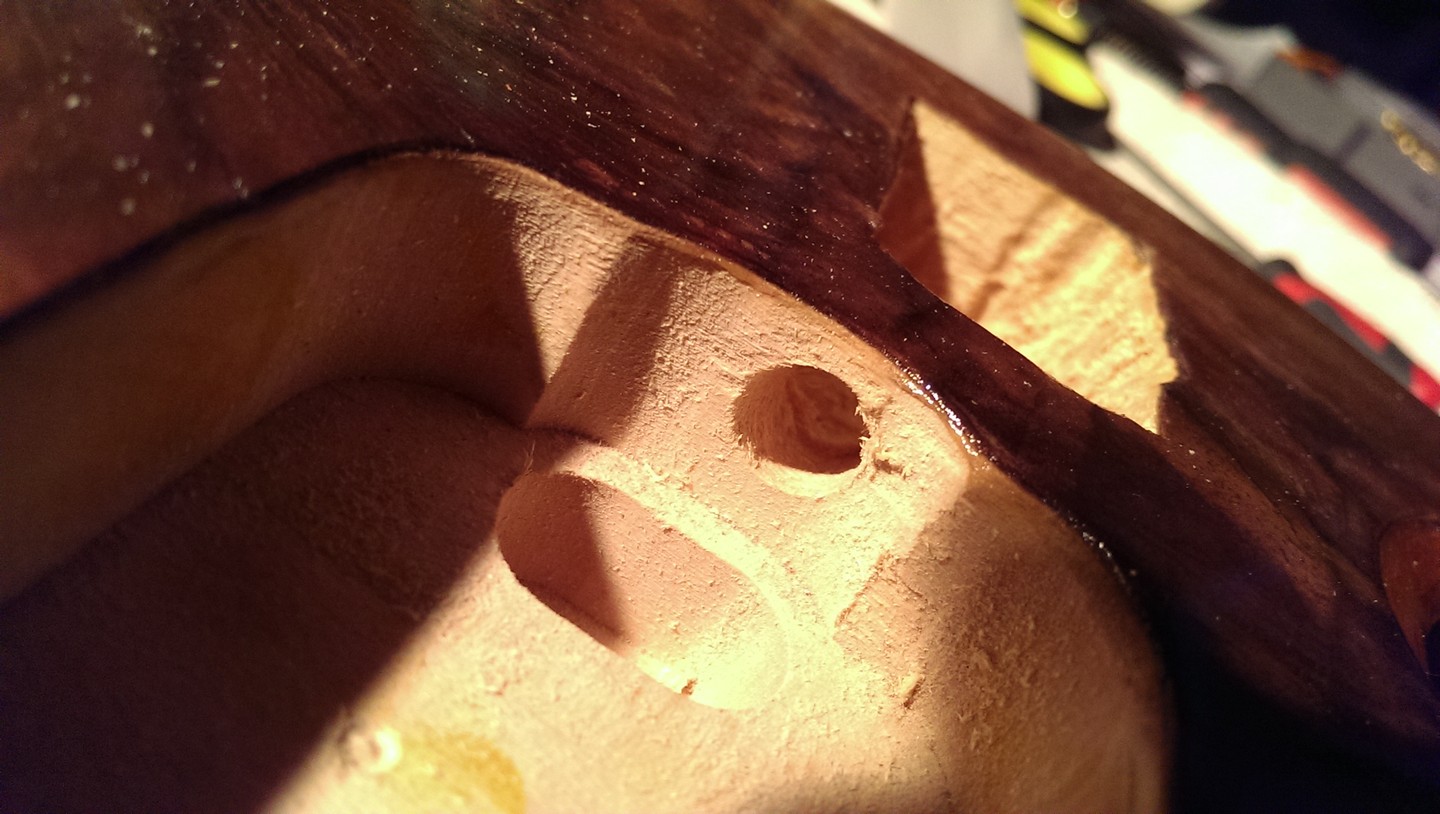

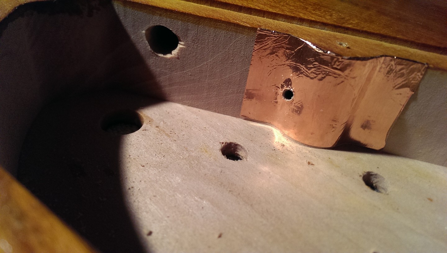

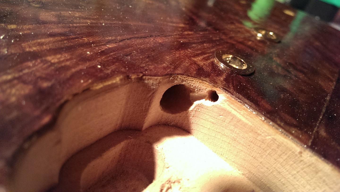

    While doing the control cavity i came upon a small hole and realized that it was for the bridge earth, but how to fit when i have already fitted the posts?

    Question....... How do you solder an earth to the bridge posts anyway? Wouldn't it break off when you hammer them in?
    Ive redrilled a new hole by the string adjusting post and was hoping just to bare the wire and push it in and glue it in place. Would that be okay?? Pics below...

    You don't actually solder the ground wire to the post, it just makes pressure contact when the bushing is pushed in. Recent discussion about how to install it and what to do if the bushings are already in.
