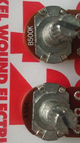

    Easy enough to undo the pots so you can get the harness out and look at them. The A and B are normally printed on the insulation that the 3 tabs are connected to on the shaft side of the pot (so you can't see from the back without taking the pots out of the guitar).

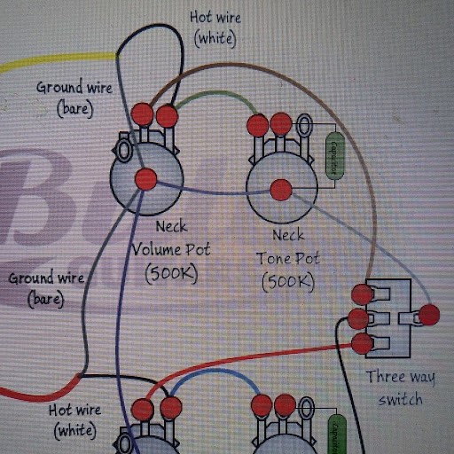

    True about the A and B pots. personally I prefer all audio pots. I dont think thats Kicks problem though. have a look at his wiring picture on page 30 and see if you can see a problem. To me (amateur) I don't think that hes earthed the pots properly

    Think Andy is right, to my even more inexperienced eye for a start the earth is missing between the neck volume and tone pots

    He has. Purple wire between the neck and bridge volume pots, blue wire between bridge volume and tone and green wire between bridge and neck tone pots. You don't want a fourth ground wire between neck volume and neck tone to create a loop. It's not as the diagram, but they are all connected and its all good.
    As long as the output ground is connected to one of those pots, then all should be fine. The solder joints, whilst not the neatest I've ever seen, all appear to have flowed across the surface of the pots and aren't blobby and suspect.
    What I'm not 100% sure about are the three yellow wires soldered to the back of three separate pots as I can't see where they go.

    About the three yellow wires; the one connected to the neck volume is the earth from the bridge. The wire from the bridge tone is earth for the jack and the last one from the bridge volume is earth for the threeway switch. But I must admit, that is what I think it is. I have open it up to see it.

    You can see it Kick...

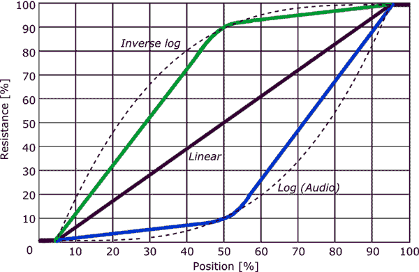

    A 'taper' is just the shape of something that goes from thin to thick, or thick to thin. In this case it's the shape of the resistance curve of the potentiometer as it's turned. Just another word for 'curve'.
    Here you see three curves/tapers for different characteristic pots. The coloured lines are the more realistic values, the dotted lines are the ideal curve. You can get pots where the real-world curves match the idea curves but the cheaper pots tend to use two strips of different resistance track to make up a log (or anti-log) pot.

    I'd still just remove all the pots and look for the A and B labels before thinking about swapping them. If the A pot is volume, then it might be damaged.
