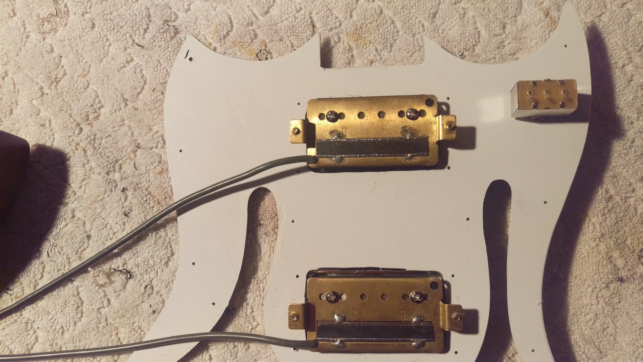

    Hi Nitro, just curious to know if they both have the wires coming out on the same side when you look at them from above?

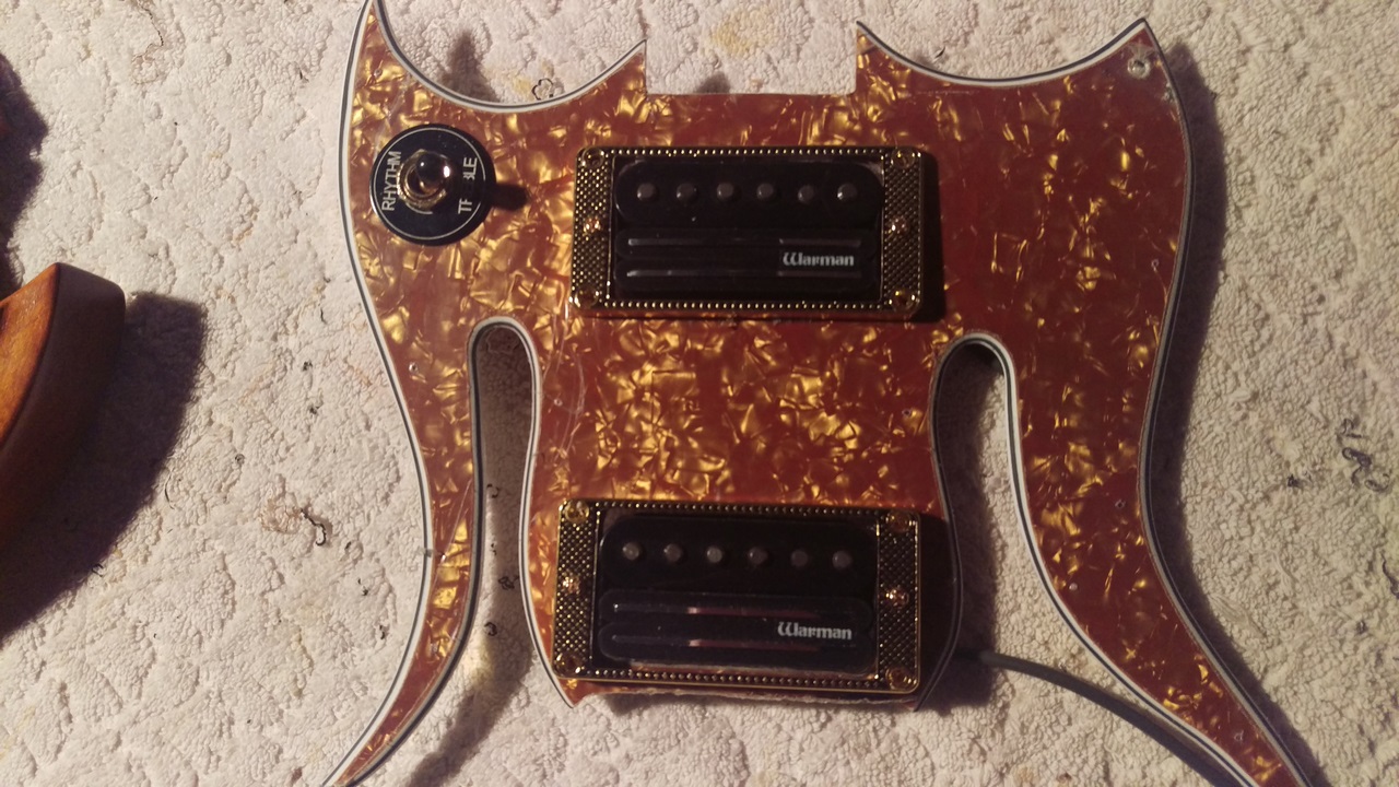

    Heres a pic of the front and back of the pickguard

    Hi Nitro, judging by the reverse side of the pickguard shot I reckon you have them facing the right way.
    Did you run a multi meter across the wires to see if either PUP had a higher or low impedance as the lower impedance usually goes in the neck position? If they read the same no big deal as you can balance the noise level by raising or lowering the PUP's to get the desired separation when using the 3 way toggle switch. Personally I prefer to have most PUP's at similar volume and allow their positioning and tonal characteristics do their thing without suffering dramatic drops in noise level when switching between them.
