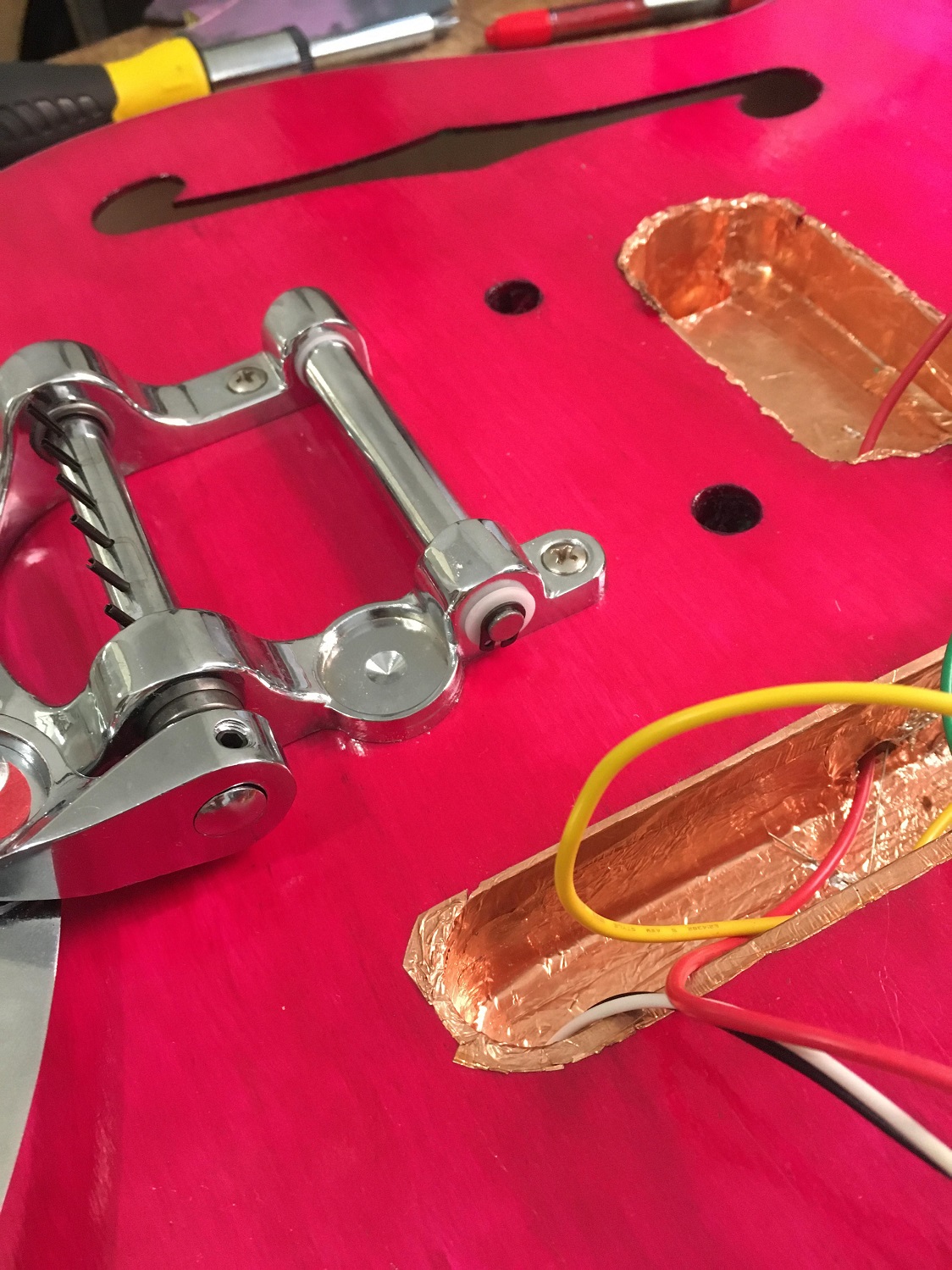

  5. #25
    The front of my bigsby seems to be missing some metal caps. In the photo you can see its just the plastic bits and metal. It's like that on both sides. If it is supposed to be like that, its very ugly. Click image for larger version.
  6. #26
    To be fair, the bridge included in the kit is a "Bigsby-style" vibrato and stated as such in the kit description. A genuine USA-made Bigsby would cost nearly as much (or more) than the price of the entire kit.
    I'm not saying it isn't less aesthetically pleasing than the real deal, but we have to be realistic at the same time.
    On the plus side, it looks like your finish came up alright despite your earlier issues.

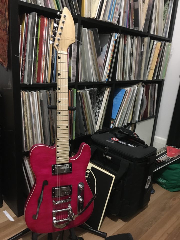

  7. #27
    had the pick ups working. put everything together ed around with intonation forever. plug it in... nothing. oh flip. gotta go back and open her up.
    this is what it looks like so far for anyone interested Click image for larger version.
  8. #28
    it's a lot pinker in person too
  9. #29
    Probably a signal wire touching the copper shielding. I recently had a pot rotate and cause something similar to happen.
    With that headstock it looks very muck like a Vox/Fender hybrid, with a touch of Gretsch from the fret markers.
