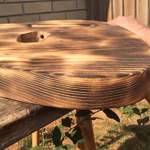

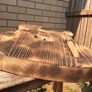

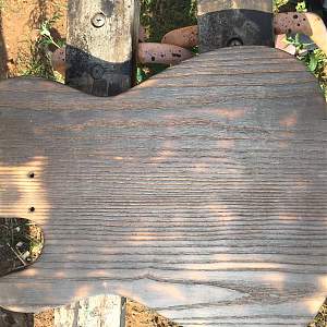

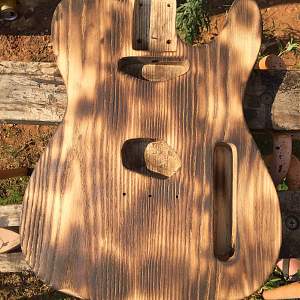

    So today I gave it a bit more of a sand then back to the wire brush and I think it has come up a treat. The texture of the grain is you beaut and I think with a good drink of oil the colour of the timber should come back beautifully.
    I’m in two minds about which side I like best. I think the back is going to look awesome with that glimmer of timber showing thru the char, yet I the face, despite the spotting of char, once finished should really bloom.
    I’d be interested to hear everyone else’s thoughts/preferences.

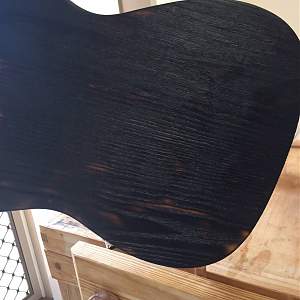

    First coat of oil, starting to come alive.

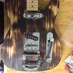

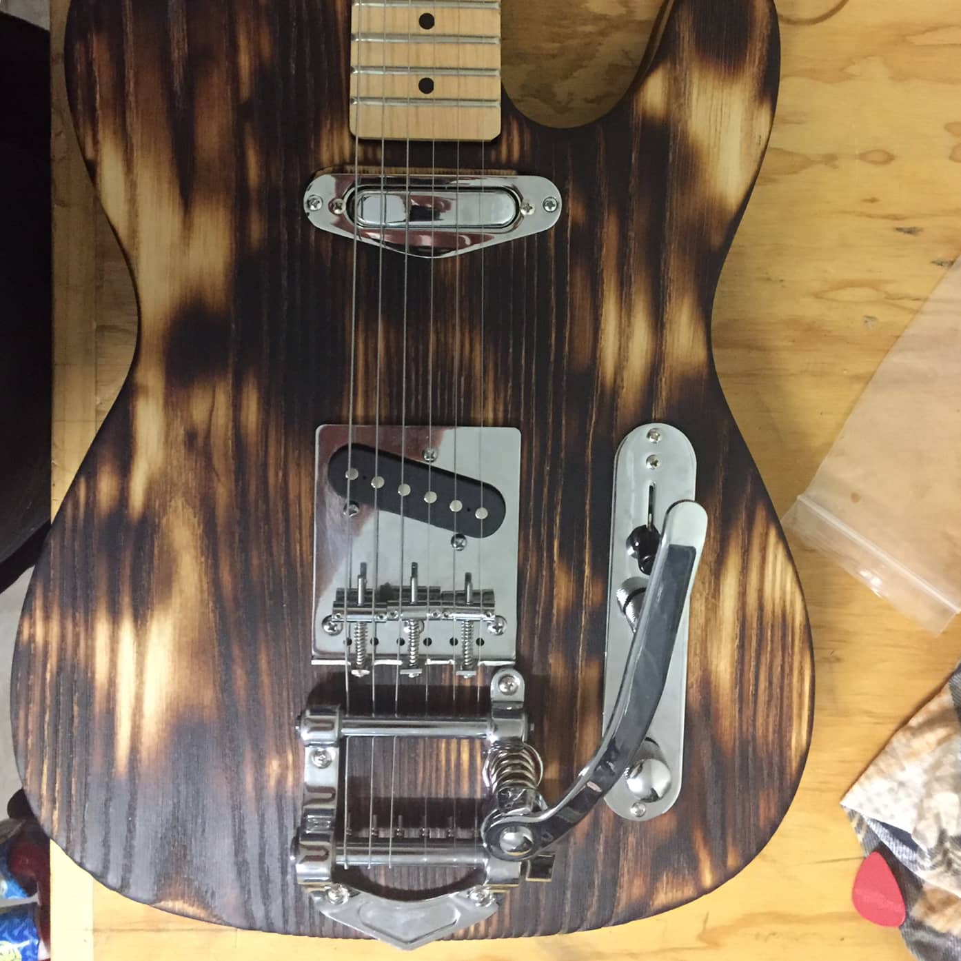

  10. #30
    I’ve been a bit slack lately with the posts. So I got a neck pick up ring, had to shim quite a lot as the routing didn’t match the size of the ring. But it looks fine. I watched a video by Darrell Braun on modding a Tele bridge to accept a bigsby and had a go. The files I had didn’t do a good job and I wasn’t too straight with it so opted for the angle grinder. It’s not pretty as i had plenty of beer by that stage, but it works. Its all wired up I just don’t have an amp as yet to test my wiring. Too close to Christmas to be spending money. It plays well, I’m no expert, haven’t picked up a guitar in years so I don’t know the finer points, but I’m happy with it.
