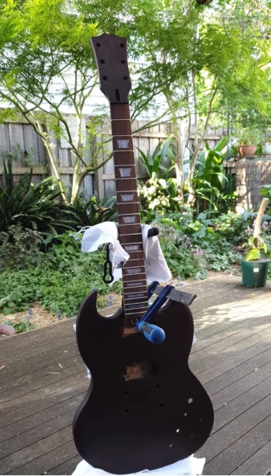

    The mahogany + sanded black stain came out much darker on the front than expected, however i like how it turned out.
    So the original plan to try a black burst around the outside isn't going ahead! (probably a large source of mistakes doing a burst for the first time)

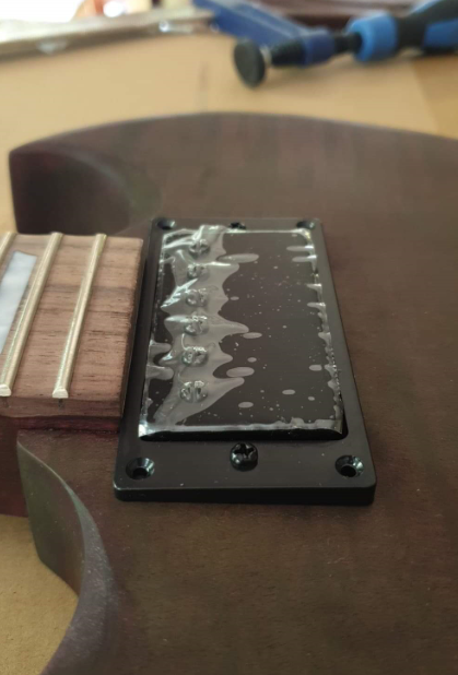

    I got to gluing in the neck, opted to do this before getting to the true oil, just to have a nice consistent layer.
    I was a bit nervous when gluing the neck, hoping i would get it in place without causing the pickup to not fit, and throw off the scale length, but all is good.
Name:	Neck clamped.jpg

    Quote Originally Posted by Simon_B View Post
    Looks good. I'm going to sand most of the ebony timbermate off and stain cherry.
    Good job with the neck - I'm scared of gluing it crooked
    I found ebony timbermate easy to work with, dont do what i did and just slap it on nice and thick! Haha, spent a long time sanding...
    I found the neck pocket was such a tight fit there was no other way than the way it was made. I remember reading somewhere to not sand the neck pocket and heel on the neck, as they are set up in factory to be straight.
    I stressed about accidentally gluing it in to short but all seems good.
    As a first build, gluing in was a very high pressure situation, the glue starts setting fairly quick, so not much time to adjust the position and clean off any mess.

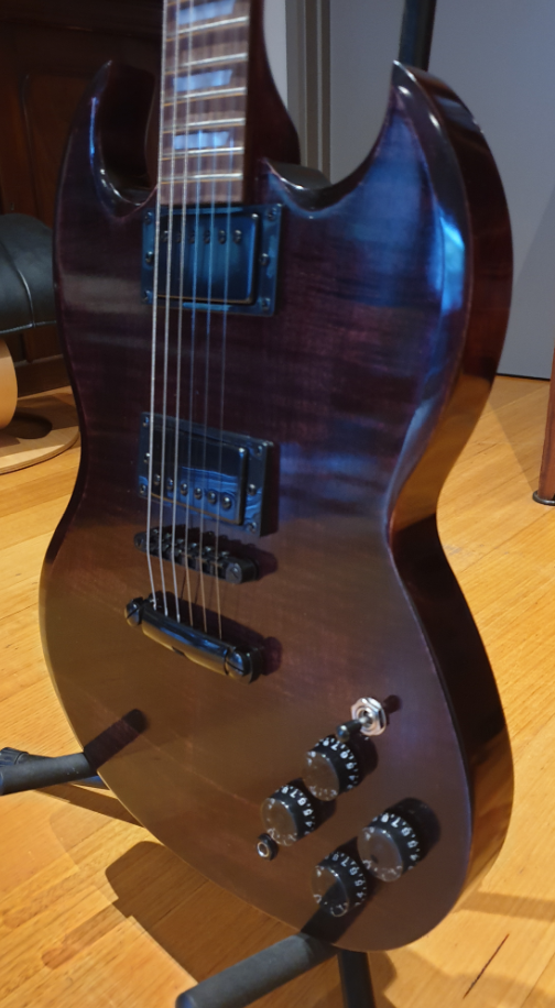

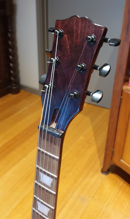

    So i popped on another 2 or 3 coats of truoil on the body and was pleased with the way it was looking.
    Realizing and accepting not every small imperfection wasn't going to come out, i pushed on!
    Got the wiring done, sheilded most of the guitar (1 pack from pitbull wasn't close to being enough) with the two pickup cavities being done and just needing some more to get the sides of the control cavity and the back of the backplate done.
    As soon as the electronics were in and secured... i couldnt help but chuck on the strings to have a look... ITS ALIVE!!!!
    Pretty dam happy with the way its turned out. Still got a couple of things to do to completely finish it off, but just about there!!!

  9. #29
    Member SamSquare's Avatar
    Dec 2018
    66
    Looks great! The black hardware gives it ‘stealth mode’!
    Are you planning on doing any sort of logo on the headstock and/or truss rod cover?
  10. #30
    Member Mcgaz's Avatar
    Aug 2019
    Melbourne, Australia
    23
    Quote Originally Posted by SamSquare View Post
    Thanks man!
    Stealthy indeed!
    Not sure about a logo for the headstock; i like the bare look of it and not the most artistically creative, maybe ill look into a logo if i continue to make more
    Ive got a bone nut to pop on so im waiting for all that to drill holes for the truss cover.

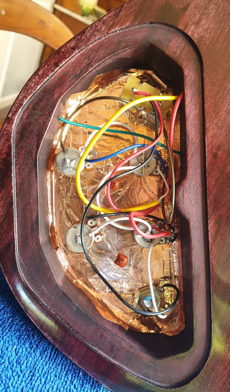

    Just oiled the fretboard
Name:	Fretboard oiled.png
    Will do holes for backplate soon, as with finishing the copper shielding when it arrives in the mail. I like the sound thats being made when its hooked up, but there is a definite humming from interference. Might be worth cleaning up the wire spaghetti a little.
Name:	Control cavity wired.png
