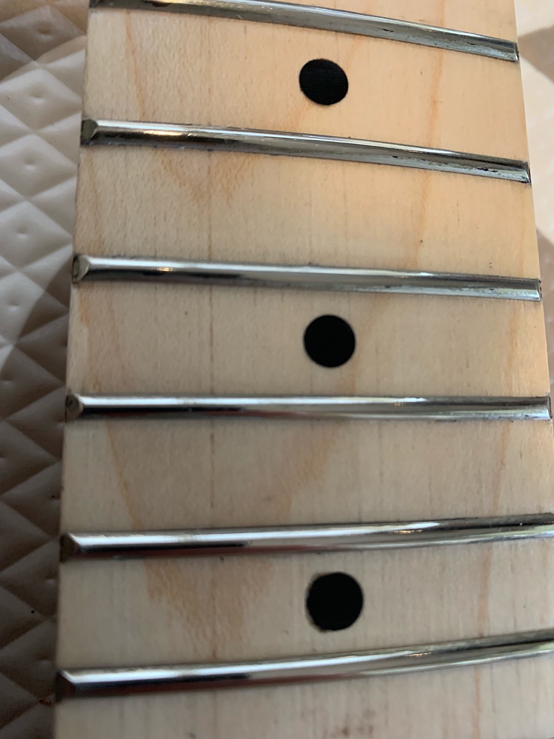

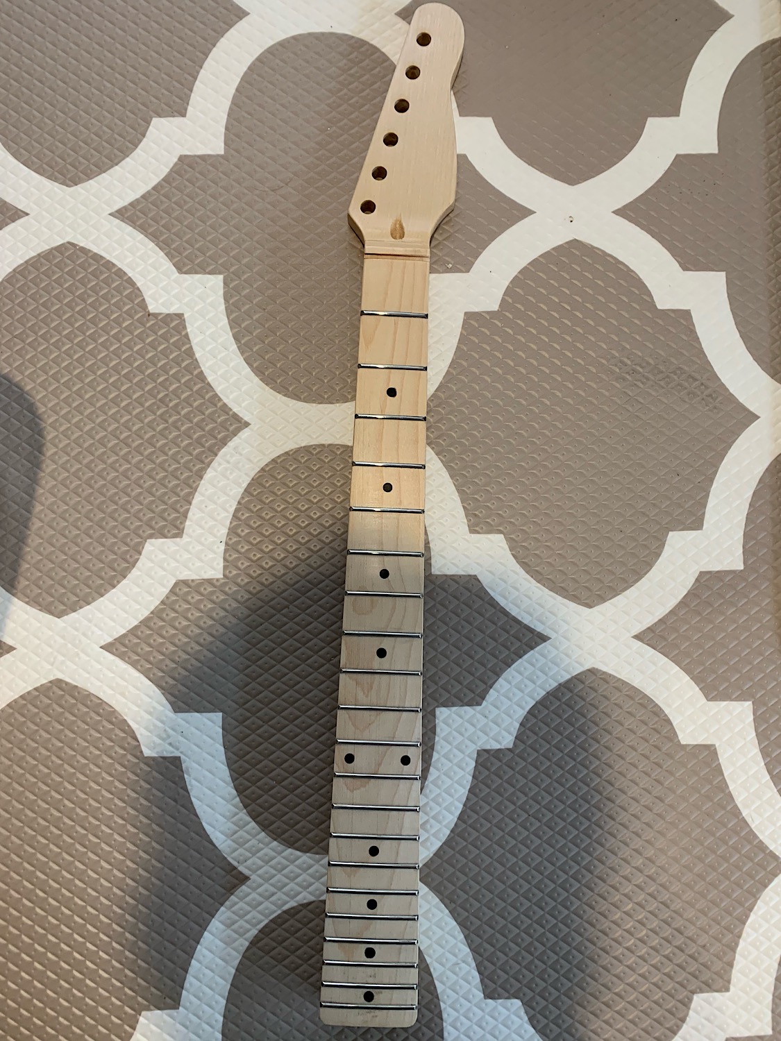

    So today I went about straightening the neck so I could level and recrown the frets.
    My basic method was what has been put on the forum many time.
    Notch straight edge to ensure it’s straight, fret rocker to check the frets, radius sanding block to level frets out and a cheap budget recrowning tool. I also used some fret erasers and a dremel with some polishing compound.
    I got an amazing mirror like shine across the frets, but will need to go back and take out some small marks left by the crowing tool. I also rounded of the fret ends for an over all smother look and feel.

    Loving the slab cut grain lines through that board. Looks minted! Nice job!

    Looks pretty good for first time fret work. You're on the right track.
    I can see some of the tool marks you're talking about. One thing to consider is upgrading from your "budget" crowning file.
    A good file made with higher quality steel will make a huge difference. The harder steel will have sharper edges on the "teeth" (and keep them longer too). Sharper, harder teeth remove the fret material much more smoothly (and with less physical effort).
    I upgraded to good quality files after my first level & crown, and the next one was soooo much better and easier. I think I ended up re-doing the first job with the new files and the result was chalk & cheese!
    Also, be conscientious of your stroke. Try to get smooth full strokes across the whole length of the fret using as much of the file as you can, not short sharp strokes using just one section of the file. And definitely not a back & forth "sawing" action (hopefully that makes sense)
