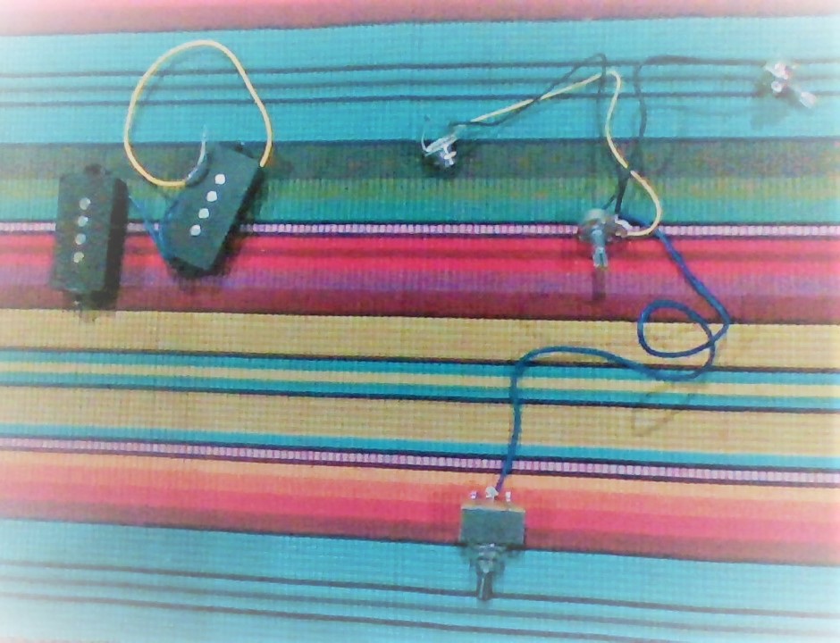

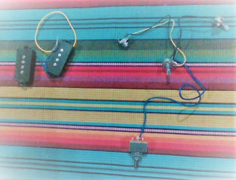

ID:	31653 sorry about the quality and constantly changing my posts
    so what i did was go off and look at all the wires and i believe that the diagram Woltz has provide is right.

    Is this the layout you're wanting?

    hello again. so i have done a mock fit of the electrics and have a major issue. the cord connecting the back pickup (next to the saddles) is not long enough to reach the three way switch. the front two pickups (near the neck) can reach it with ease but not the back. so my question is what do i do?
    Quote Originally Posted by PHILLIAJ View Post
    You can just solder another piece of wire to the end of the leads on the pickup to the required length.
    Just be sure to insulate the connection with heat shrink tubing or at least electricians tape (not the best choice but it works).
    There should be a small roll of wire that came with the kit just for this purpose and for connecting the common grounds.
    would that wire be a copper one??
    Yes. 22 or 24 AWG is fine for guitar (import guitars often use even finer gauge). I'm sure there should have been some hook-up wire included with the kit.
    If not, just go to a nearby electronics store and tell them you want hook-up wire for a guitar. Hopefully they'll know just what you need.
    It sold by the metre (or foot, depending where you're from). 1 metre (3 feet) is typically enough to do an entire guitar and more than you'll need for your project, but it's always good to have extra wire kicking around.
