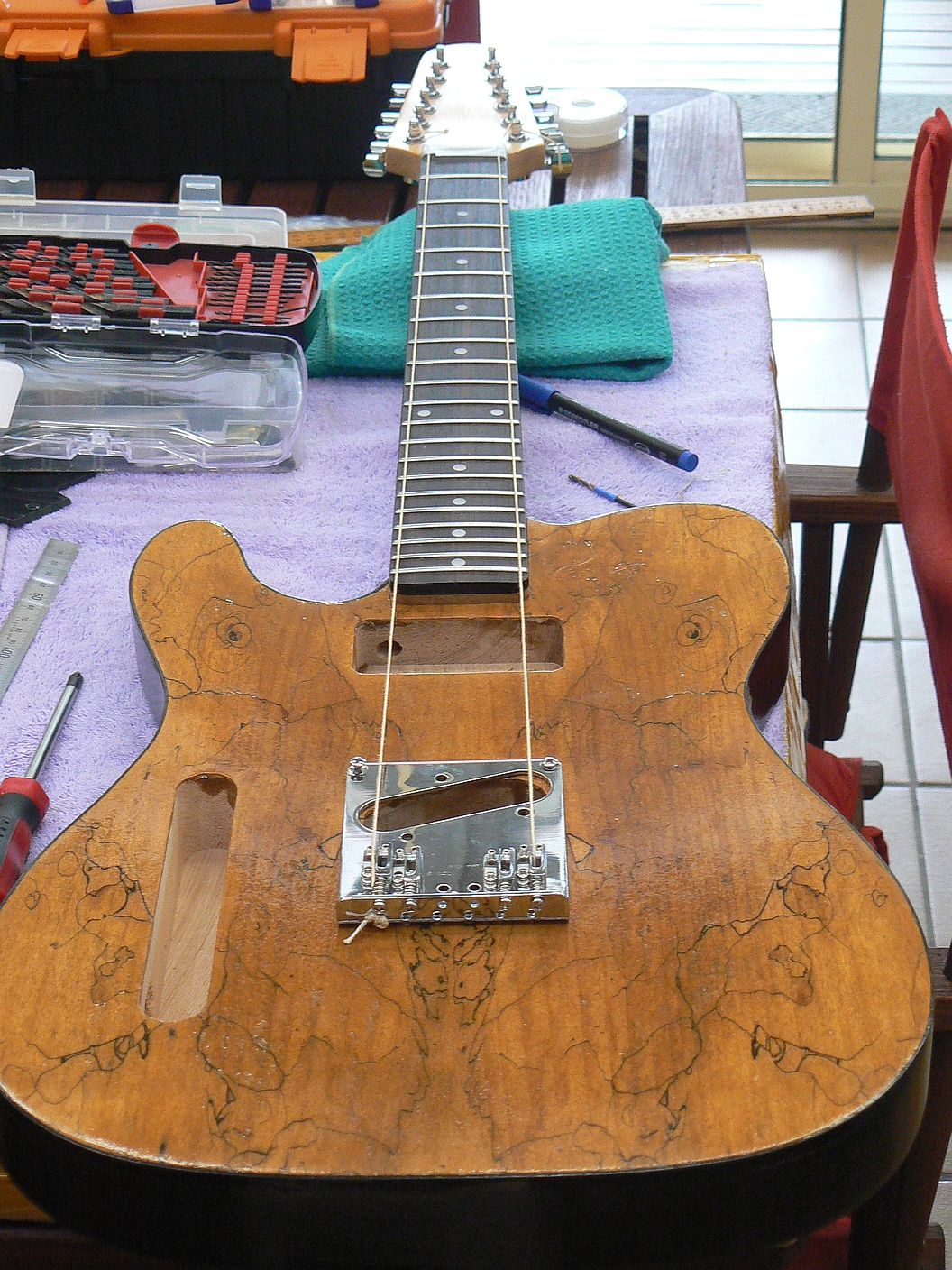

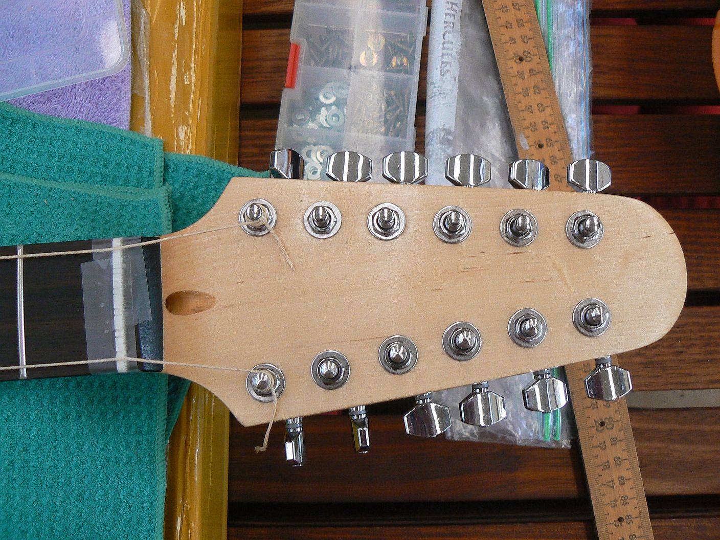

    Had to clean under the plastic nut. Taped the bone nut in place and used string on the two outside tuners align the bridge.
    Scale length looks good and Nice clearance on the sides of the neck. Had to remove the saddles to get at the screws at the back of the bridge.

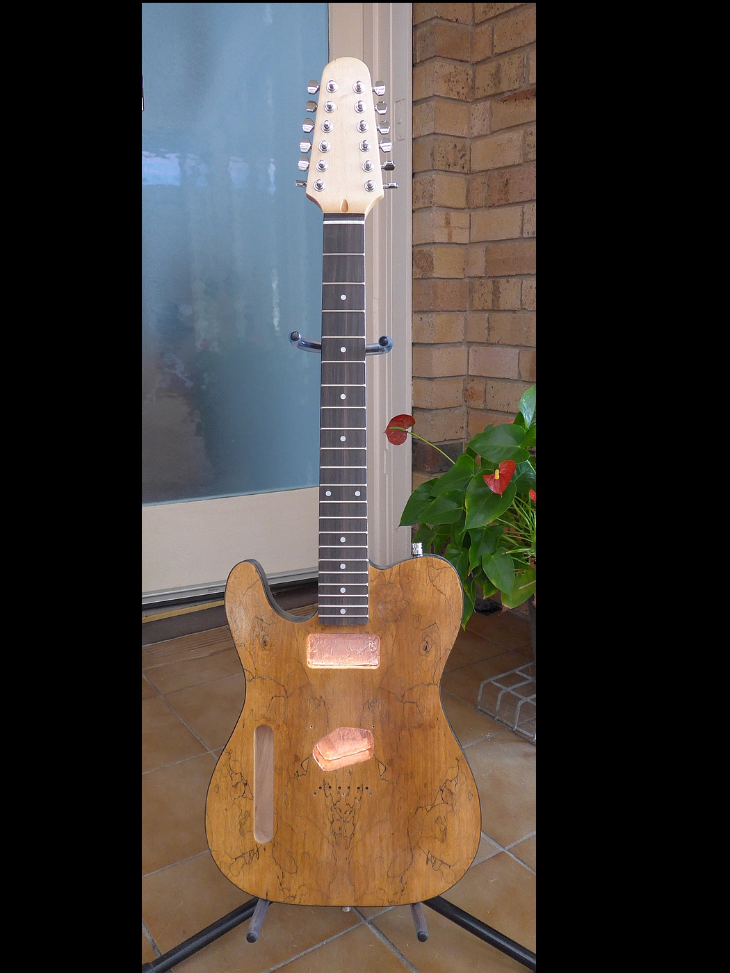

    Working on not using a pickguard. Don't want to cover the spalted veneer.
    Cut a pickup mount out of 3 ply pine to cover the large rout at the neck.
