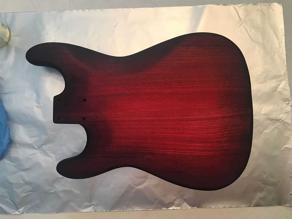

    Applied the first coat of Tru-Oil to the body today:
    The proceedings were uneventful.
    I cut the Tru-Oil 50/50 with mineral spirits and applied lightly with a piece of cloth, from the middle outward.
    The thinning help it penetrate deeper, go on thinner, settle easier and takes a bit longer to get tacky.
    Once this coat dries, I'd consider the dye locked in.
    I can then apply the remaining coats with the grain and full strength (no mineral spirits).
    There's a pair of blocks in the pickup routings to allow the front to dry so not pics of the front at the moment.

    Forgot to say, nice burst!
    That'll look great with the gloss coat over it.
    I've yet to try a hand rubbed burst with dyes. I *will* give it go one of these days!

    "Alcohol does not give you much time before its gone" - too true!
    Looks fantastic and will finish up just beautifully.

    Thanks for the kind words. I super please with the result.
    2nd coat of straight Tru-Oil went on this morning.
    It's finally lost its deep thirst. A slight bit of sheen has started to build in a few areas.
    The end grain is still flat and thirsty.
    Back to the neck plan...
    As expected, the dye mixture did not dissolve with Tru-Oil.
    However, the shot of acetone did not work any magic. It all looked like salad dressing.
    Plan B: I've shot a message to the dye powder manufacturer to get his recommendations. I will share those here when I get them.
