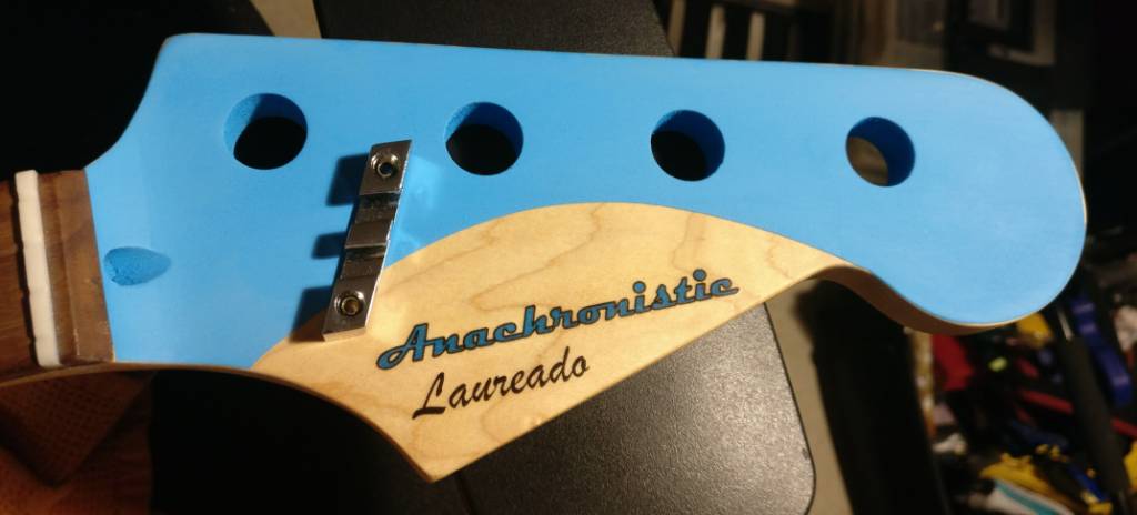

    Made some progress... I think I now have the color on the headstock and it is looking reasonably good. Put on the decal as well so that it would be ready for the top coat.
    Next project is the body...once I get the color on top and the back and sides ready, I'll order the top coat.

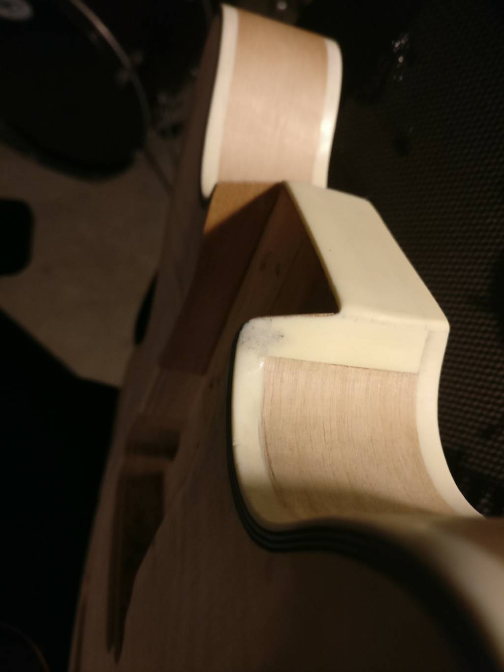

    One semi related question...I sort of built the area up around where the neck bolts on with binding material... But there is one place where it got a little discolored. I am thinking that maybe I can find a shade of nail polish that's close... Any other ideas?
    I think what happened is that I sanded the binding a little too deep. I tried to fill with cream colored binding dust (from sanding) and some acetone to make a paste. I think the acetone mixed with a bit of the black binding material that is sandwiched on in with the cream colored binding that goes around the top of the body. All attempts to fix it have failed so far... So now I am looking for a way to hide it rather than fix it. Click image for larger version.

    I like the two-tone headstock! Not what I was expecting, and the logo decal also looks great too.
    As for the binding, whilst it's not perfect, it's not that bad. If it's set up solid and not gooey, I'd just leave it.
    Given where it is, I'm sure you are the 1% that would even notice it and that's mainly because you know it's there!
    I think any kind of cosmetic cover up, could make it more noticeable. Maybe someone else has a sure-fire method to hide it but IDK.

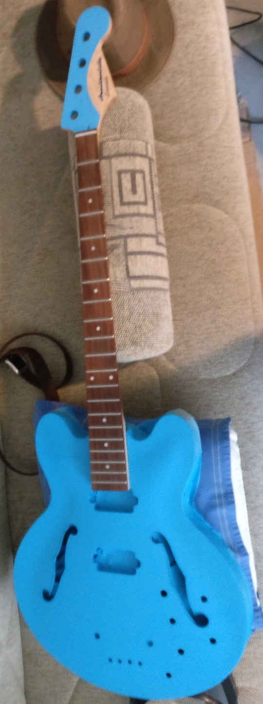

ID:	31642 I painted the top. Still planning to do the back and sides natural if I can "Si dios quiere" as we say here in Miami. I know the pic is blurry, but that's how everything looks in my garage ;-) It at least gives an idea what I am going after if you imagine the back and sides done in natural.
    This has been an exercise in patience...something I don't have a great deal of. I am discovering that being impatient leads to a need for more patience, however.
    I put on six coats. I am hoping this paint works well with my topcoat. This is a water based rattle can paint called MTN 94. I do my painting outdoors, and it is hot and humid here. I have found it to be very difficult to get a good smooth paint cover with any kind of spray paint. This is no exception. I get that sort of "sandpaper" finish or orange peal at least somewhat with every coat. There is also some splatter. I have seen other complaints on the internet about the splatter with this paint, however it turns out not to be much of a problem, as I will note below. Also, the coats seem to melt into each other like a lacquer which is good.
    My difficulties in gauging necessary drying time and a few other questions caused me to write to the company. They told me that (a) the paint dries enough to put on another coat in 10-15 minutes. HOWEVER the paint will not be completely dry for about 7 days. On my tests I discovered that I could put on 3-4 coats, but it was a bad idea to sand for at least 24 hours. I put 5 or 6 coats on the body and that (I learned the hard way) slows dry time. Humidity could be a factor as well. It's super humid here right now. So even waiting two days to sand was not completely satisfactory, and in one place, trying to get the finish completely flat, I sanded all the way through.
    So those spots got another 4 coats today, and the whole body got at least one more.
    Now the good part. The company says sanding with 320 grit is perfect, but I have now dropped to 400. Once the finish is completely dry I can get the finish VERY flat with 400 even in spots where there is splatter or sandpaper feel. If it is not completely dry it tends to ball up and create lumps, but that is my fault for not waiting, not the paint's... If I wait long enough it sands very flat and very easily--better than any paint I have used thus far.
    There are at least two other cool things about this paint. I tried it on bare, sanded pine. I used some filler but no sealer or primer. After a week the paint is super hard, and sands beautifully. I asked the company if this was OK. They said it works fine without sealer or primer, but may take more coats to cover. In reality it covers completely in two. I have added the additional coats to have a good amount for sanding. On my test blocks of pine the finish seems darn near bulletproof.
    This paint is "low velocity" so you have to hold it close to the work...but I have yet to make it run. Making spray paint run has never been hard for me. I have a great talent for it. This is the first time I have ever used a rattle can to paint without getting a single run. I don't think I have gotten much better at painting so it must be the paint.
    The other thing I discovered by accident. The guy I bought the paint from told me to shake long and hard because this paint has a lot of solids. I had to sand back my first coat in places because I found some flaws that needed to be filled. I filled them with acrylic wood filler, and then put on 5 coats. After the first two I could see that the flaws, while better, were still visible. However, after 4 coats they were gone. I put on 5 or 6 altogether. Even when I sanded flat there is no sign of the flaws. In other words, there are enough solids in this stuff to actually do some filling. I have had primer that *said* it could do this...but didn't. This is the first paint I have ever used that could actually fill.
    Top coat arrived in the mail today. Hope to experiment a little tomorrow. Both the top coat mfg and the paint mfg told me the same thing... It should work, but I need to make sure that anything I put the top coat on is COMPLETELY dry. We shall see how my patience fares...

    How'd you go with melty binding? Were you able to fix it up better, or did you leave it as it was?

    My daughter had some nail polish that was very close to the right color. Not perfect, but better. Another of my daughters likes to remind me little flaws are a reminder that its not a factory produced clone.
