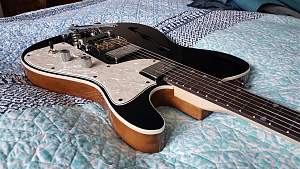

  3. #23
    Mar 2019
    42
    Ok guys, time for some updates.
    I've had a good Easter break and things are now moving forward. I go the first rounds of paint on to the body this weekend. Now it's time to let things cure for a week and then on to some flatting in preparation for the final colour coats and a nice, smooth, glassy finish.
    I'm stoked to see it appearing in final form.

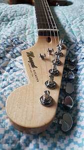

  6. #26
    Cabots satin poly is really nice on necks (I致e used the spray, but I知 sure brush on would be fine, they are good products.)
    It however did not work for me doing water slides. The satin finish means it looks cloudy where ever it痴 supposed to be clear.
    A cut vinyl decal is a good option, you can get them made pretty cheaply by most sign places.
  7. #27
    Mar 2019
    42
    Cheers Sonic, good advice.
    I have already ordered a custom waterslide from Rothko & Frost, so I either have to junk it or explore ways around the problem.
    I'll sleep on it and do some testing on scrap maple with duplicolor acrylic.
    One interesting point - the acrylic I sprayed on the rear of the body (directly over the timber stain) has come up more satin that gloss after the first coats (first coat and then a top up after it flashed off). It may be possible that the neck would do the same as long as I limit the coats.
    Anyone else had experience with wipe on poly and waterslide decals?

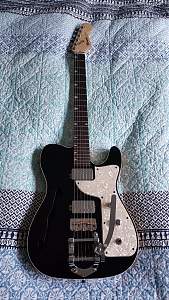

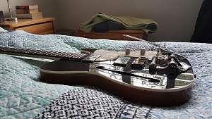

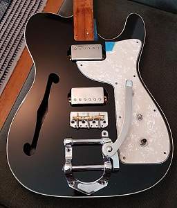

  8. #28
    Mar 2019
    42
    Hi folks,
    A bit of radio silence from me, but much progress happening:
    - I've almost finished the neck.
    - I am adding lacquer coats to the body.
    - I've designed and templated a pickguard.
    - I've finalised the hard mounting of the humbuckers.
    I have ordered a water slide decal from Rothko Frost, but they seem to be having trouble with delviery - first one lost, second one MIA.
    Does anyone have a recommendation in Aus for this kind of thing?
