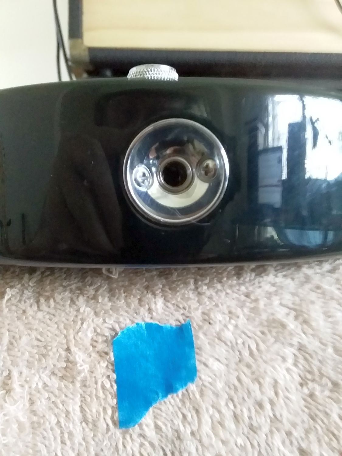

    Finally, after drilling the mounting screw holes, the new Pure Tone multi-contact was screwed into place on the new Electrosocket mounting hardware, then I soldered the black ground wire onto the ground terminal on the new output jack, and the white wire on the tip terminal of the new output jack, here's what it looked like after the two mounting screws were put back into place:
Name:	Job Done_resized.jpg
    Lets have another look at the new Pure Tone output jack.....
Name:	New Jack_resized.jpg
    Notice how it has two contacts for the tip and two contacts for the sleeve (ground) connection?, the advantage of that is that the contacts are less likely to go lose over time, so there'll be less crackling noises, and no signal drop-outs, I don't know why all electric guitar come with these fitted as standard, I'll definitely be ordering more of these from Stewmac in future, oh by the way....everything is working perfectly first time on my Mexican Tele, the tone even seems to sound better too.
