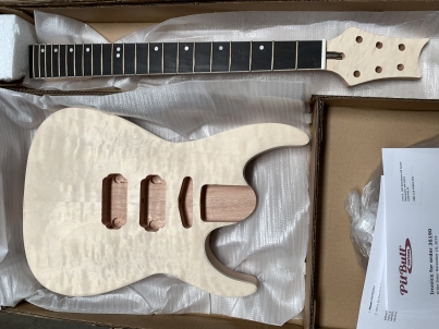

    So, the kit has turned up. They've given me a quilted maple veneer instead of Zebra Wood, and the neck is bound. As usual Adam was a total champ about it and offered me a substantial discount.

    I've taken it to a local luthier who had advertised he was still open for business so long as social distancing was observed.
    On his advice I'll be getting a bit of a burst around the edges due to the veneer not quite meeting the binding all the way around. He suggested an acrylic finish which I've blindly agreed to. Neither of us are fans of Nitro and he was sheepishly backing away from using poly for some reason. He went from poker faced and business like to having his spirits visibly lifted when I asked for a satin finish. I take it that's quicker/cheaper/easier than a gloss?
    He's pointed out some frets aren't seated properly and most need filing (sliding my hand across the bottom of the neck was like reading braille). He's confident the binding won't present too much of an issue.
    We'll be throwing in a coil split switch on the humbucker just because we can.
    I have high hopes for this guitar. It's a decent slab of mahogany with some decent pickups being put together by someone who knows what they're doing.
