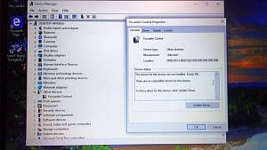

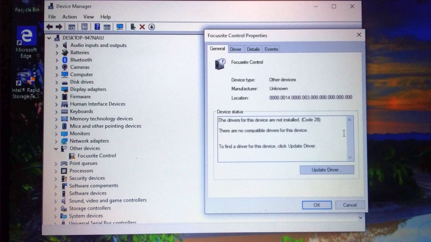

    It happens when playing back audio from any source on my laptop, be it mp3s, wavs, cds, system sounds, Daw software, apparently from what I've read from visiting a few online forums, I'm not the only Scarlett 2i2 owner that's experiencing the crackly distortion sound issue, there's also some 2i6 and 18i8 owners experiencing the same issues, I've just plugged my Scarlett 2i2 into a spare usb port after doing yet another clean install of Windows 10 on my laptop, I haven't installed any of the proper Focusrite 2i2 drivers yet, I can occasionally hear some slight crackling, I checked in Device manager and it gives the following error message for Focusrite control:
Name:	Device Manager Screenshot_resized.jpg
    The crackly distortion audio issue seems to get worse after installing any version of the Focusrite 2i2 driver software, funny enough, when I use my Scarlett 2i2 with my desktop pc the audio is crystal clear, so, I'm wondering if there's some weird hardware compatibility issue with the 2i2 and my laptop?
