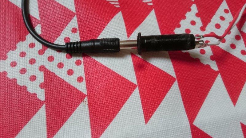

    Thanks Frank,
    It really helps to know others did the same as I'm planning to do .... With trepidation, I tread the same path ! (Dremmel in one hand, and small flat chisel n the other).
    Does the plug - jack connection look normal ?
    (Is this a stereo jack or something ?)
    I bell'ed out a mono plug connection and apart from the amount of 'plug' hanging out of the sock, I'm good to go with this ...

    Thanks again for the replies !

    Just remember, little bits at a time, one or two passes then test fit. When I pared down the cavity wall, i marked a dowel to indicate where the jack threads would end and also where the edge of the entry hole sat on the dowel. I kept paring, then replaced the dowel to gauge how much more i had to remove to engage the thread with a washer in front of the nut.
    I think those jacks are stereo, but used with only a mono connection. That one looks like a shorter version, there should be some form of rubber/plastic washer behind that flange though, to help it seat securely against the bottom of the hole in the body.
