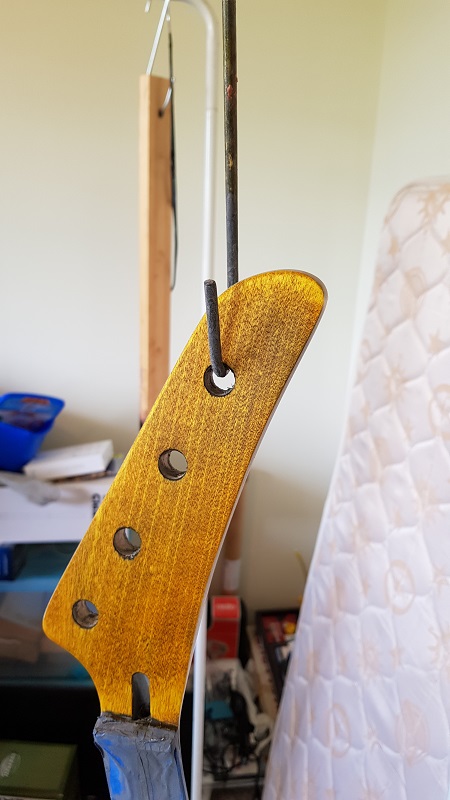

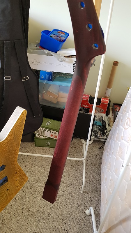

    First Colour
    First wipe of Feast Watson Golden Teak on the body front and headstock front. Found a sanding and timbermate tide mark on the body...bit of 240 to attack that I think.

    Now the mahogany on the neck
    One wipe of mahogany on the neck....still wet.

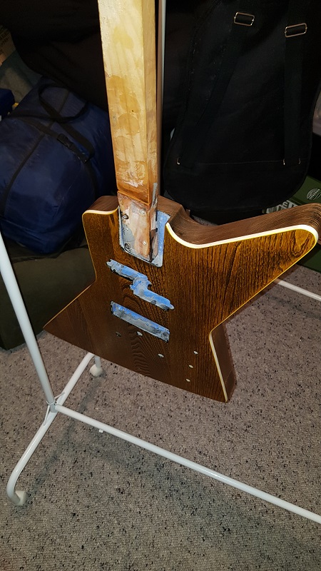

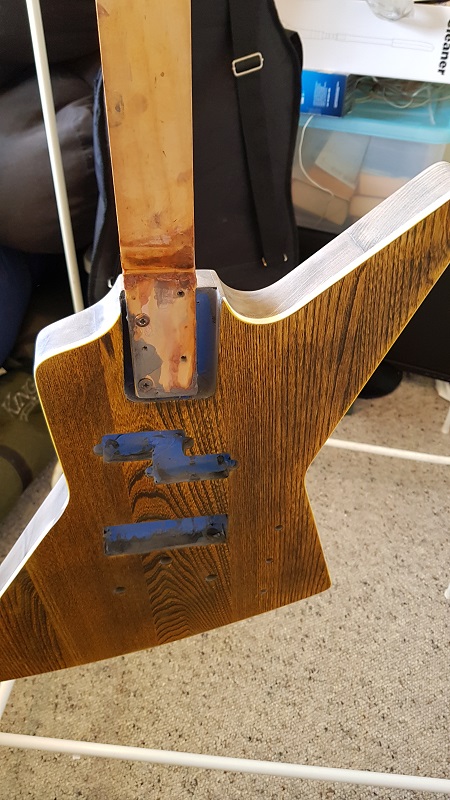

    3 Coats of Tru Oil
    Flash used...so no real proper indication of colour and grain.
    But here she is with three coats of Tru Oil....still wet from the last one.
    I did Feast Watson Golden Teak on the front of the body and the front of the headstock. I did Feast Watson Mahogany on the rear of the headstock and neck, and on the rear of the body. I left the edges of the body with no stain.
    All over has had two coats of Ebony Timbermate sanded off at 180grit then the second coat at 240 grit.
    So far, stain at 240.....will do about ten coats of Tru Oil and then a wet sand with Tru Oil....400 or 600 depending on how the surface feels.

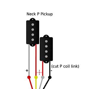

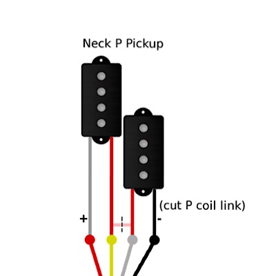

    P vol with series/parallel coils, bridge vol with humbucker/split, and master tone with P & bridge parallel/series link switching is very doable... maybe even with an optional extra twist.
    The biggest question is: are you willing to snip your P pickup?
    The short link wire between the P coils (standard on most P’s) will need to be cut and extended with wires if you want to do series/parallel switching on it. Like this:
    If so, I’ll sketch out a layout for you.
    Yes I am a fan of the snip.
    I have this push pull series/parallel option on a number of basses. The difference is very noticeable on Seymour Duncan quarter pounder....not so much on Tone Rider Precision Plus pickups. Interested to see how the Chinese pickups go.
    So weirdy...bring on the chop chop chop.
    Thank you again. 😎🎸🎼🎶

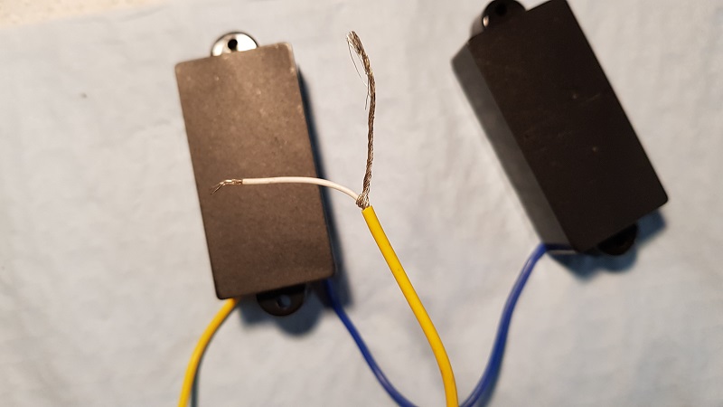

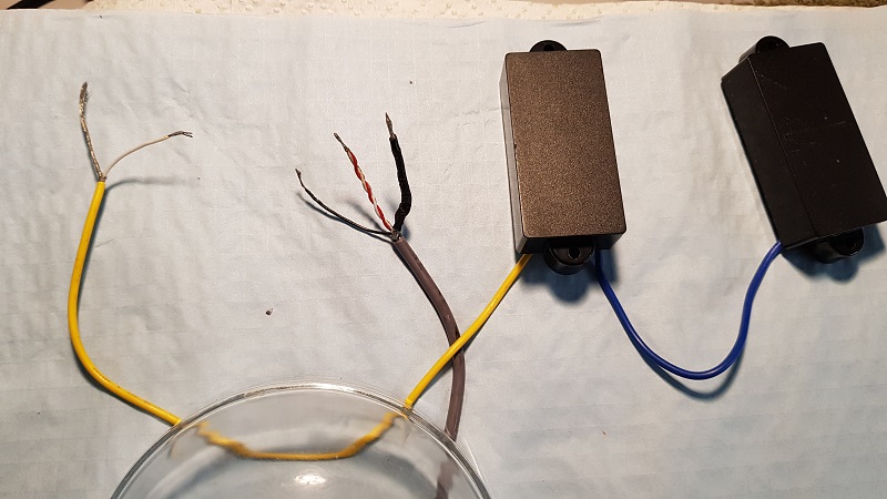

    These are the kit pickups that come in the box.
    The humbucker appears to have the black separate, the red and white twisted together and soldered....and I assume the green and bare are twisted together and soldered under the shrink wrap.
    The P Bass pickup has the blue joining wire, and the yellow wire that contains the white hot lead and the bare earth lead.
    Photos for you. Thanks very much again again again.
