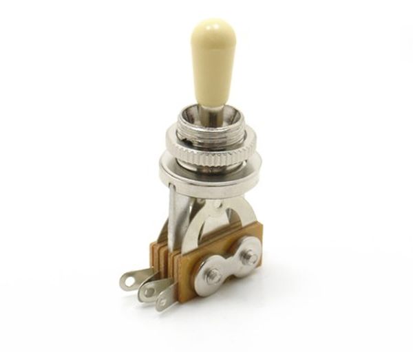

    Might as well peer a little deeper into the can of worms and seek some opinions on upgrade switches whilst we are in the neighbourhood. Jack sockets too perhaps?
    Not a fan of the box style 3 way switch that comes as standard with G style kits and also found on some F styles too. Generally find them quite noisy when selecting different pickup combinations and have mostly upgraded with a Gotoh type thing like this one....
    Not on any endorsements or deals with Real Parts but they are a better and safer bet than eBay and the gear seems to be quite good quality for the price, $10 bucks for the one in above shot plus postage.
    As for Strat & Tele those box style blade/lever ones seems to be OK for a while but eventually start playing up too. Have installed a couple of 4 way Oak Grigsby's in both Tele's and they worked fine when initially installed but lately I am lucky to get 2 out of 4 positions actually working? Need to find time to open them up and check things out, probably just shorting somewhere as they are so deep and there is not much room or depth in a Tele control cavity.
