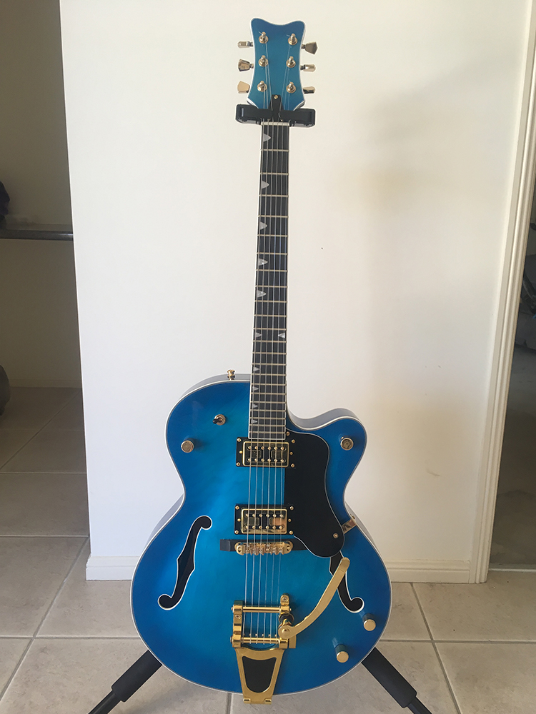

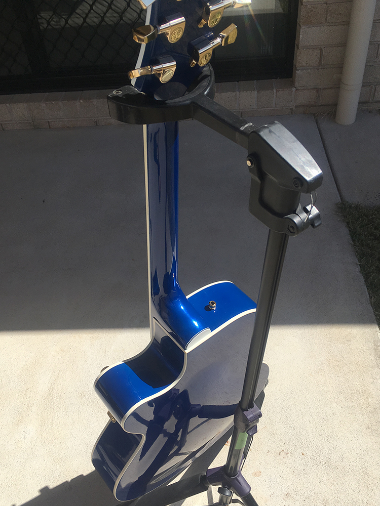

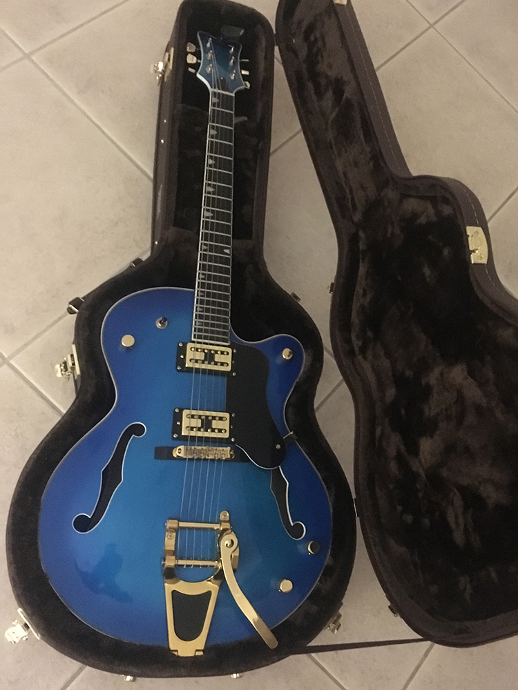

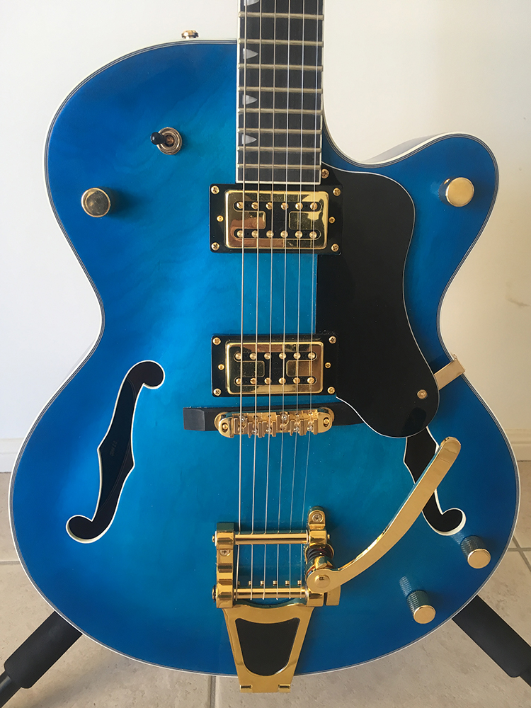

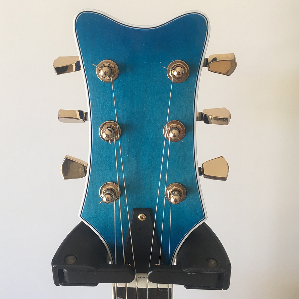

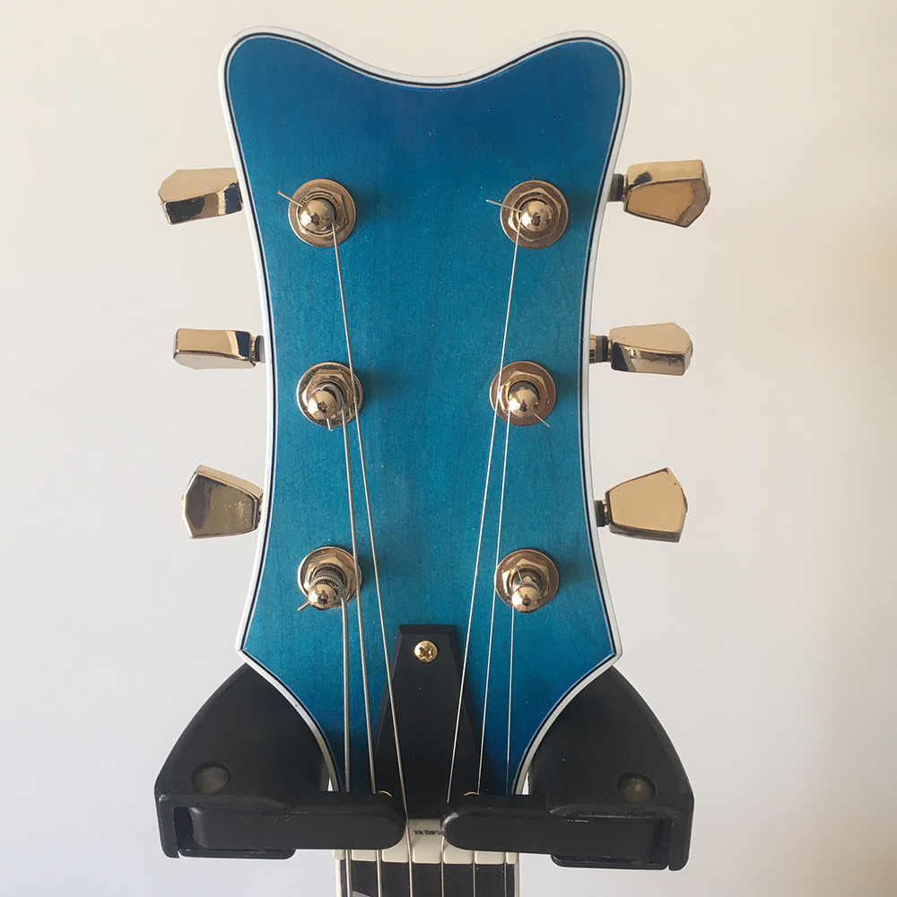

    Entry from Steve G. GR-1SFG "Blue Bird"
    Mods to the kit,
    • Fitted binding to the head stock,
    • Ebonised the fret board using Kiwi liquid black shoe polish, works beautifully,
    • Raised the neck in the body to allow me to fit a timber bridge under a roller tuneamatic,
    • Fitted a Tusque nut,
    • Extended the heal on the neck and capped with binding,
    • Replaced the 2 linier pots with audios for smoother roll off,
    • Finished with automotive acrylic lacquer, I used clear acrylic lacquer to seal the timber. Translucent burst on the top and head stock, (60% clear,20% pearl and20% colour then 6 coats of clear), Solid colour back sides and neck (Grey primer, 80% colour, 20% pearl plus 6 coats of clear). Final sanding to 2000 grit then cut polish.
    Great action great sound, I’m really pleased with the finished guitar. To protect it I purchase an Artist JC500BR Jumbo-Large Arch Top hard case, I fitted 10mm of timber flooring foam underlay into the sides and a 10mm to 20mm contoured velvet covered foam packer under the body. The guitar fits beautifully.

  3. #23
    Wow, that's a pretty pro looking effort.

    Steve G’s "Blue Bird” GR-1SFG
    The blue shading moving across the body is gorgeous. The subtle echo of grain through the sky blue of the arch top is like looking at waves for the beach from a drone above. The deep looking blue of the sides is rich and heavy. the colour is set off by it’s shine and polish. A wonderful, wonderful effort.
    This guitar looks opulent, expensive and says Jazz, jazz, jazz.
    The only let downs for me:
    Stock TRC - This really deserved something custom, perhaps with pearl inlay to echo the fret markers.
    No logo - This is something special, that deserved a stylish logo or personal brand for recognition and accolades.
    Beautifully understated but luxurious at the same time with the gold hardware the wonderful blue finish and importantly the body cavity having a lick of black to make it like looking into the abyss.
    Unfortunately I have been unable to find a build diary of any posts about the build so I can't comment on upgrades
    Let down only by the lack of headstock logo.
    Very nicely finished Falcon. Additional binding on the vertical neck joint and neck heel work well as does the binding added to headstock. Build diary would have been good to see how it all came together. Again, not a fan of the stock kit supplied truss rod cover with plenty of alternatives out there for not much money. Missing a logo too.
    Oh for a headstock logo! I love the customisations on this, the headstock binding, the wooden bridge plate, the heel cap - and that subtle burst finish is fantastic. I am a little confused by the intonation but I'm assuming these are pre-set-up photos. Another guitar that really deserves a custom TRC though.
    love the blue burst goes great on this model. No headstock logo to say you built it, otherwise a great looking axe
