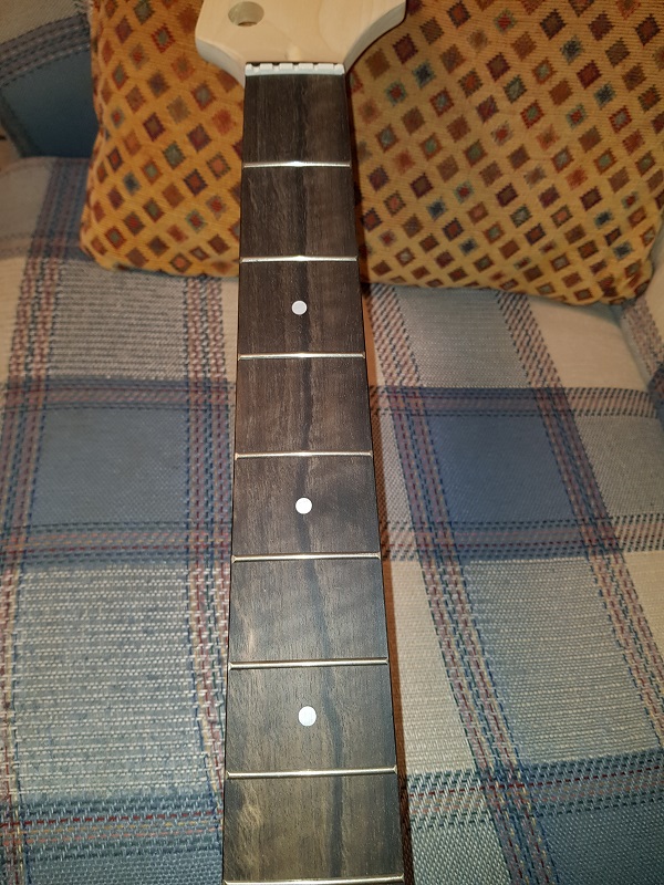

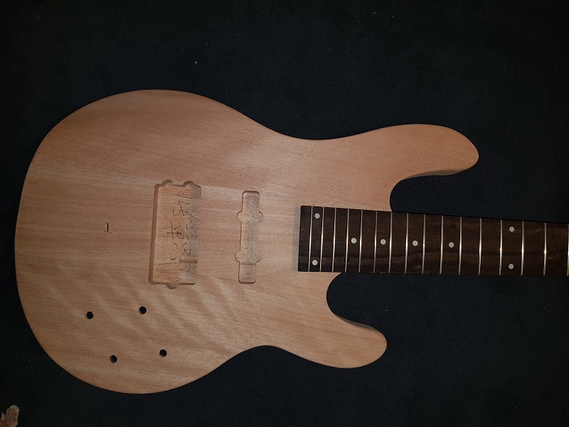

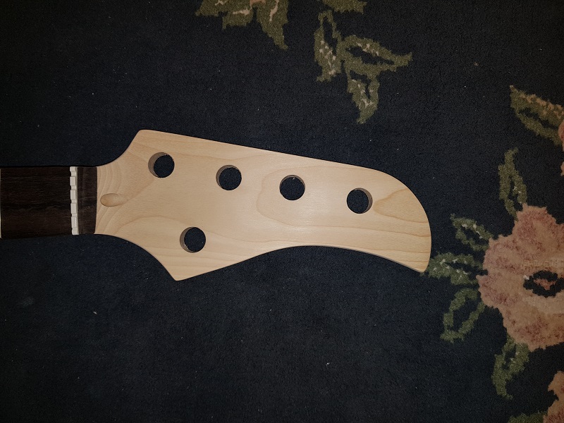

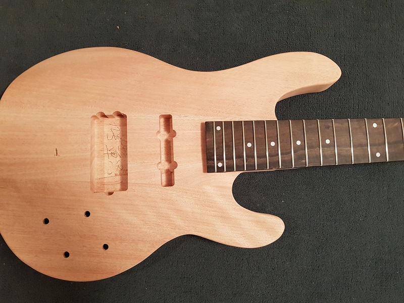

    And it does begin. :)
    The New Girl is in the house.
    My parcel guy works late to finish all his deliveries.......delivered to me after 5.30 tonight....nice huh.
    I really like the body...the fretboard has some awesome figure on it too.....possibly Ebony I think.
    The neck fits a little loosely into the pocket....but still good.
    The jack socket is on the side.....nice....black hardware too....so a Real Parts order in the offing.
    Much sanding to come.

    Not much meat left on the headstock but just enough to allow for some re-shaping into the MMB style beak.

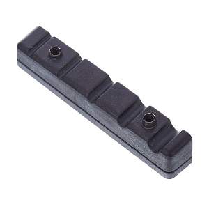

    Decent 5 String replacement nuts for F styles are hard to find. As a heads up, don't buy any 'metallic' ones from South East Asian sellers as whilst they may say Brass or Stainless Steel they are mystery metal and just coated to look a particular way. I bought a couple, whinged via Ebay and got a full refund and also didn't have to return the crap, not that they will be used for anything. On the EX-5 I bought one called 'Adjust-a-Nut' and is styled on the ones that come on Warwick Basses from Germany.
    This is the one I have and unfortunately they are more suited to Gibbo styles where they sit at the end of fret board compared to embedded in the Fret Board on F styles but not a hard mod to increase the nut slot width slightly to make one fit. They work brilliantly and sound is way better than stock plastic.
