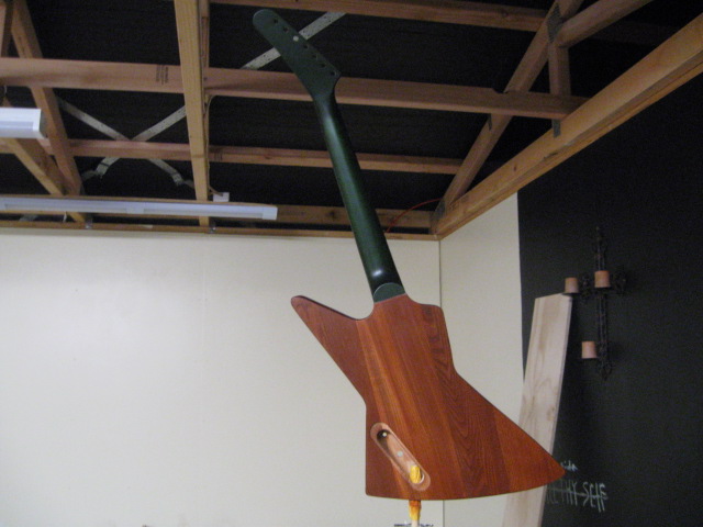

    Behold the abomination.
    I reckon it actually looks half decent, like the sprout of my guitar building adventures rising from the soil (thought that one up after the fact). Or as the old man calls it the green hornet. Liquitex sap green acrylic ink. Put an order in for some liquid hide glue because the idea of disassembly down the line appealed.

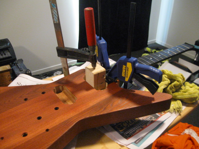

    Me being a big ol' dumb dumb head and forgetting to pad the dirty wood clamp. Shiny stuff is just a bit of water to get some crap from the clamp off.

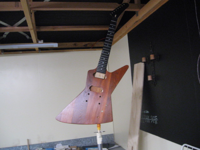

    Moved the whole lot into my inner sanctum to be able warm everything up, on account of the shed being as cold as my lack of a soul being winter and all. Left it clamped up for about 24 hours. Hopefully the glue holds, I've read this stuff can be temperamental.

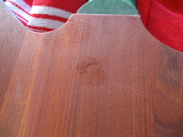

    Going to have to touch up the green a bit around the joint, there's a little bit of a gap but nothing major. Thinking of doing a wipe on poly finish. Going give the body a good wipe down with paper towels because the oil based stain has attracted a bit of dust and whatnot, unless anyone can suggest anything better.

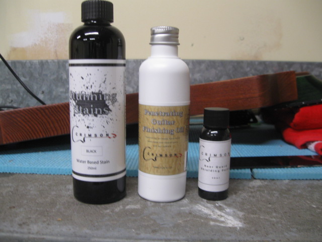

    After what seemed like an eternity this stuff showed up.

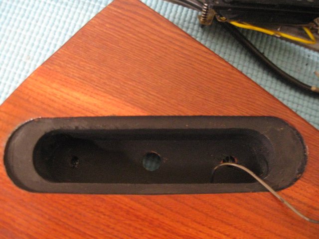

    Some stain and finishing oil for the next guitar and some shielding paint for this one (yes, I bought into the youtube hype...). After using up the majority of the copper tape doing the pickup cavity I quickly realised that paint would be a less sanity consuming option for me. This stuff is quite thick so was very easy to manipulate. It does go off after about a week so might build up a few kits first before I bother to buy any more.
    Some coins I found a work. Canadian 10 cent and an Australian 5 cent.
    Cavity shielded. Better get myself motivated to do some wiring...

    Having used the cavity shield paint on a few builds I always use it in pickup cavities but tend to line control cavity with copper tape as I discovered the control room does need a bit more protection to reduce/cancel out the hum.
