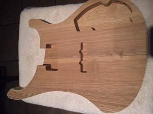

    That'a a really nice consistent grain across the front. What's the plan?
    The plan is a natural finish. I'm still debating on the tint I want it to be. I'm leaning towards a finish like the Ric that's on the first page of this thread. Something light. But I also like a dark stained wood.
    I'm definitely shopping for a different bridge. I don't want to spend $130 on a Ric replacement so I'm looking at other options.

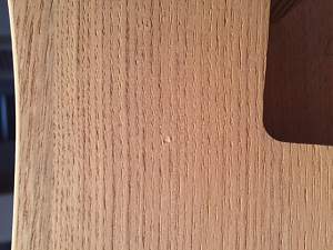

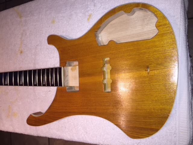

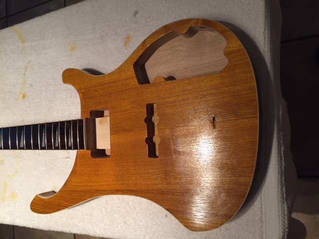

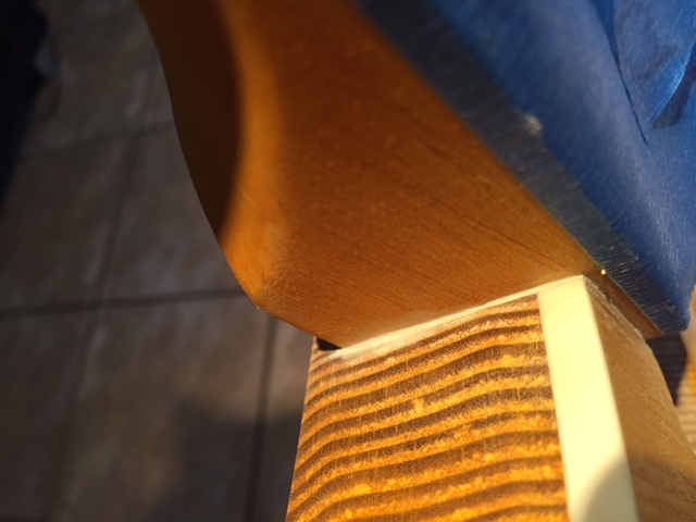

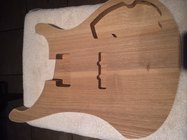

    I've just sanded up to 180 in prep for grain filling. Are some of these a result of not sanding enough or ill grain filler smooth all of these over?

    Quote Originally Posted by BJMtz View Post
    Dings like this you may want to try steaming out first.
