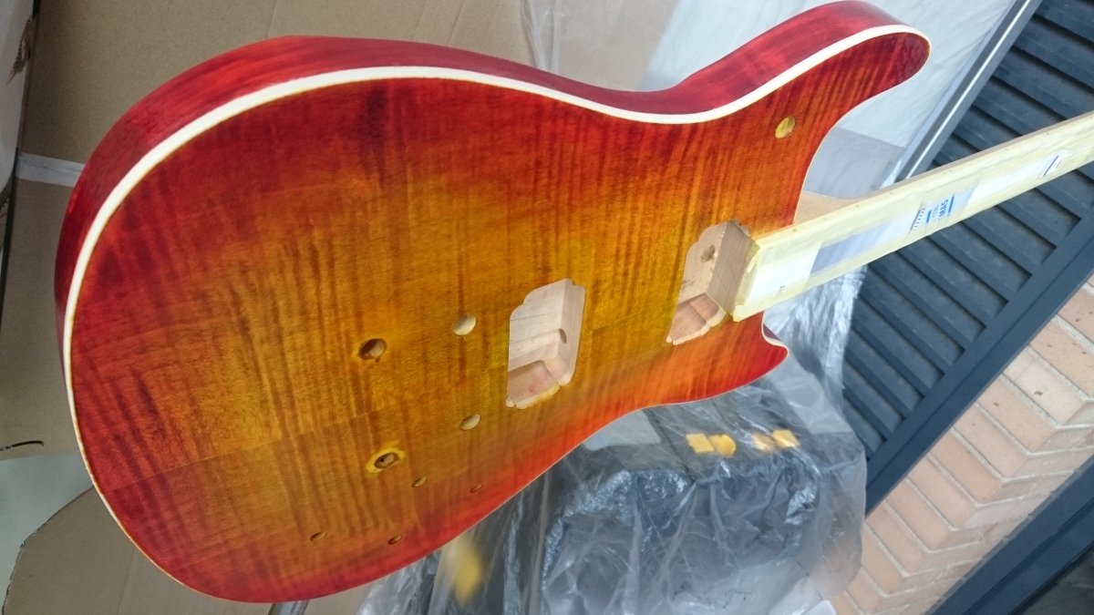

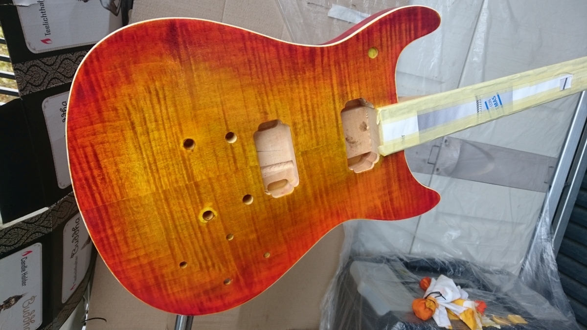

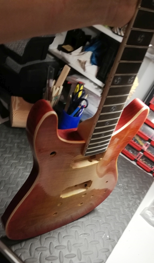

    After some weeks busy, I started the finishing. Initially I wanted to keep it simple and apply the lacquer by hand, using a cotton cloth, but soon I realised it's more difficult than spraying. I bought a spray gun.
    After the first coat, which was a little too much, I made a disaster and a drop falled down from the neck pickup route, creating a yellow stain mark. I tried to repair it with a red stained sandpaper, but the blurr is still visible. I don't want to sand the whole top and start again, so I will leave it like this. It's OK for my first project
    I am using a water based lacquer from a Nitorlack, called Nitoraqua. I just sprayed 3 coats, and for the moment looks good to me. The manufacturer reccomends 6 to 12 coats for the guitar, so we'll see. I bought Micromesh sanding pads for the polishing later.

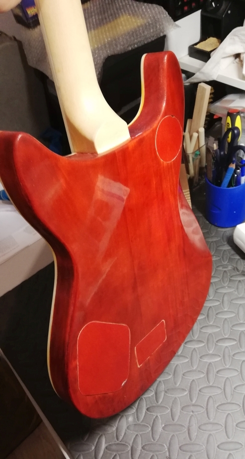

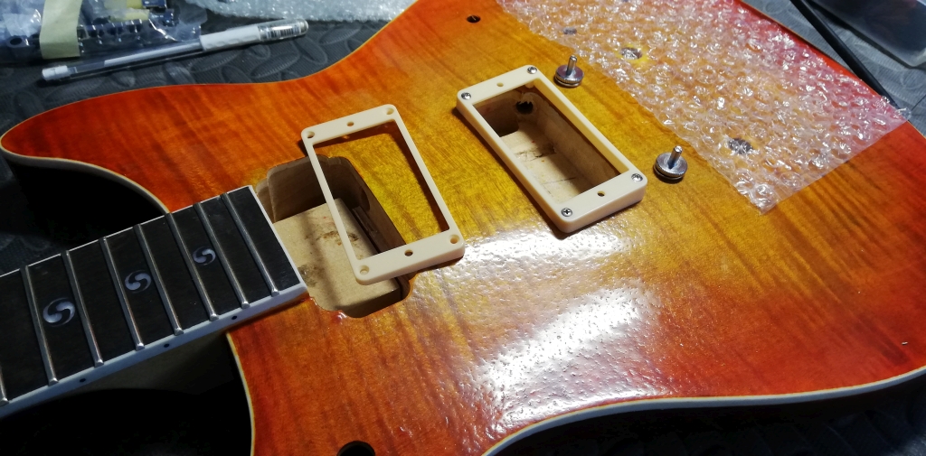

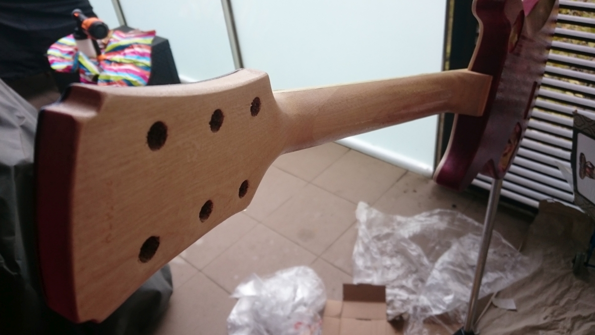

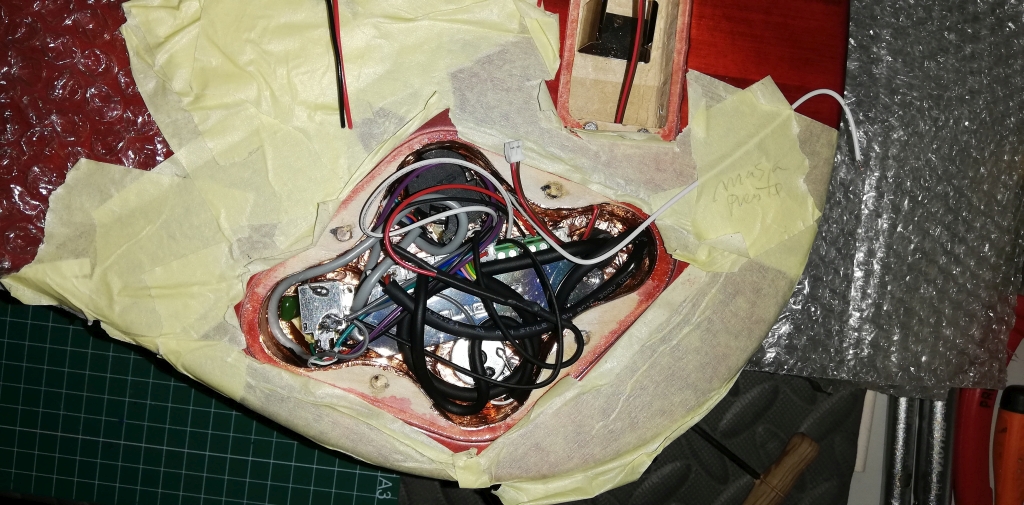

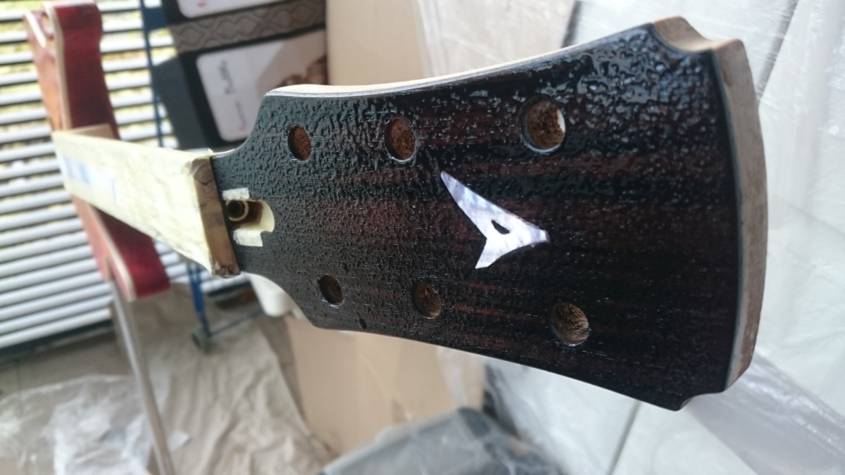

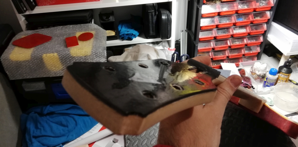

    The water based lacquer finish is complete, with some problems. During polishing I was not able to reach a completely flat surface, and some orange peel is still visible when you look close. I stopped polishing because I accidentally reached the wood in one little edge in the belly cut. Then I started final step with polishing compound and I am quite happy with the result (even more if it is playable in the end).
    I had to sand the stoptail holes because I measured it wrong: I wanted to install a Schaller stoptail which has 1 mm more distance between holes. After correction the bushings were slightly loose. To fix it quickly and leave it strong enough I glued the bushings a little bit into the body.
    When polishing, I slightly sanded too much the edges of the back covers I made. It's a pity because they were really good and lacquered, and almost match the back colour. For the moment I leave them like this. Also part of the "A" insert in the headstock is gone. If the guitar finally is playable and everything, maybe I fix it by finishing again the headstock.
    Regarding electronics: As I have a lot going on (2 push/pull pots for split coils and phase shift, the piezo bridge and Schaller preamp) It's difficult to have the control cavity cover closed just with the magnets. I'll use standard 4 screws for this cover. The other 2 (toggle and battery) keep well closed with the magnets.

    Hey Mark, thanks for your comments.
    Yes, I made some errors: I did not sand between dye coats. During lacquer spraying I had a lot of issues, some dye went out and it was a mess (the dye which didn't soaked as you said). I used a spray gun for the first time and in total I made 12 coats of lacquer. The firs ones mixed with 25% water, and the last ones 5-10% ow water.
    After 4 weeks drying, I sanded with 1000 and water, but I couldn't flatten the surface completely. Later on I will do a refinish as you said: sand the clear, add more lacquer and polish again.
