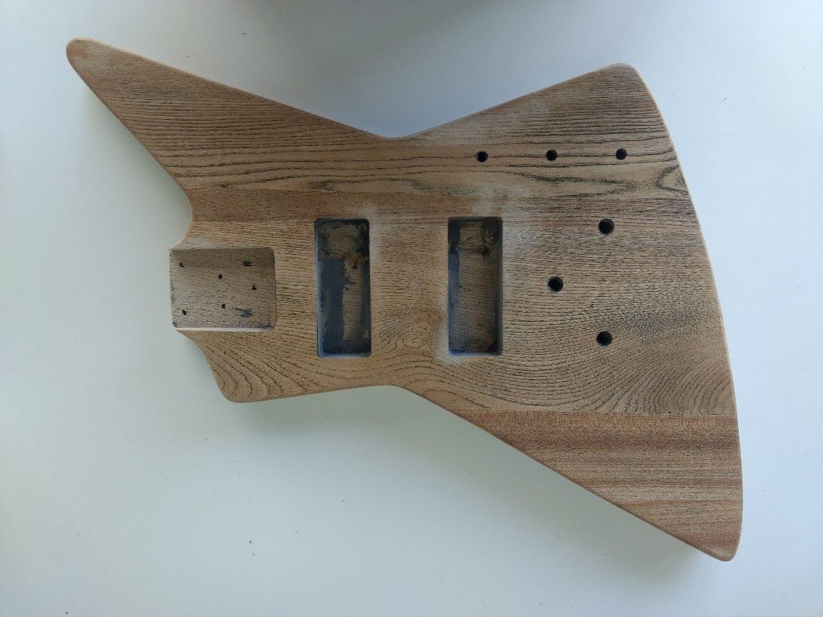

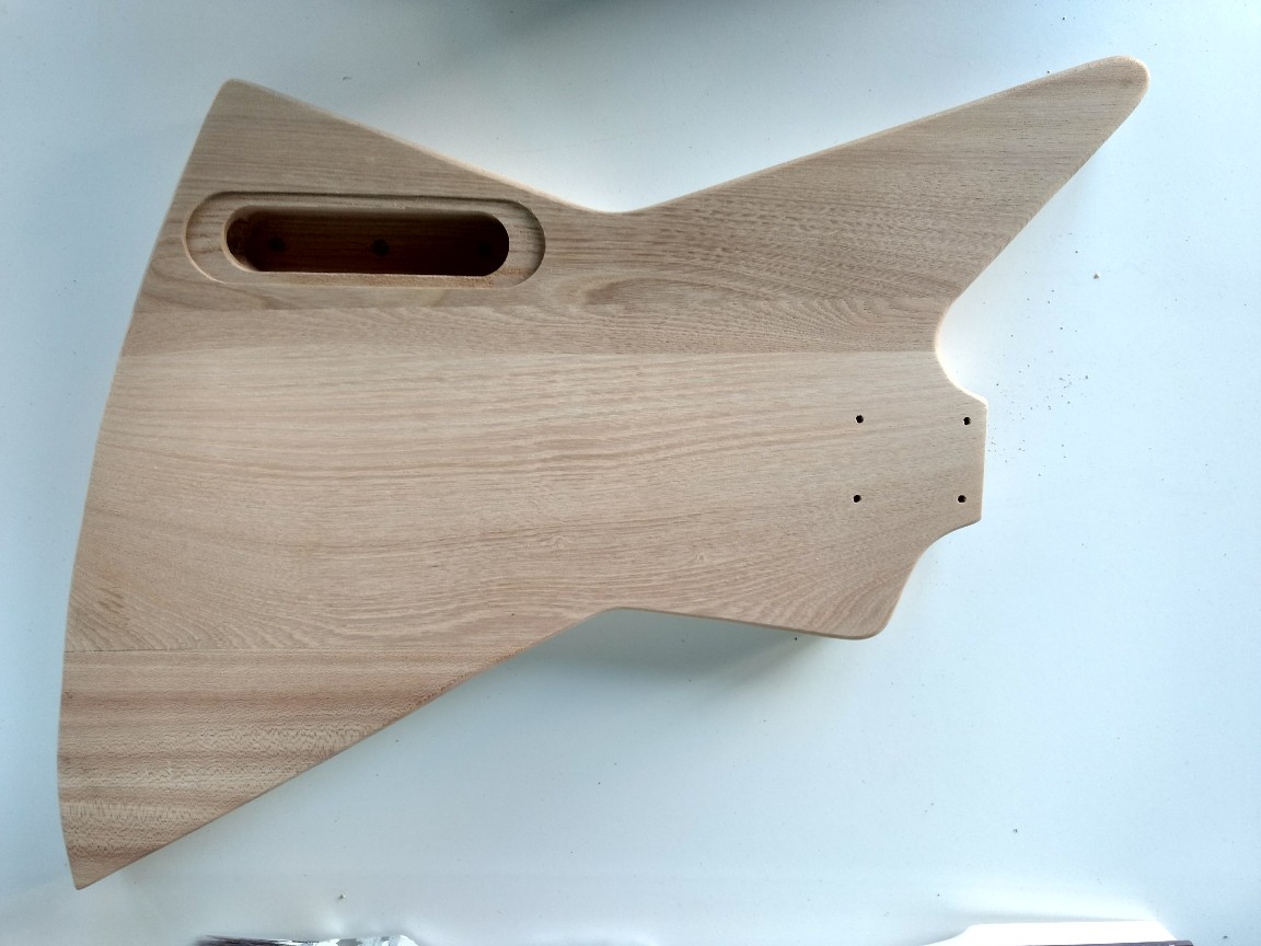

    A few more shots.
ID:	25932   Click image for larger version.
    Some amazing end grain on display. Top of rear wing has a rather sharp pointy appearance.
    Hope you didn't go too hard with 240. I would have stopped at 120, done the timber mate and then used 240 to take it back. Grain filling after 240 may not have the same effect and strong encourage you to resist the temptation to go beyond 240 before applying 1st stain coats.
    Plenty of build threads full of tales of woe wondering why the stain is not working out and it all comes down to overexuberance with prepping. If done right and with lots of patience 120 grit does a wonderful job with bringing things up nice and smooth which then only needs a light 240 dusting over.
    Yes, now is the time to get surfaces level and remove any machining marks. You want the surfaces nice and even, with no pits or dips that will take ages to fill with finish, You don't need the surface too finally sandpapered as you'll need to get all the real smoothness with the finish.
    As Waz mentioned, the two rear corners are sharp and contrast with the two front corners which are smooth. I'd be very tempted to round them off a bit to get a more homogeneous look to the body. Also, most finishes don't take that well on very pointy edges so are more liable to chipping when they inevitably get knocked.

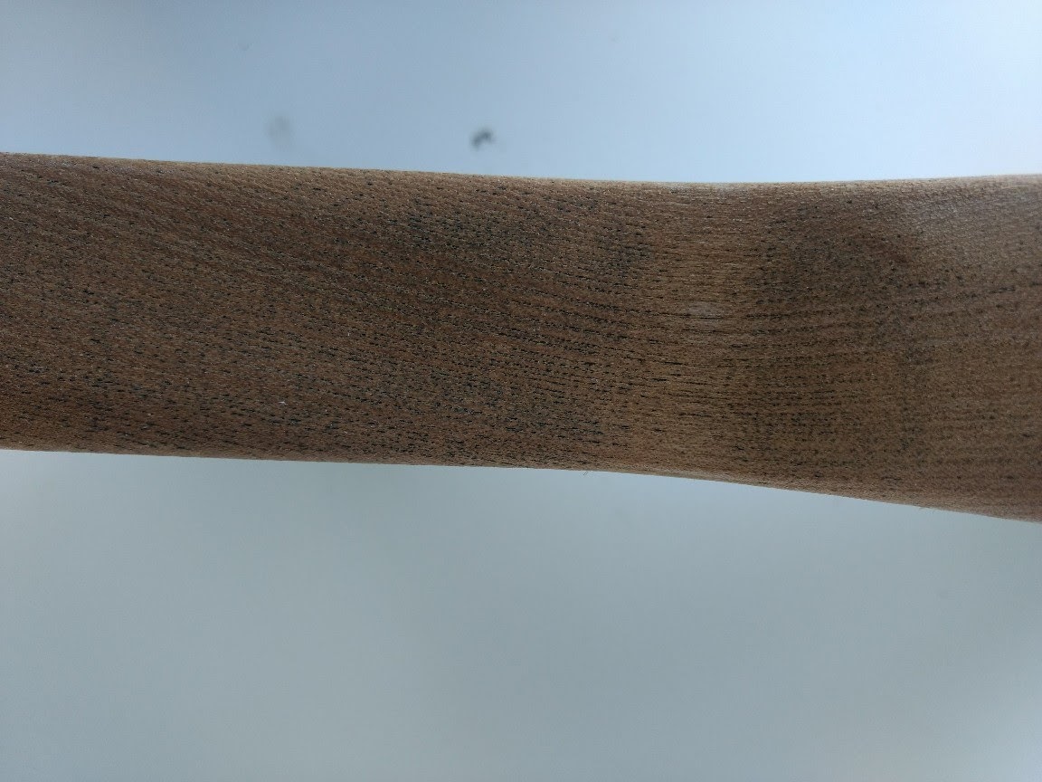

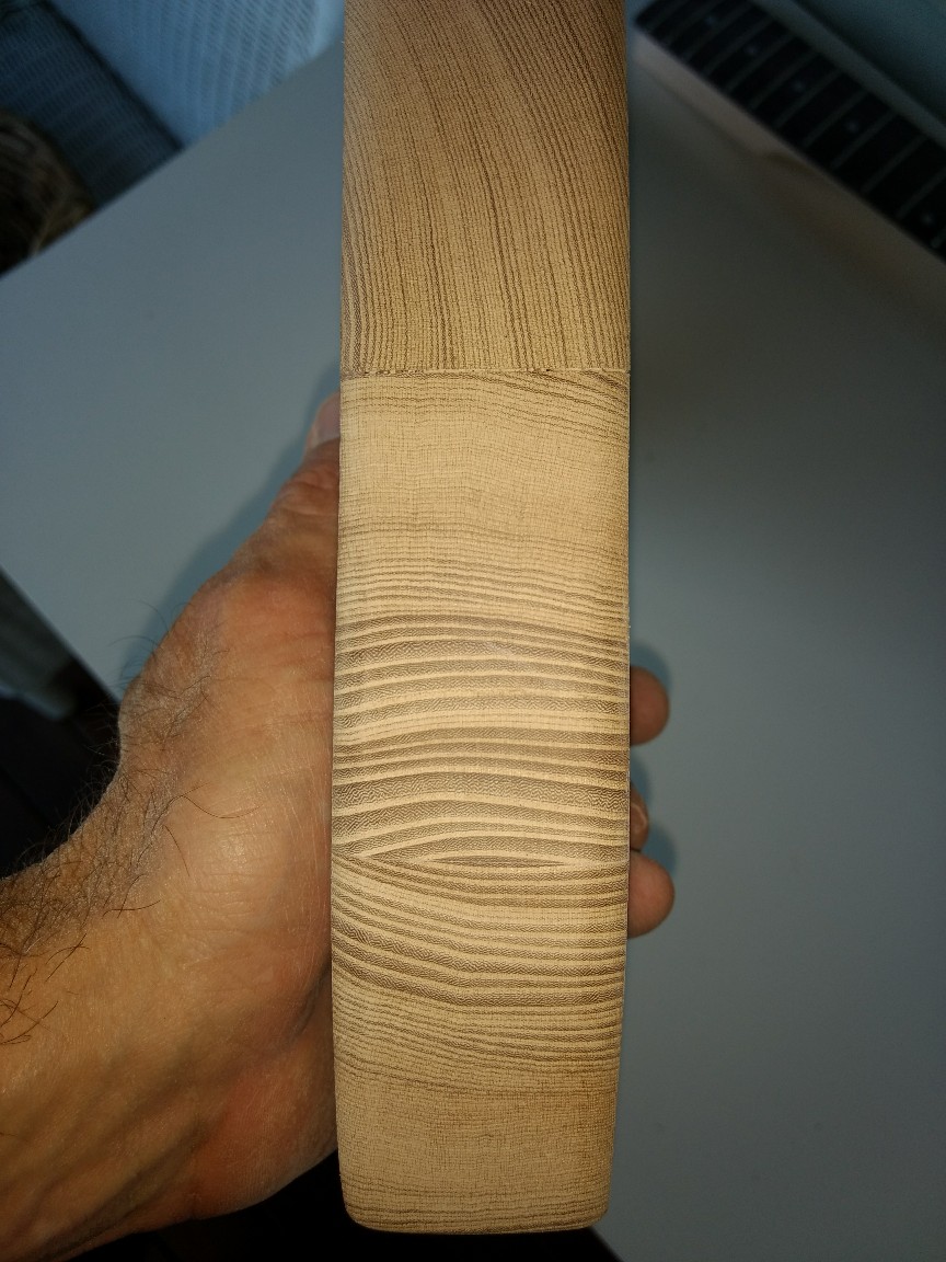

    Sanded off the timbermate today, and pretty pleased with how the grain looks. My only question is with the edge grain, it looks a bit 'dirty'. Not sure if I need to sand further, didn't really want to go too far and undo all the work.
