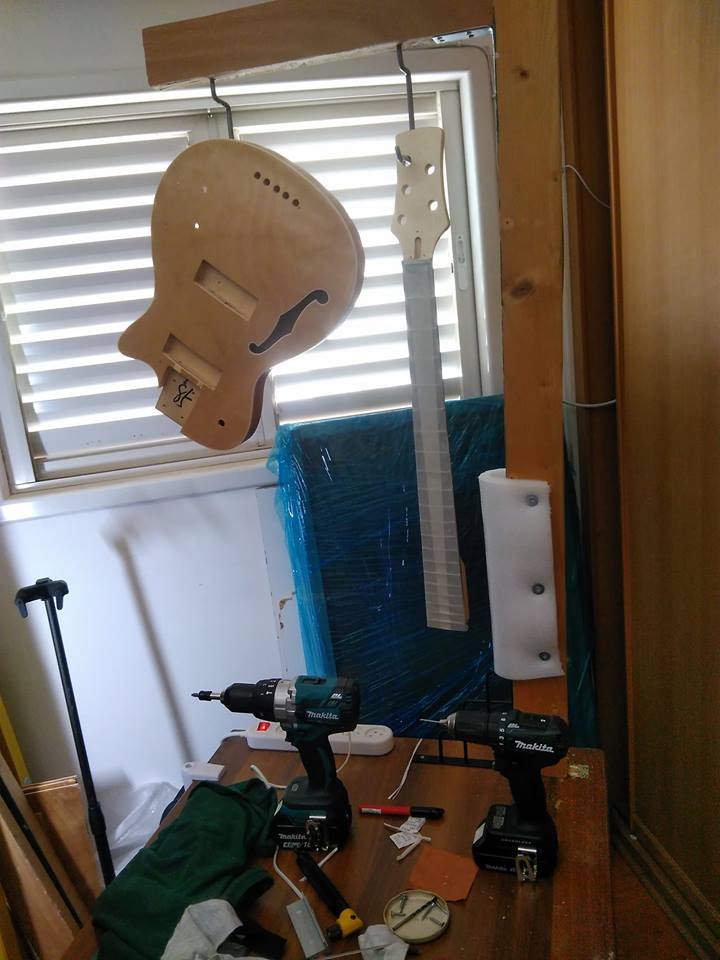

    Oh and feast your eyes on the drying rack I just cobbled together after yall's comments made me realize I have weeks to go still and I need my table clear.
  10. #28
    Nice drying rack.
    I have to tidy up from time to time and lose my workbench as well, so I sympathise.
  11. Liked by: Peace_less
