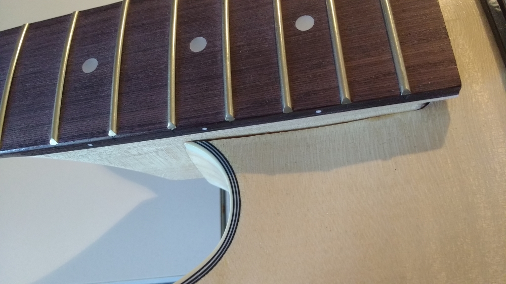

    For me, it's a bad time.. I finally survived inserting electronics inside the semi-hollow body, after a very long fight, and I just finish the last step : to glue the neck.
    But.. now I'm in big trouble..

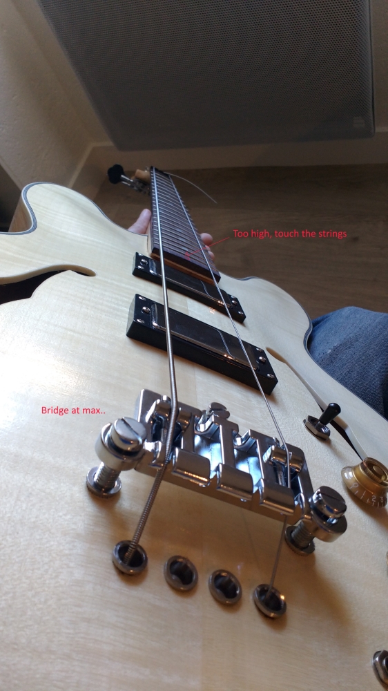

    My biggest fear comes true : the fingerboard is too high, and I can't tune the strings
    Maybe I didn't search enough but I couldn't find anything about this, especially for the ESB4.
    So : here's my problem :
    I think I'll have to unglue the neck, sand it a lot to lower it, and glue it again.
    Any tips to unglue without damages ?
    I think I must find a very long and thin knife, and maybe use some water's steam ?
    Thank's !

    It would be interesting to see a side on shot to asses the neck angle. Those posts are out a long way!
    The fret board doesn't look abnormally high against the body, but something is clearly not right.
    Personally I would steam it apart and then let it really dry out thoroughly before doing anything else. The steam is likely to get into the wood and cause some swelling, which is a concern with the veneer. But if you give it plenty of time to get really dry afterward I think you'll get away with it.

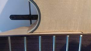

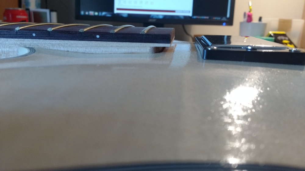

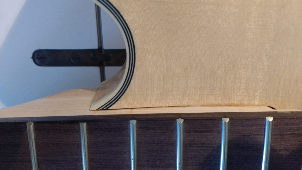

    In my first post, you can see a picture of the gap between the end of the fingerboard and the body, when I tried a mock build.
    I'm pretty sure the problem comes from here : I must lower the neck's base so the fingerboard touches the body.

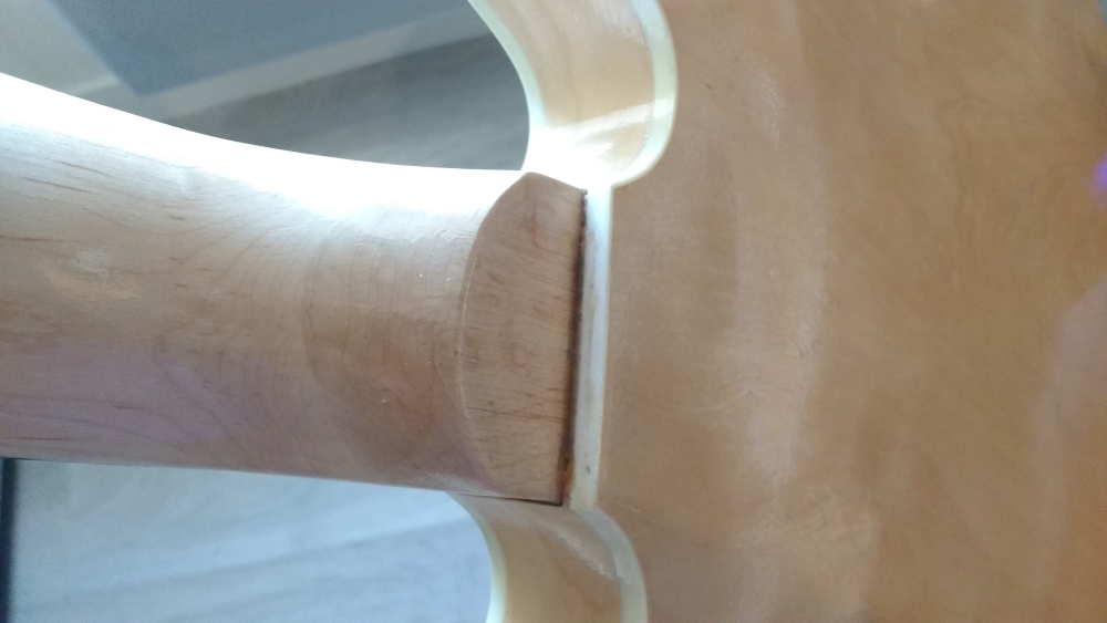

    Here are some picture of my disaster.. by chance the pocket is a little larger (on sides) than the neck, so I'll be able to heat and insert a small piece of metal (this actually), I own one it'll be perfect for this job !
    About heating, I read I can use an hairdryer to do the job without damaging the wood.. not to close of course, and with patience.. any though ?
    Or I'll have to find a steam machine..
    My biggest problem will be under the neck.. I must find a way to soften the glue to insert my flat tool.

    Those gaps on the side of the neck that appear in your photo should not be there. I'll have some advice about that once the neck is out. It makes me think that the neck it might not be set properly...or that it needs a fillet or shim for tighter fit...but one problem at a time ;-)

    I haven't made one of these, and it is a bit hard to tell without actually holding the bass in my hands, but the neck angle doesn't look like it would be wrong. Where are the strings touching the neck, near the nut, in the middle, or at the bridge end?
  10. #30
    Member Roger79's Avatar
    Mar 2018
    France (Niort)
    25
    Hi !
    In fact, the strings are always touching the neck's end, even when I rise the bridge the higher way possible..
    It's like the neck isn't horizontal, or just too high..
    I compared with a ESB4's photo found on Internet, the fingerboard's end seems to touch the body (more than mine anyway) :
    http://2.bp.blogspot.com/-remV4LyVY-...0/IMG_4416.JPG
