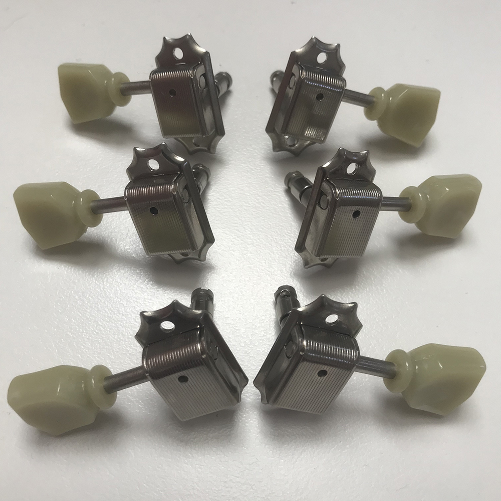

    My Gotoh vintage Keystone (Kluson Style) locking tuners arrived today.
  8. #26
    Mentor Andyxlh's Avatar
    1,206
    I like the tuners, I have a set ready for my sg build...
  9. Liked by: Simon Ashford
  10. #27

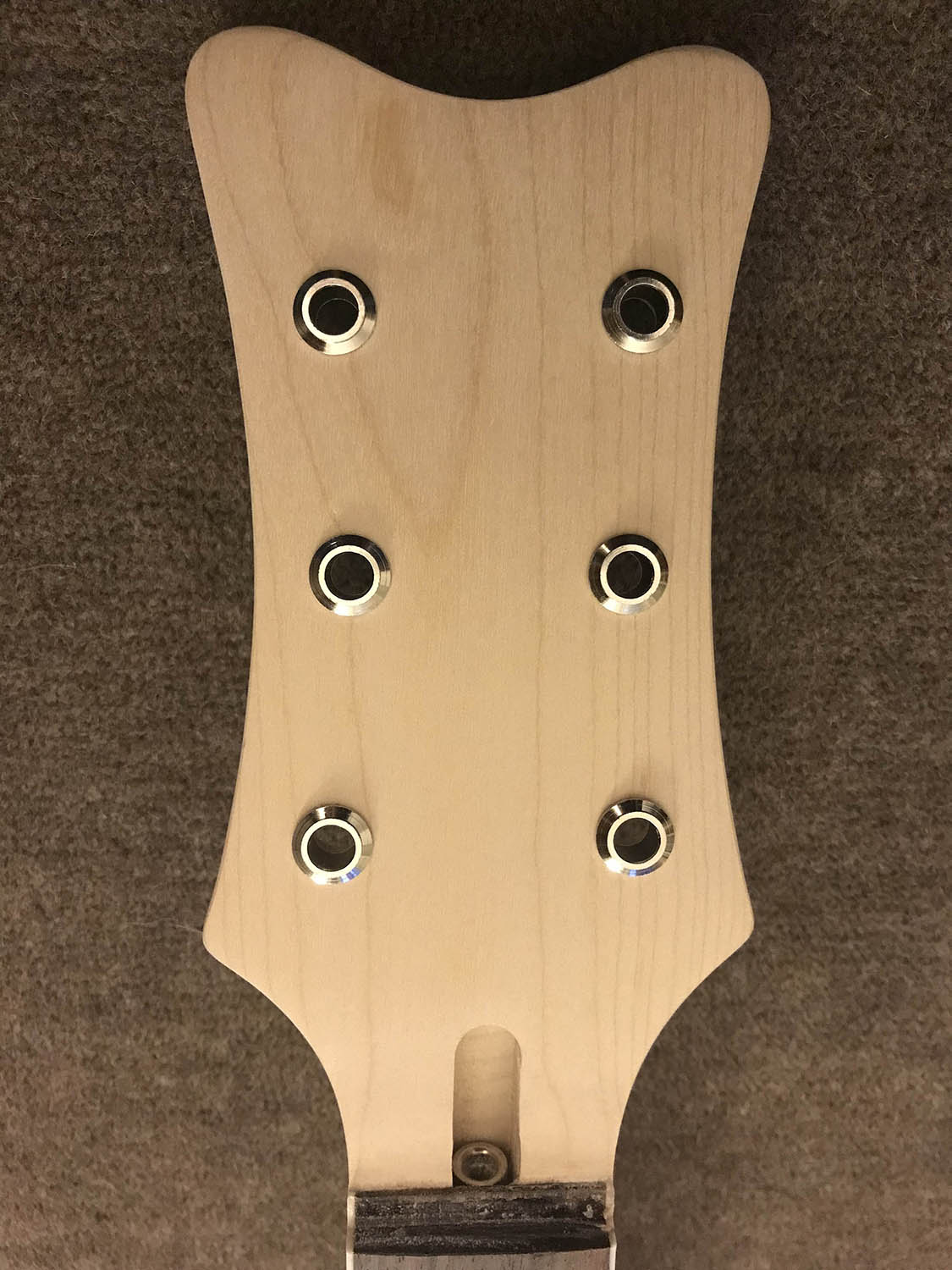

    Member Simon Ashford's Avatar
    Feb 2018
    Melbourne, Australia
    19
    Conversion Bushings
    The new tuners seem to be made for 8.8mm holes. The kit has been drilled with 10mm holes. Has anyone had any experience with using conversion bushings? I have seen a few on line. So it must be a standard modification that is commonly made.
  11. #28
    Yes, they work fine. Just fit them before you screw the tuners in place, so that you know the posts are properly centred.
  12. #29
    Of course the other option is to dowel them up and drill again.
    A practice that I've done a few times with an ever-increasing level of competence.
    cheers, Mark.

  14. #30
    Feb 2018
    19
    The conversion bushes are fantastic.
    The vintage tuners are suited for 8.8mm holes but the pre drilled holes are 10mm.
    These conversion bushes work nicely. Learning so much.
