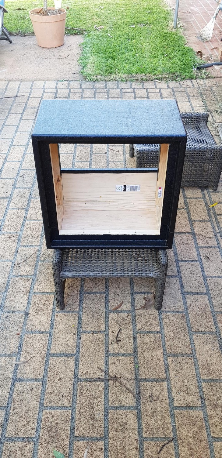

    Time to go buy the speaker. Thinking of a celestion Vintage 30.

    It's pretty hard to find a better general purpose speaker than the Vintage 30. Very popular with the metal music guys too.
    I've built two cabs, one is a 2x12" and the other is a oversize 1x12". Both were made with 19mm formply (the same that concrete'rs use) and came already with a durable Black coating.
    The 2x12" (on the Left) is a vented port design with a V30 and a G12H75 Creamback both 16ohms in parallel to give an 8ohm load to the amp. As the formply came in 600mm x 2400mm sheets that set the depth of the cab to 300mm. The width of the cab was set by the width of my JVM210c combo amp as I originally had intended for it to sit on top of the cab, so the only parameter that the speaker enclosure design software could change was the height of the cab which came out to be about 950mm. Internal screws via glued ribbing allowed a fairly clean outside finish. A dowel frame with some Grey speaker cloth stretched over the front hides the two front loaded 12" speakers. The choice to make it a vented/ported cab was to try and find a mid point between open back and sealed enclosure sounds, and it does this quite well... and having two different 12" speakers loaded sounds awesome and allows for more tonal options when recording.
    The 1x12" (on the right) is the same dimensions as the 2x12 but instead of the port vent has only half the back panel. The old (antique) 4 ohm Washburn 160W speaker has an interesting tonal flavour that doesn't suit all ears, and is much better suited to an open cab than a closed or vented cab. Again a frame was made and Grey speaker grill cloth stretched over it, which clips into place over the front loaded 12" speaker. The clips used are the same as those that hold doors open, or cupboards shut, four of them, one in each corner, the white patch in the top right of the Grey is one I didn't paint Black. Having the larger cabinet volume does increase bass response slightly.
    Both cabs have castors and side handles for easy relocation and handling.
