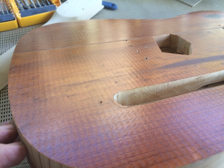

    I thought that I would include a few photos of the “character” I am trying to preserve. It would be much easier to sand it all back to get a good finish and start again, but that’s not the point.
    This shot shows the overall body. You can clearly see the corrugations in the lower horn and the badly glued join.
    This shot again shows the join and a "lateral knot" (is that really a thing?), where the varnish hasn’t taken. It runs the whole length of the body and just pokes through near the control cavity.
    How about that for a crusty old knot!
    More corrugations, it almost gives it a quilted look.

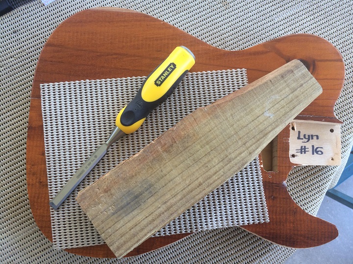

    First job is to score the lines where I intend to chisel out the channel. Time to get out my trusty DIY line marker/scorer.
    It was originally curved to get into those hard to get at parts of a guitar, the waste-line and horns etc, but it was perfect to score a nice deep line in the side of the guitar without marking the top surface. It is possible to score a nice deep line that makes chiselling a lot easier.

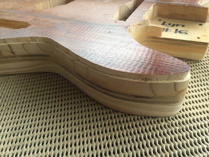

    I then had to carefully mark a line about 1.5mm around the top for my vertical chisel line.
    Then it was out with the chisel and mallet and nibble away the binding channel.
    It’s pretty rough right now, but I will go over it with some sandpaper and smooth out the rough edges.
    I hope to get the binding on tomorrow. I know I have cut the binding rebate too wide in places so I'll have to wait until the binding is in place before I know how much to sand off the sides of the guitar to bring it back to be level with the binding. Oh goodie, more sanding. lol.
