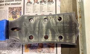

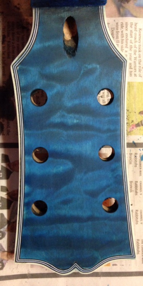

    Today I tried to stain the headstock
    I used a black ink an a blue dye over the top
    The black was a waster soluble artist ink diluted1:5
    The blue is a " ubeaut" water soluble wood dye.
    See pictureClick image for larger version.
    I then sanded down with 400 grit an then applied 2 coats of 1:5 blue
    See pictures

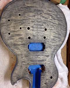

    I have also tried to stain the body with black
    See picture

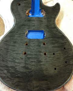

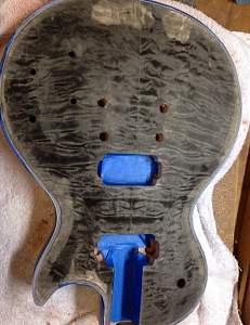

    You can see I had some issues wth glue spots and lines around the edge.
    I used some " goof off" some 0000 steel wool and I tried to take off the glue out of the timber grain.
    This appears to base been reasonably successful see picture with second coat of black
    I will sand back carefully tomorrow with 400 grit and apply 2 coats of blue.

    Yes, headstock looks really nice. It should look even better with a clear coat on it.
  7. #27

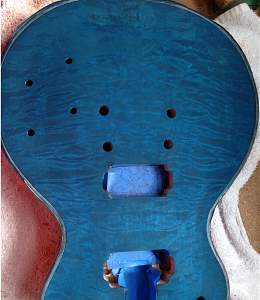

    Yes I had noted that the veneer centre line is about 0.5 - 1 cm off being perfectly centered , but I do have to remind myself that this is a $ 270 kit and not a $ 5000 guitar. It is a good learning experience.
    Today I have sanded back the black stain and have put on 2 coats of the blue dye.
    See pictures below
