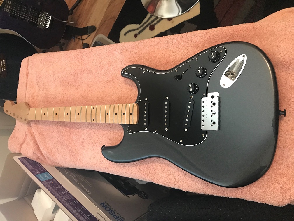

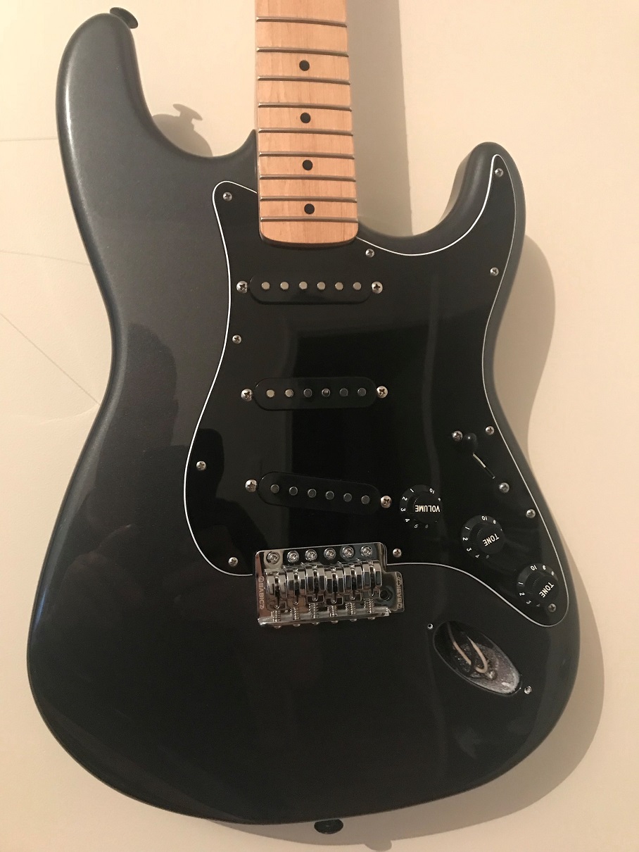

    Anyhoo's I was clearing out a cupboard and I found still boxed a Pitbull ST kit in ash. Temptation got the better of me and well off I started with it.
    - Body was sanded and then sealed with de-waxed shelac.
    - I then filled the grain and lightly 2k primed it (The thinner the primer the better)
    - Following that I sprayed a metallic Gun grey base coat(Honda CBR colour)
    - I then clear coated it with a 2k clear coat followed by UV curing. I still have to polish it as the finish is straight out of the gun.

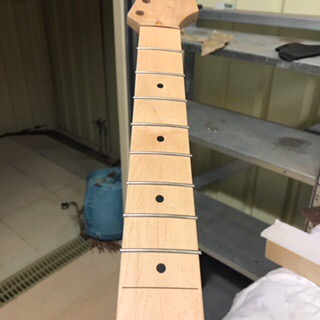

    - The neck, well being as it's not a JMC guitar got a traditional Strat shape.
    - I pulled all the frets out and changed the fret board radius to a 10" (suits me better than the supplied 12")
    - Frets will be replaced with high quality ST/ST jumbo frets.
    - the nut replaced with a bone nut that I have yet to shape and cut.
    - I changed the neck shape a little to fit my comfort ( more like my USA 60th anniversary strat )
    - Neck will be finished in Matt Nitro and left the traditional Maple colour.
    - Hardware ordered is the Babicz Bridge in chrome.
    - Tone rider classic blues pick ups ( cause I just love them)
    - Gotoh machine heads.
    - A full custom USA pot and switch set up.
    - Black Scratch plate.
