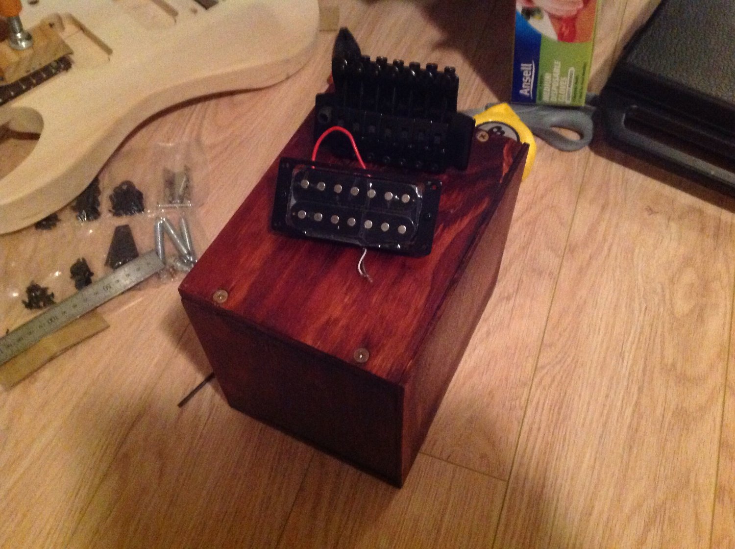

    Sweet, thanks for the advice Simon. I'll get myself some painters tape. And probably put lemon oil on the neck. At the moment, it seems to pick up fingermarks, so I want something on there to protect it!
    Aha, thanks for the advice on the different wood types. I will keep your words in mind. Tbh, I haven't decided on how the guitar is gonna be finished. My current thoughts are either white body (Ibanex RG Style) or a deep red stain (no guitar pic, but below is the kinda colour I'm thinking - a box I made in woodwork classes lol). At the moment, the grain on the body doesn't look particularly interesting so I'm a bit hesitant about using a stain, but I'll see what it looks like after some sanding.

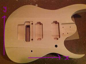

    I just realised... I don't know which way to sand some parts of the body!
    In context of the pic below, I've been sanding the face parallel to the x direction, and also sanding the top and bottom in the x direction. What direction do I sand the inside of the cutouts though? And also the leftmost side of the body? z direction (out of the page)? I can't figure out what "in the direction of the grain" means for those two bits. Thanks!

  8. #28
    Yes, on the top and bottom faces, the grain is running in the x-direction. On the long edges, the grain should also be in the x-direction, but when you get to the bottom (where you've put the y-axis line) and the opposite end., the grain could be running anywhere, so you just need to follow the lines you see.
    Within the cavities, it's normally a question of just using whatever direction works best (though try to keep with the grain in the neck pocket). You'll hardly be able to see in them, so achieving a perfectly smooth finish in them is only really for those with bad OCD. Most commercial guitars have pretty badly finished cavities as getting them smooth tales time, and time is money in guitar production. Which doesn't mean that you can't get them smooth if you really want to take the time. You might want to spend a bit more time smoothing the areas of the trem cavity that will be on show, but even still, it's not worth going overboard.
  9. #29
    Unfortunately all my guitars have seem to have at least one piece of the slab where the end grain was at 90 degrees to the others. Start by sanding either Y or Z (to use your terminology), if the machine marks don't start sanding out flip to the other. If the machining marks start vanishing you are going in the right direction. You may have to sand each end grain separately to get a good result.
