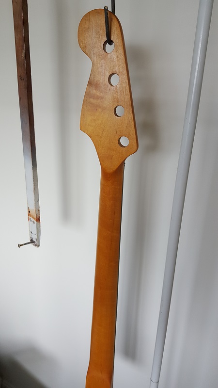

    The build begins again....again.
    Waz...I got it all off...and did the process again 80 girt, 120 grit, pore filler, 180 grit....on the neck 3 x damp and sand at 240...not so on the body.
    Well still wet...but here are some piccies of the neck and body after stain applied and finish coat x 1 has been applied.
    Neck...Vintage Amber colortone dye. One soak coat of Tru Oil applied.
    Body...Cedar U Beat stain. One coat of Feast Watson Fine Buffing Oil applied with 0000 steel wool.
    Love the neck...the body is okay...see how we go with more coats.
    First ASH body....love the grain.
